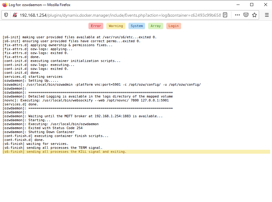

November 25, 20206 yr Hi, I restarted my server yesterday and ozwdaemon has since refused to start up. It is giving me the following error log (attached). I couldn't find anything when try to google the status code 254. So far I have tried restart the MQTT/ozwdaemon docker and re-enter the username/password, but nothing worked.
November 25, 20206 yr Author @jfoxwu These two issues are similar to what your logs look like: #165 and #163. Can you confirm that the IP address you are using for MQTT (192.168.1.254) is actually an MQTT server and is reachable? Also, are there any further details in files located in the folder you have mapped to Config? (default folder is at /mnt/user/appdata/ozw/logs) Edited November 25, 20206 yr by FoxxMD

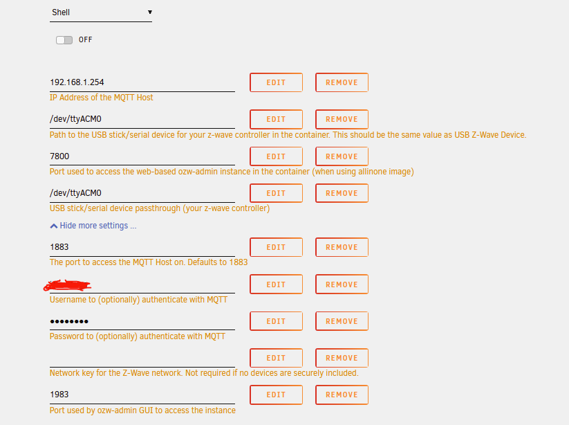

November 25, 20206 yr @FoxxMD, thank you for the reply. I have double checked the IP address, and it is correct. How do I check if the MQTT server is reachable or not? I don't see ozw folder in my appdata share. The docker's configuration is shown in the attached picture. I don't find any filed to map the Config folder like other dockers I had. Is this something I need to add manually? Or am I looking at the wrong place? Edited November 25, 20206 yr by jfoxwu

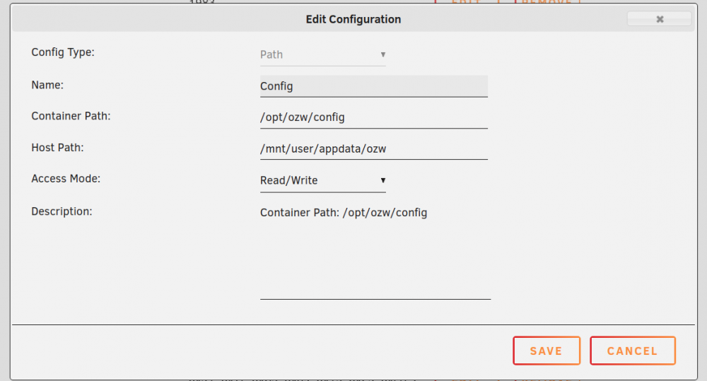

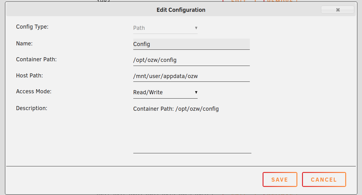

November 25, 20206 yr Author @jfoxwu you can test if MQTT is reachable by using the MQTT integration in your Home Assistant instance (listen to '#') or by using one of the commandline tools show in the docs (if you install them on your machine) for the config volume...oops! Somehow that went overlooked in my CA template for this. I have updated the template...you can wait for CA to update the template and then use the new one or go ahead and create it yourself. it should look like this: Container Path: /opt/ozw/config Host Path: /mnt/user/appdata/ozw I also misspoke in my last post -- you'll want to look in /mnt/user/appdata/ozw/logs for more detailed information.
November 26, 20205 yr @FoxxMD, thank you for the assistance. It is working now. Upon inspecting the log, it seems like the problem was not being able to connect to MQTT due to incorrect username/password. I re-entered the username/password in the MQTT/ozwdaemon dockers several times but that did not fix the problem. I ended up having to delete everything inside "passwords.mqtt" file and start fresh.

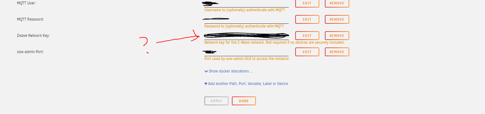

January 5, 20215 yr Can someone provide a template for what the Network Key setting should look like when spinning up the container? Specifically the item indicated in red in the screenshot. Should the format be 0x00,0x00,0x00... OR 0x00, 0x00, 0x00... ? Edited January 12, 20215 yr by Rick_Sanchez Clarification
