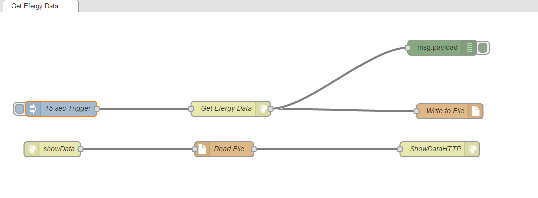

This is great.
It took me about 15min to install and connect to a "hidden" API on Efergy to read my real time energy consumption and write it to a file.
Just for fun I attached a web-service to dump the file back to a website.
I followed the video on the first post and this little blog:
http://blog.krisdaniels.be/efergy-engage-api/
Next challenge to store the data in a MariaDB.
Glad its working!. I did a similar thing with my Tado heating system.
