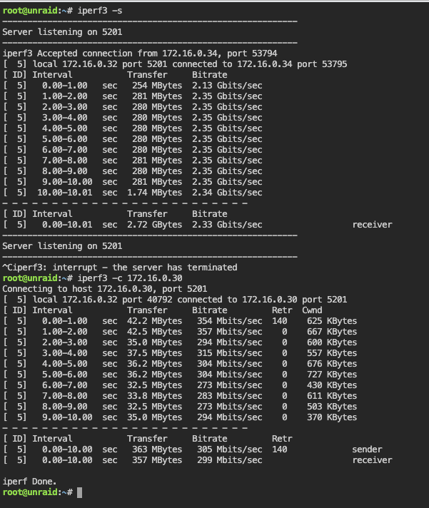

April 15, 20215 yr On 4/10/2021 at 3:55 AM, JorgeB said: Start by running a single stream iperf test. I did, I should say this, So my server has a 10gb nic connected to a 10gbe switch which my mac is currently connected to. Now, the mac is on a 2.5gb nic ( it will soon be upgraded to a 10bge nic )(waiting on parts to arrive) running iperf from the mac to the server is 2.65gbs (which I can live with) translating this to aja or blackmagic speed test to 120-140MB write (which im ok with for now) running iperf from the server to the mac the speed is 232 mbs which translate to 20MB read from the server which I dont get why I already set mtu to 9000 and nothing, ive tried about all the smb tweaks I can think of (except for link aggregation) Edited April 15, 20215 yr by Ralph456
April 15, 20215 yr Community Expert 4 hours ago, Ralph456 said: running iperf from the server to the mac the speed is 232 mbs which translate to 20MB read from the server which I dont get why It confirms it's a network related issue.
