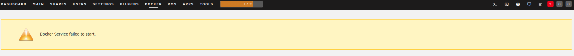

My cache drive became full due to an unexpected set of data baing added to cache only. I only nocied when some of my docker apps started misbehaving. I turned off docker (in settings) to prevent further damage and ran the mover to get the cache back to normal. When turning on docker again, I saw that "Docker Service failed to start.". I know that I can delete the docker image, but IIRC, last time I deleted the image, I had to setup each app all over again. Since then, I have a lot more apps. Is there a way to backup each of the apps configs (all of the settings) before deleting the image, so I can add them easily after deleting the image?
Since the docker image is not starting, I can't go through each of then like I would normaly to take screenshots of the settings.
Your help will be much apprciated. I really hope that I don't need to figure out the configs for each app all over again...

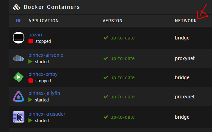

The network used by a docker is shown on the docker page :
Hey, sorry, I am unable to see any of my docker images due to Docker Service failing to start...
Is there any other way?
