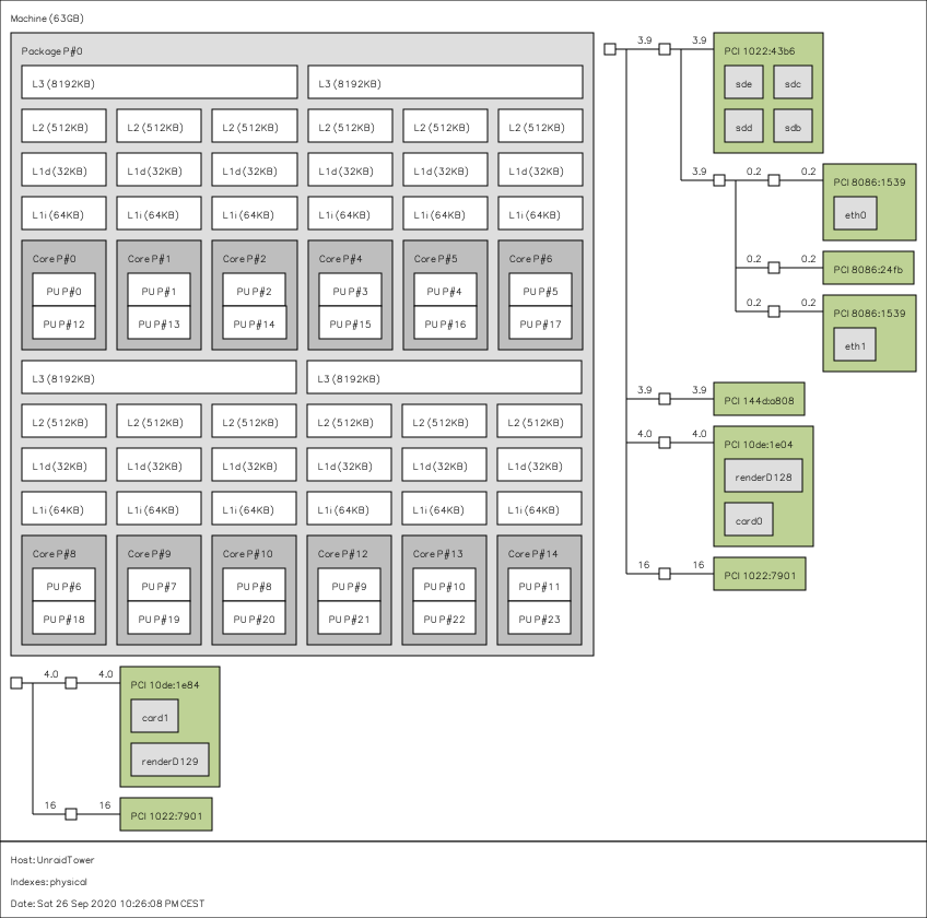

That is interesting. I followed the instructions in this video and got the image you can see at the bottom. Since there is only a single package I assumed that there is only a single die. Looking at the topology again I assume there are 3 cores per CCX sharing a single L3 cache. Is that correct?
Just out of curiosity. Could you explain the difference between a CCX and a package?
For the 19xx Threadripper
The CCX is the core building block, each of these has 4 CPU cores which share a block level 3 cache. (3cores on the 1920X as one is disabled)
Two CCX form a die which also contains a dual channel memory controller and PCI-E interface etc.
Two dies are mounted in the package, the physical chip you installed (there are actually 4 physical dies, however 2 of these are dummys)
Each CCX comminicates with the other CCX's via infinity fabric, a high speed bus regardless of whether it is on the same die or a different die.
This can cause latency when threads hop between cores accross the CCX's or data is in the cache on the wrong CCX. Additional latency comes when the CCX needs to access memory or devices on a different die which is what the video trys to avoid.
Your image doesn't show the NUMA nodes as you have memory interleaving enabled (UMA) which increases the memory bandwidth at the expense of latency and hides the NUMA nodes from the OS. If you set memory interleaving to 'channel' in the BIOS and have the dimms in the correct configuration it should then switch to numa mode.
There is no 'fix' for this, the latency is designed into the chip, which is optimised for production rather than gaming.
However if you get the numa nodes correct you should see performance similar to a Ryzen 2600 with 6 cores allocated.
