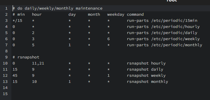

May 16, 20251 yr Hello! I am running into a few confusing things. a) does it matter that the default backup periods in the rsnapshot.conf file are labeled as "alpha," "beta," etc., and the periods in the crontab file are labeled as "hourly," "daily," "weekly," etc? b) when I open the rsnapshot console and type in "crontab -e" the crontab file I end up making changes to is different from the crontab file found in /config/crontabs/root. Is this a problem? c) finally - my cron jobs aren't running! for safety's sake I went ahead and named my "backup periods" in rsnapshot.conf as follows: ######################################### # BACKUP LEVELS / INTERVALS # # Must be unique and in ascending order # # e.g. alpha, beta, gamma, etc. # ######################################### retain daily 6 retain weekly 7 retain monthly 4 #retain yearly 3 and wrote out both crontabs as follows: crontab found by "crontab -e" # do daily/weekly/monthly maintenance # min hour day month weekday command 0 2 * * * run-parts /etc/periodic/daily 0 3 * * 6 run-parts /etc/periodic/weekly 0 5 1 * * run-parts /etc/periodic/monthly 0 2 1 1 * run-parts /etc/periodic/yearly /config/crontabs/root # do daily/weekly/monthly maintenance # min hour day month weekday command 0 2 * * * run-parts /etc/periodic/daily 0 3 * * 6 run-parts /etc/periodic/weekly 0 5 1 * * run-parts /etc/periodic/monthly 0 4 1 1 * run-parts /etc/periodic/yearly rsnapshot configtest results in "Syntax OK". rsnapshot -t daily gives me echo 506 > /config/rsnapshot.pid mkdir -m 0755 -p /.snapshots/daily.0/ /usr/bin/rsync -a --delete --numeric-ids --relative --delete-excluded \ /data/ /.snapshots/daily.0/localhost/ which is what it should be. But the first backup just hasn't run yet. Do I need to do anything additional to start cron?
May 16, 20251 yr 1 hour ago, queasy-clinic6339 said: the periods in the crontab file are labeled as "hourly," "daily," "weekly," etc? Those are for the underlying system, you have to add some for your rsnapshot tasks yourself according to how you've named things in the config Edited May 16, 20251 yr by Kilrah
May 16, 20251 yr Ahahaha oh wow thank you so much! I always feel like I'm missing understanding of one crucial thing - I should have looked at the example crontab first!

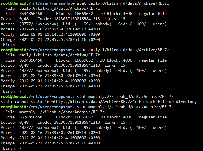

May 21, 20251 yr And more questions!My understanding is that rsnapshot uses rsync to duplicate hard links to original files, so multiple backups shouldn't use any more space if nothing has changed, and the backup process shouldn't take very long unless the source has changed a lot. However, it seems like my backups are completely recopying the data over every time. If I use rsnapshot-diff between two snapshots I get this:Comparing daily.2 to daily.1Between daily.2 and daily.1: 378107 were added, taking 733558615852 bytes 378063 were removed, saving 733307783158 bytesWhich seems to me to say that it's adding EVERYTHING and removing EVERYTHING every time. If I look for a specific file in the snapshot-diff -v, I see this:+ daily.1/localhost/data/audiobooks/eyeofnight_audio/02- Product/Mp3s/Eye of Night - Part 1.mp3+ daily.1/localhost/data/audiobooks/eyeofnight_audio/02- Product/Mp3s/Eye of Night - Part 3.mp3+ daily.1/localhost/data/audiobooks/eyeofnight_audio/02- Product/Mp3s/Eye of Night - Part 2..mp3- daily.2/localhost/data/audiobooks/eyeofnight_audio/02- Product/Mp3s/Eye of Night - Part 1.mp3- daily.2/localhost/data/audiobooks/eyeofnight_audio/02- Product/Mp3s/Eye of Night - Part 3.mp3- daily.2/localhost/data/audiobooks/eyeofnight_audio/02- Product/Mp3s/Eye of Night - Part 2..mp3and if I look at the individual files I see this:daily.1File: Eye of Night - Part 1.mp3Size: 45457491 Blocks: 88832 IO Block: 4096 regular fileDevice: 8,1 Inode: 8269311 Links: 1Access: (0777/-rwxrwxrwx) Uid: ( 0/ root) Gid: ( 0/ root)Access: 2025-05-20 11:35:38.000000000 -0400Modify: 2022-08-08 08:09:48.000000000 -0400Change: 2022-08-08 08:09:48.000000000 -0400Birth: -daily.2File: Eye of Night - Part 1.mp3Size: 45457491 Blocks: 88832 IO Block: 4096 regular fileDevice: 8,1 Inode: 8269310 Links: 1Access: (0777/-rwxrwxrwx) Uid: ( 0/ root) Gid: ( 0/ root)Access: 2025-05-20 11:35:41.000000000 -0400Modify: 2022-08-08 08:09:48.000000000 -0400Change: 2022-08-08 08:09:48.000000000 -0400Birth: -which, again, I THINK indicates that it's copying new ones based on the inode number. Is there an obvious reason why this might be happening?Please find my rsnapshot.conf file attached, and, again, thank you for bearing with a not very technically minded person rsnapshot.conf
May 21, 20251 yr What are the source of the data and the destination? Maybe something causes the times or such to not be consistent between runs, or the destination filesystem doesn't support hardlinks. It should be hardlinked indeedYour conf has spaces instead of tabs as required by rsnapshot but it'd tell you the config is invalid so it might be an artifact of how the file was posted.Mine has "cmd_rsnapshot_diff /usr/bin/rsnapshot-diff" uncommented and rsync_short_args commented, that could be the issue too? Edited May 21, 20251 yr by Kilrah
May 22, 20251 yr 16 hours ago, Kilrah said:What are the source of the data and the destination? Maybe something causes the times or such to not be consistent between runs, or the destination filesystem doesn't support hardlinks. It should be hardlinked indeedOkay, I think THAT'S it. The drive I'm copying everything to is exfat!!! Basically, my big concern is that one day I'm going to die unexpectedly and my wife is going to walk into my office, look at the NAS that has every picture of our family on it and not have any idea how to get any of it off of there - so my hope was to have a drive that she could unplug and plug into a Mac and view the files on it. But it seems like the best bet for me is to reformat the drive to NTFS and I guess leave a note on the drive telling her to install Paragon!!
May 22, 20251 yr You can do a simple rsync then, just won't have the history.NTFS wouldn't work with hardlinks either AFAIK, would need a "linux-y" filesystem.
