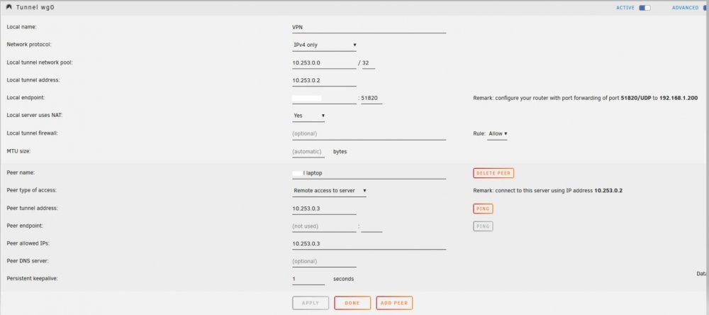

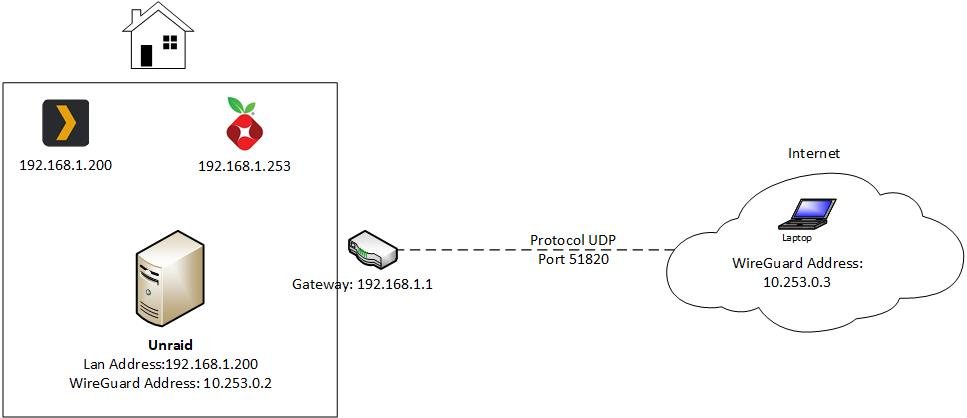

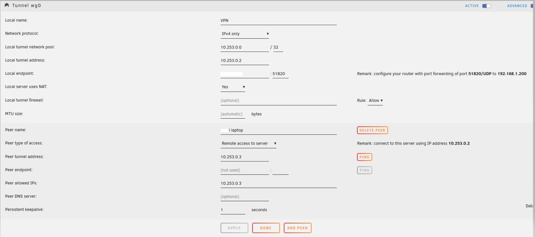

I am trying to configure a simple setup with WireGuard installed on the Unraid server and the WireGuard clients connected from the wild internet.

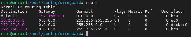

I manage to do the portforward correctly because I able to connect from the internet to the WireGuard server, but I think I need to add some routes or something else because after I connect I can't access the local network. To have a clear idea of what I did, I will insert some picture with my setup:
WireGuard setup:
Unraid routes:
After I connect from my laptop (10.253.0.3) I am able to ping the server 10.253.0.2 but unable to access my network lan 192.168.1.0
Somewhere I miss something. Can you help me to find out where?
You have specifically chosen the option to only access the server in the Peer type.   You need to use Remote Access to LAN if you want to access more than the server.
I changed to "Remote Access to LAN"  but is the same. Also from the client I can ping the server but from the server I can not ping the client
