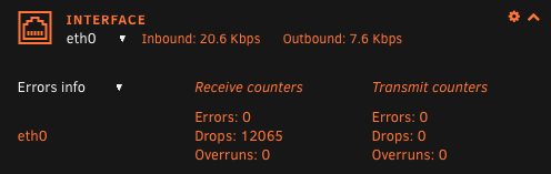

At the same time you can see in the unraid dashboard that there are drops on the recipient side:
I tried allready different cables an switch-ports. Both interfaces (unraid and PC) are working with an MTU of 1500.
Unraid is on version 6.9.0-beta30.
I don't know where the drops came from. 😞

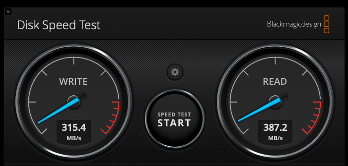

I also enabled disk-shares and tested the cache-pool directly:
5GB-File:
That seems to be the perfomance of a single SATA-SSD even though the cache-pool is set to raid0:
At least the reading speed should be much higher, right?
