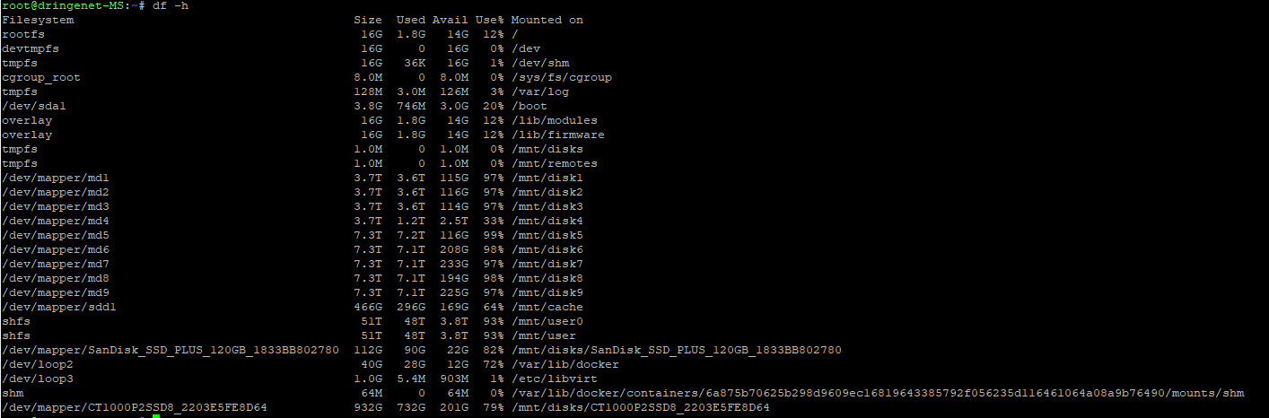

I've rebooted the server before I read your comment...I've taken diagnostics and df -h shows no particular partition filling up over the course of the last 10 minutes.1766586020_2022-02-2614_38_29-SuperPuTTY-dringenet-MS.thumb.png.959690775489cf3f4168a44b10962cac.png
The diagnostics are after the fresh reboot. I don't know if they help. And it seems like the only full drives are the data drives inside the pool, so no problem there?

What I was specifically after was rootfs, the very first thing in the list from that command. Those results are also in diagnostics, but since you couldn't get them I asked for the results of the command.
Since you rebooted before getting the command results, we don't know what the results of that command would be if you did it while you were having the problem.

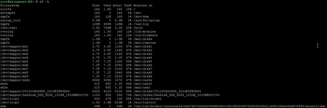

fortunately, the error occured again yesterday, some time after the reboot. There does not seem to be smth. wrong.
