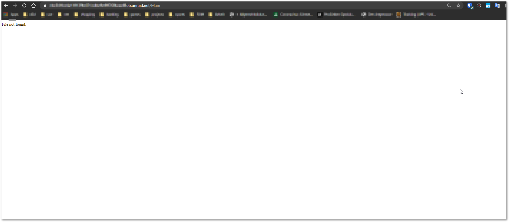

All dockers are available and I am able to login to the server via SSH. I can't access the GUI and get:
Even when I try to enter just the ip after https://...

Ok, everytime I try to load the GUI in any browser the following error occures in the syslog:
Feb 25 10:39:04 dringenet-MS nginx: 2022/02/25 10:39:04 [error] 23909#23909: *118637 FastCGI sent in stderr: "Primary script unknown" while reading response header from upstream, client: 192.168.1.195, server: , request: "GET /Main HTTP/2.0", upstream: "fastcgi://unix:/var/run/php5-fpm.sock:", host: "cbc341bc4a11f139b471cdbe9e9ff76f4eeef8eb.unraid.net"
Feb 25 10:39:05 dringenet-MS nginx: 2022/02/25 10:39:05 [error] 23909#23909: *118637 FastCGI sent in stderr: "Primary script unknown" while reading response header from upstream, client: 192.168.1.195, server: , request: "GET /Main HTTP/2.0", upstream: "fastcgi://unix:/var/run/php5-fpm.sock:", host: "cbc341bc4a11f139b471cdbe9e9ff76f4eeef8eb.unraid.net"
Feb 25 10:39:06 dringenet-MS nginx: 2022/02/25 10:39:06 [error] 23909#23909: *118637 FastCGI sent in stderr: "Primary script unknown" while reading response header from upstream, client: 192.168.1.195, server: , request: "GET /Main HTTP/2.0", upstream: "fastcgi://unix:/var/run/php5-fpm.sock:", host: "cbc341bc4a11f139b471cdbe9e9ff76f4eeef8eb.unraid.net"
Feb 25 10:39:07 dringenet-MS nginx: 2022/02/25 10:39:07 [error] 23909#23909: *118637 FastCGI sent in stderr: "Primary script unknown" while reading response header from upstream, client: 192.168.1.195, server: , request: "GET /Main HTTP/2.0", upstream: "fastcgi://unix:/var/run/php5-fpm.sock:", host: "cbc341bc4a11f139b471cdbe9e9ff76f4eeef8eb.unraid.net"
Feb 25 10:39:08 dringenet-MS nginx: 2022/02/25 10:39:08 [error] 23909#23909: *118637 FastCGI sent in stderr: "Primary script unknown" while reading response header from upstream, client: 192.168.1.195, server: , request: "GET /Main HTTP/2.0", upstream: "fastcgi://unix:/var/run/php5-fpm.sock:", host: "cbc341bc4a11f139b471cdbe9e9ff76f4eeef8eb.unraid.net"
Does anybody got a clue?
