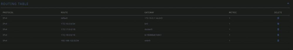

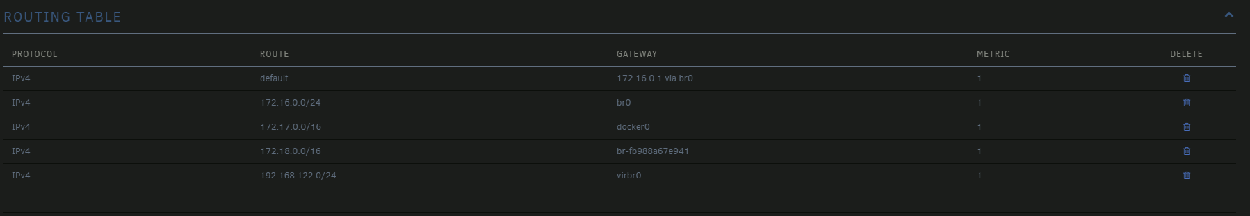

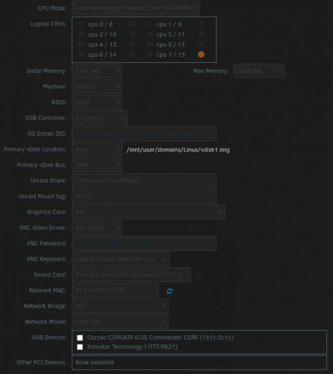

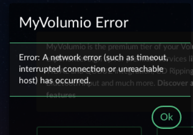

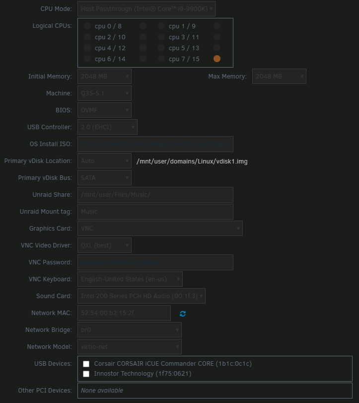

November 13, 20206 yr Hello there. I followed SpaceInvader One's video: It seemed to be successful and I was able to get the VM going but I can't get passed the initial setup within Volumio. It does not see the network. Here's my routing table: Here's my Voumio settings: Here's the error I get at signup: Any input would be greatly appreciated. Thanks! Edited November 14, 20206 yr by Keek Uras Added error screenshot for clariy

November 16, 20206 yr I'm not quite shure, but SpaceInvader One is using Unraid 6.9 Beta, which has Q35-5.0 implemented. Maybe that's a reason why volumio doesn't see the br0. I'm having the same issue. Edit: Go to Vour VM XML File and change the type of the br0 from virtio to vmxnet3. That worked for me. Edited November 16, 20206 yr by BeatJ_Arke Found Solution
November 16, 20206 yr Author 8 hours ago, BeatJ_Arke said: I'm not quite shure, but SpaceInvader One is using Unraid 6.9 Beta, which has Q35-5.0 implemented. Maybe that's a reason why volumio doesn't see the br0. I'm having the same issue. Edit: Go to Vour VM XML File and change the type of the br0 from virtio to vmxnet3. That worked for me. Thank you for your response. I'm using the beta as well. Can you share the section you edited? I've tried changing what I think you're referencing but starting the VM changes it back to virtio. Thanks!

January 19, 20215 yr On 12/14/2020 at 12:50 AM, Keek Uras said: That's good to hear and thanks for sharing. Unfortunately for me, it did not resolve my issue. I have the same issue. I follow the recommendation above and change to vmxnet3. It is working for me now. <interface type='bridge'> <mac address='aa:bb:cc:dd:ee:ff'/> <source bridge='br0'/> <model type='vmxnet3'/> <address type='pci' domain='0x0000' bus='0x01' slot='0x00' function='0x0'/> </interface>

March 19, 20224 yr Author Better late than never but changing to this model type fixed it for me: <interface type='bridge'> <model type='e1000-82545em'/> </interface> Hope it helps someone K
