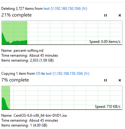

Hello,
Downloaded a trial copy of unraid but initial write speed test tappers to 0 B/s after 5 ~ 10 seconds.
I've only have 2 500GB disks in the array w/o parity disk configured.
Could we check if my configs are optimal and why the transfers rate becoms so slow.

You're deleting 3,727 items at the same time as you're transferring.  File system overhead is accounting for all of that as it sorts itself all out. (And while you don't have a parity drive, the "test" share only exists right now on disk1, so the heads are probably thrashing rather extensively)
Thats a fair assessment. Did another test copying a single 4gb iso file, still getting similar SMB share transfer results. FTP also the same.  Diagnostic file attached.
This shouldn't be a hardware or network related issue as I test with a linux install on the same h/w setup as I did for unraid and NFS or SMB transfer speeds ingress or egress are at 100MB/s+.
Perhaps bios or sata settings specific to UNRAID i need to consider?

slow file transfer was root caused to nic driver for large file transfer offload.  Thanks everyone for their input!
