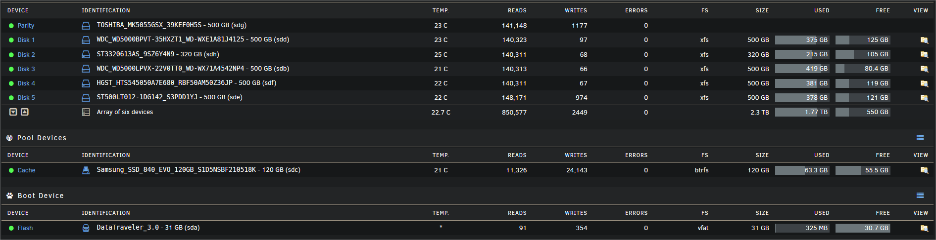

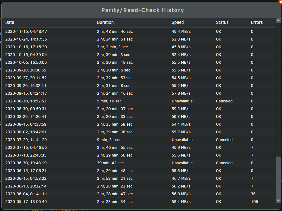

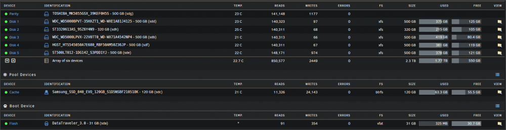

I am now doing a Parity check looking for errors, but this is the record since the server started in april:
And this is the list the disks attached to the server:
