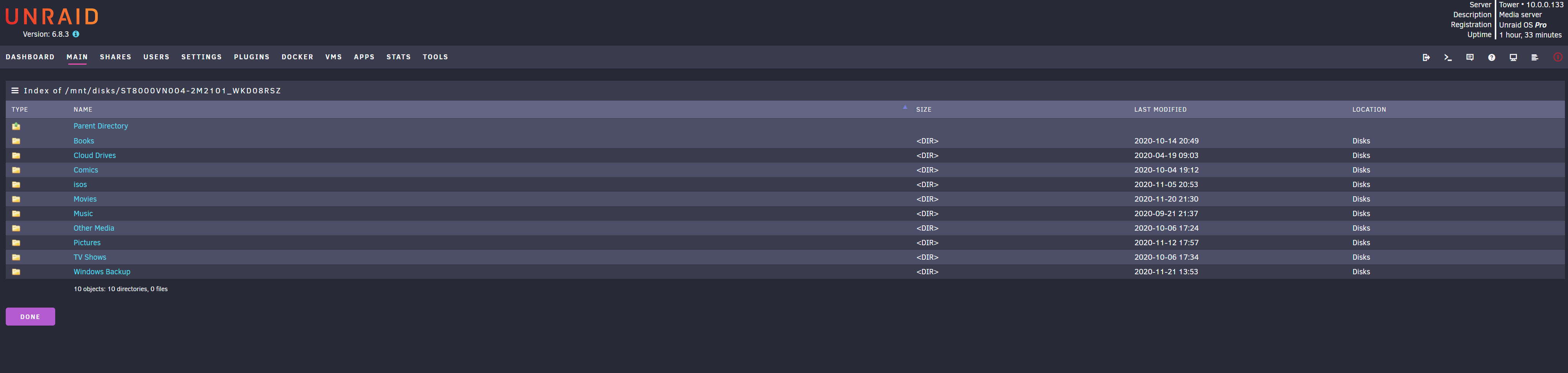

Thanks! Did that and it looks good after un-assigning from array and mounting in UD.

The content looks okay as well, screenshot below. I have no ways of verifying whether this is what was in Disk 15 before the FS corruption, but it looks good to me from a cursory look. Diagnostics attached as well
What should I do next?

Now do a new config, keep all assignments as they were and re-sync parity.
Oh I see now. Never used this New Config option before and I don't think it was even there when I built the server in 2011.  Here is what I did.
  1. Stop the array.
  2. So Tools -->New Config -->Keep All Assignments -->Apply : This is done.
  3. Added Disk 15 back to the array and used the same disk as before.
  4. Started the array.
Everything looks good as of now. Parity rebuild is in process. Will report back how it goes. Thanks a ton for your help.
