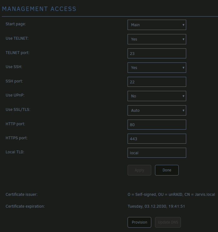

Hmm... it isn't exactly clear what state the system is in now.  It may just be that you need to setup SSL on the new system.
  • Go to Settings -> Management Access.
  • If you have an Update DNS button, press that. It may take a few minutes for the DNS change to propagate.
  • If you have a Provision or Renew button, press that.
  • If you get a DNS rebinding error, wait a few minutes and try again.
If none of this helps, please post a screenshot of the Management Access page along with your diagnostics (from Tools -> Diagnostics)

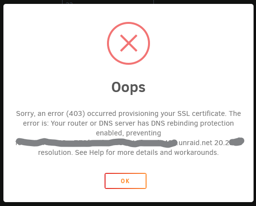

As you can see from my screenshots, Update DNS is grayed out and by clicking the Provision Button i get the error from the second screenshot. Diagnostics is attached.

OK your hash.unraid.net url still resolves to the original IP for me as well. It is possible that the solution only works with non-routable IPs, I'll see what I can find out.
Along those lines... unless you actually own that 20.2.x.x IP range, I highly recommend you use one of the non-routable networks specified here:
  https://en.wikipedia.org/wiki/Private_network
If you don't own 20.2.x.x, then somebody else does and it will cause networking issues down the road if you use it.  Your original 192.168.x.x address is an example of a valid IP range for internal networks.
Since you mentioned a Fritz Box, take a look at this for disabling rebinding protection: https://en.avm.de/service/fritzbox/fritzbox-7590/knowledge-base/publication/show/3565_FRITZ-Box-reports-Your-FRITZ-Box-s-DNS-rebind-protection-rejected-your-query-for-reasons-of-security/
This isn't exactly the problem you are up against at the moment, but it may come up

i changed my ip range now to 10.2.x.x so that it should not be a problem any more. After that i tried the Provision again but same error.
i also checked the avm link you sent and added the unraid.net and the complete hash.unraid.net to the "Host name exceptions:", then reboot the Fritz Box and again tried the Provision but no change, same error
