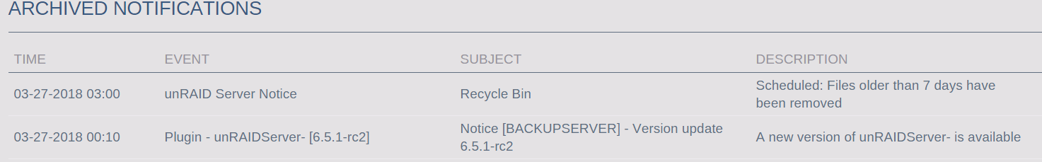

    I've reopened this as I have another server that is running 6.5.0 and I got an update notice:
    This is the OS setting:

    Did you notice that the notification shows the installed version as 6.5.1-rc2 and the new version as 6.5.1-rc2?  How can this situation call for an update?  How can the installed version show as 6.5.1-rc2 when 6.5.0 is installed?  Is this because the /tmp/plugins/unRAIDServer.plg is 6.5.1-rc2?
