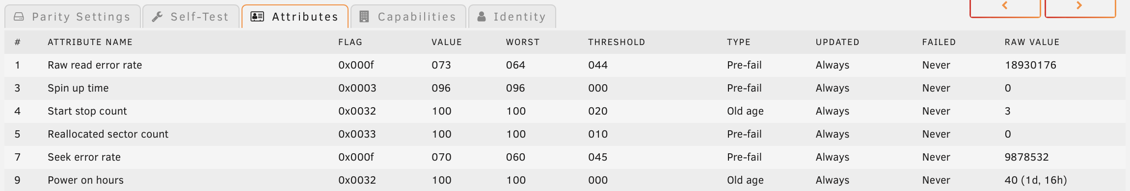

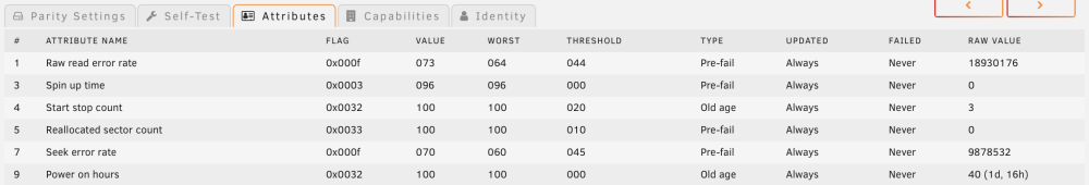

  14. MDD, but the model number is a Seagate, so yes. Thank you.
