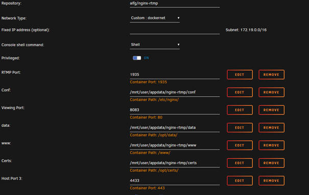

  10. Hey there i'm glad you like this Tutorial. Yeah the Problem is indeed the config file. Just right after my Guide a update appeared. You have to change your config file name to "nginx.conf.template". Be sure there is no other config in the folder and then start your container. Now it should run and you have two conf files in your Directorie. If you want to do any changes in the config file, you have to do the changes in the nginx.conf.template and delete the "old" nginx.conf.

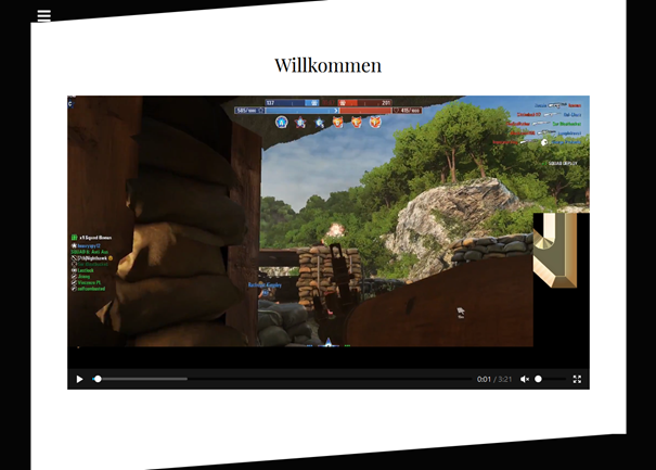

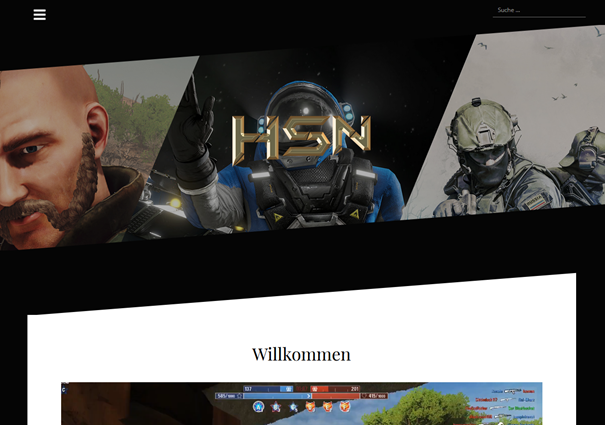

  11. Here are some impressions from my StreamingPlattform: Welcome Page with Autoplay Intro Video A Streamingwebsite with Menu
  12. ****Guide******How to make your own Streamingplattform like Twitch and Co. See Updated New/Infos at the Ende! Project-Prolog: My Goal in this Project was to make a solid Streaming Server with a Website (in some kind of Twitch and Co.) that can only be accessed by my Friends and me and can handle up to 4 or more streams at once. So you may think thats absolut unnecessary and you are right but let‘s getting started anyway 🙂🤪 What the Heck do i need for this? 1. A good Server/Pc (in may case a Dell Poweredge R610 with Dual Xeon X5675@3GHZ and 40GB of RAM) 2. A solid Internetconnection 3. Of Course a Running Unraid OS 4. Two subdomains of your choice one for your website and the other for your streaming server (i used no-ip.com) 5. A Reverse Proxy with Let’s Encrypt ; SpaceinvaderOne has a Great Video Guide 6. Some Dockercontainers: MariaDB, Wordpress, nginx-rtmp by alfg (https://hub.docker.com/r/alfg/nginx-rtmp/) 7. Some Friends to Test 8. A lots of nerves and Time 9. Friends or yourself for some Desgin stuff for your cool website logo and images 10. Your choice of Drug to keep you calm like Coffee, Beer, Pizza etc. The First steps on Wordpress: First of all install MariaDB and make a Database for Wordpress ( i recommend to watch the Video Guide from SpaceInvaderOne How Setup up Nextcloud After you setup MariaDB proberly install Wordpress and Setup your admin account etc.. [I First started to build the website with serveral Wordpress-Plugins on my local network. But i recommend to go first with the setup of your Domain for your website via Letsencrypt] Then make your „Resverse Proxy Dockernet“ in Unraid and install Letsencrypt like seen in the Video Guide from SpaceinvaderOne. Enter your Domains in Letsencrypt Move to Wordpress --> Settings--> Generally and change the Wordpress-Adress and the Website-Adress to your domains name like: https://example.yourdomain.com (Dont worry if you cant access your Website after Save the changes and refresh; you can change this in the WP Config to your localhost/network back if something goes wrong) Move to the Letsencrypt Appdata Folder -->nginx-->proxy-confs (Here we have to setup a new config because at the time of writting this guide there was no Wordpress proxy-confs) Make a new text file and enter following: server { listen 443 ssl; listen [::]:443 ssl; server_name yoursubdomain.*; #change this to your subdomain include /config/nginx/ssl.conf; client_max_body_size 0; location / { include /config/nginx/proxy.conf; resolver 127.0.0.11 valid=30s; set $upstream_app Wordpress; set $upstream_port 80; set $upstream_proto http; proxy_pass $upstream_proto://$upstream_app:$upstream_port; proxy_max_temp_file_size 2048m; } } Save the file and rename it to wordpress.subdomain.conf Put Wordpress and Letsencrypt in the same „reverse Proxy Dockernet“ and restart the docker containers. Now u should be able to access your webiste via your Subdomain with SSL Encryption. If you can acces your website the address bar in Firefox should be like this: [For sure you can make this all working without SSL but i strongly recommend to go with SSL for Security Reason and for accessability. Because some Browser will otherwise block the content of your website] The Second Steps or the „StreamingServer“ itself: Install the nginx-rtmp Docker Container by alfg via Community Apps (you have to enable the Docker Hub Repo in Unraid in order to find the Container). And Set it up like this: (Keep in Mind your Docker allocations to setup the ports correct to avoid conflicts) I think you don't need the Container Path „Certs“ since we are using Letsencrypt but i needed it for some testing. You will need the "Certs" Path. Just Copy the "Certs" Files for your Subdomain (StreamingServerDomain) from LetsEncrypt to this Folder and keep in mind to change the config below to your Certificate Files location and Name. Then pull and install the container. It is possibly that after your installtion the docker container wont run and you get some Errors. (mostly because a config is missing) To solve this Problem ove to your Appdata -->nginx-rtmp-->conf and create a new text file and paste the following: daemon off; worker_processes auto; error_log /dev/stdout info; events { worker_connections 1024; } rtmp { server { listen 1935; chunk_size 4000; application stream { live on; exec ffmpeg -i rtmp://localhost:1935/stream/$name -c:a libfdk_aac -b:a 128k -c:v libx264 -b:v 2500k -f flv -g 30 -r 30 -s 1280x720 -preset superfast -profile:v baseline rtmp://localhost:1935/hls/$name_720p2628kbs -c:a libfdk_aac -b:a 128k -c:v libx264 -b:v 1000k -f flv -g 30 -r 30 -s 854x480 -preset superfast -profile:v baseline rtmp://localhost:1935/hls/$name_480p1128kbs -c:a libfdk_aac -b:a 128k -c:v libx264 -b:v 750k -f flv -g 30 -r 30 -s 640x360 -preset superfast -profile:v baseline rtmp://localhost:1935/hls/$name_360p878kbs -c:a libfdk_aac -b:a 128k -c:v libx264 -b:v 400k -f flv -g 30 -r 30 -s 426x240 -preset superfast -profile:v baseline rtmp://localhost:1935/hls/$name_240p528kbs -c:a libfdk_aac -b:a 64k -c:v libx264 -b:v 200k -f flv -g 15 -r 15 -s 426x240 -preset superfast -profile:v baseline rtmp://localhost:1935/hls/$name_240p264kbs; } application hls { live on; hls on; hls_fragment_naming system; hls_fragment 3; hls_playlist_length 20; hls_path /opt/data/hls; hls_nested on; hls_variant _720p2628kbs BANDWIDTH=2628000,RESOLUTION=1280x720; hls_variant _480p1128kbs BANDWIDTH=1128000,RESOLUTION=854x480; hls_variant _360p878kbs BANDWIDTH=878000,RESOLUTION=640x360; hls_variant _240p528kbs BANDWIDTH=528000,RESOLUTION=426x240; hls_variant _240p264kbs BANDWIDTH=264000,RESOLUTION=426x240; } } } http { access_log /dev/stdout combined; ssl_ciphers HIGH:!aNULL:!MD5; ssl_protocols TLSv1 TLSv1.1 TLSv1.2; ssl_session_cache shared:SSL:10m; ssl_session_timeout 10m; server { listen 80; # Uncomment these lines to enable SSL. # Update the ssl paths with your own certificate and private key. listen 443 ssl; ssl_certificate /opt/certs/example.crt; # Change the Filename to your pasted File from Letsencrypt ssl_certificate_key /opt/certs/example.key; # Change the Filename to your pasted File from Letsencrypt location /hls { types { application/vnd.apple.mpegurl m3u8; video/mp2t ts; } root /opt/data; add_header Cache-Control no-cache; add_header Access-Control-Allow-Origin *; } location /live { alias /opt/data/hls; types { application/vnd.apple.mpegurl m3u8; video/mp2t ts; } add_header Cache-Control no-cache; add_header Access-Control-Allow-Origin *; } location /stat { rtmp_stat all; rtmp_stat_stylesheet static/stat.xsl; } location /static { alias /www/static; } location = /crossdomain.xml { root /www/static; default_type text/xml; expires 24h; } } } Save it and rename it to „nginx.conf.template“. Then restart your „StreamingServer“. I if it starts you a ready to test the „Streaming Server“ itself. I recommend for Testing purpose to use OBS and VLC-Player. Go in OBS-->Settings-->Stream change Platform to Custom and enter: rtmp://yourlocalhostip:1935/stream As Streamkey you can go with anything you wish but you will need it to watch the stream later. So i will go for testing with 1234. Start streaming your Desktop. If you get no Errors from OBS and it looks like this: You are good to go. While you are streaming open VLC go to Media--> Open Networkstream and add the following: http://<server ip>:8083/live/yourstreamkey.m3u8 #change the port to your added Viewing Port If you see your stream we are ready for the Final steps. Make your Streamingserver reachable over WWW and SSL Encrypted So now if everything is working we need to make the Streamingserver reachable over the Internet so that your friends can push their streams all over the world to your server. Then we have to make the Streamingserver SSL Encrypted. Why u may ask? Because the most Browser will block your video streams over http in wordpress. So it happend to me and to find this out was a pain in the ***. Trust me …😉 First you have to forward the port 1935 on your Router. Then check, if you push your stream over your „Streamingserversubdomain“ comes through to your Streamingserver. In favor to do that change in OBS your „Server“ to: rtmp://subdomainforyourstreamingserver:1935/stream Stream and check via VLC like above if you see something. As next step we need to make the SSL encryption working: Go to the Letsencrypt Appdata Folder--> nginx-->proxy-conf and make a new text file and paste the following (since there is no subdomain.conf for the streaming dockercontainer i had to make my own): server { listen 443 ssl; listen [::]:443 ssl; server_name yourdomain.*; #change this to your subdomain for your streaming server include /config/nginx/ssl.conf; client_max_body_size 0; location / { include /config/nginx/proxy.conf; resolver 127.0.0.11 valid=30s; set $upstream_app nginx-rtmp; set $upstream_port 443; set $upstream_proto https; proxy_pass $upstream_proto://$upstream_app:$upstream_port; proxy_max_temp_file_size 2048m; } } Save it and rename it to: nginx-rtmp.subdomain.conf. Set your nginx-rtmp alias your streaming server into the "Reverse Proxy Dockernet". Restart the Streamingserver and Letsencrypt. Now your video stream should be SSL encrypted. Start a Stream with OBS. To test, take your handy test tool VLC Player and open the following networkstream: https://yourstreamserversubdomain/live/yourstreamkey.m3u8 Congratulations ! If you see your stream everything is set up and ready to go. Now you can Design your Wordpress page. To Show the Streams on your webpage i recommend Playerjs (Wordpress-plugin). You only need your „watching“ link with the streamkey. Playerjs uses shortcodes. Here an example how the shortcode + your "watching" link should look like: Multiple Streams If you want that multiple streams can run and be watched you have to setup an individual streamkey for each stream. Some Infos: I tested this setup for hours with 4 People pushing theirs Streams at the same time while watching the streams and it worked great. My CPU Usage was at max. 35% -mostly lower-. All other Containers e.g. Nextcloud, Shinobi etc. worked perfect while streaming and watching. The Total RAM usage was by 40% ( with all Conatiners and two VMs -Ubuntu and WIN Server2019 – running). For some sort of security and restriction i used a Wordpress Plugin to give the website a Basic http Authentication before you can access the website. For that i used the WP-Plugin „ Frontend HTTP Authentication Protection“. On the Server-Side i recommend a 100Mbits Internetconnection with 40Mbit upload. On the Client-Side i recommend a 50Mbits Internetconnecntion with min 30 Mbit upload. THANKS FOR READING AND HAPPY STREAMING! PS.: If you have any further questions or need help feel free to contact me i will try my best to help you out. PS.: If you have any further questions or need help feel free to contact me i will try my best to help you out. Updates: Update for the Streaming-Server Part: I’m continuous working on the Idea to get a perfect working Streaming Environment in Frontend and Backend Terms. This little Update is about Security in the Streaming Server Part because in the described Guide above we had the issue that the Streamkey was visible to the Public on the Wordpress-site if you dug a bit deeper in. Beside this anyone who knows the streaming server url can push a RTMP-Stream to it. After long way of Researching and Try and Error i came up with the following Solution that could be easy implementend into Existing Instances/Configs (Nginx). Therefor we use “notify_method get,” “on_publish” and create a new location with an if-argument in the http section. (For further information about nginx Directives I recommend to dive into this: https://github.com/arut/nginx-rtmp-module/wiki/Directives ) First of all we enable the “notify_method get” in the nginx config under the rtmp-Block: rtmp { server { listen 1935; chunk_size 4000; notify_method get; #####insert this to enable the notify_method. etc. . . . Then you have to set up on_publish under the hls-application in my case it is called application hls but it could be different Name in your Config. application hls { live on; meta on; wait_key on; on_publish http://localhost/stream_auth; #### set this up, you can change “stream_auth” to whatever you want hls on; hls_fragment_naming system; ### Recommend hls_fragment 1; hls_playlist_length 4; hls_path /opt/data/hls; hls_nested on; deny play all; ##### Disable to View the Stream in raw RTMP hls_variant _720p2628kbs BANDWIDTH=2628000,RESOLUTION=1280x720; hls_variant _480p1128kbs BANDWIDTH=1128000,RESOLUTION=854x480; hls_variant _360p878kbs BANDWIDTH=878000,RESOLUTION=640x360; hls_variant _240p528kbs BANDWIDTH=528000,RESOLUTION=426x240; hls_variant _240p264kbs BANDWIDTH=264000,RESOLUTION=426x240; } } Then we move over to our http{} section and under server{} we create a new location with the name we had given a step before. location /stream_auth { #### the name that we set above if ($arg_psk = "streamkey") { ###in here we define our streamkey return 201; } return 404; } What we did was to create a little Function that check the Streamkey in the pushed stream. If it is the Same the Server return an http 201 code and starts the stream if not it return http code 404 an you can’t push your stream. To Push a Stream for example over OBS you have to use the following scheme as streamkey: streamname?psk=streamkey “Streamname” cloud be anything you want. “Streamkey” must be the setted key in your conf otherwise you can't stream. So it looks like this in OBS: To watch the Stream you have to use the following scheme: https://yoursubdomain.yourstreamserverdomain.de/live/streamname/index.m3u8 (to point out the difference in the previous Settings above to wathc the stream you had to use the following scheme: https://yoursubdomain.yourstreamserverdomain.de/live/streamname/streamkey.m3u8 ) That’s it. If you want to or have the Skill you can set as location a PHP-App/Script for Authentification or even more. I’m actually in the development of a Backend in PHP and MySQL, so you can sign up, get a random generated streamkey and streamname which is checked, so there is no StreamingKey “Hardcoded” in the config. Streamserver Tuning: Besides that I was disappointed about the delay of my Stream. To minize that I changed in the configs the following: application hls { live on; meta on; wait_key on; on_publish http://localhost/stream_auth; hls on; hls_fragment_naming system; hls_fragment 1; #### changed this to 1 hls_playlist_length 4; #### changed this to 4 hls_path /opt/data/hls; hls_nested on; deny play all; hls_variant _720p2628kbs BANDWIDTH=2628000,RESOLUTION=1280x720; hls_variant _480p1128kbs BANDWIDTH=1128000,RESOLUTION=854x480; hls_variant _360p878kbs BANDWIDTH=878000,RESOLUTION=640x360; hls_variant _240p528kbs BANDWIDTH=528000,RESOLUTION=426x240; hls_variant _240p264kbs BANDWIDTH=264000,RESOLUTION=426x240; } Now my stream are delayed with 5-8secs instead of 30secs-60secs. If you want to know more or need help feel free to Contact me. (English or German). Thanks for reading and Happy streaming.
