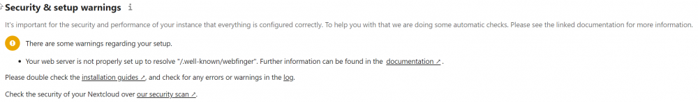

Your web server is not properly set up to resolve "/.well-known/webfinger". Further information can be found in the documentation
But I got the other old error instead:
The "Strict-Transport-Security" HTTP header is not set to at least "15552000" seconds. For enhanced security, it is recommended to enable HSTS as described in the security tips

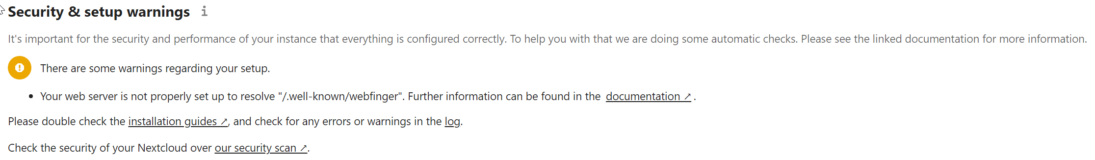

Which removed the error but resulted in me getting the old error back:
So I am in a Time-loop and just cant get rid of these two errors any input on how to solve this?

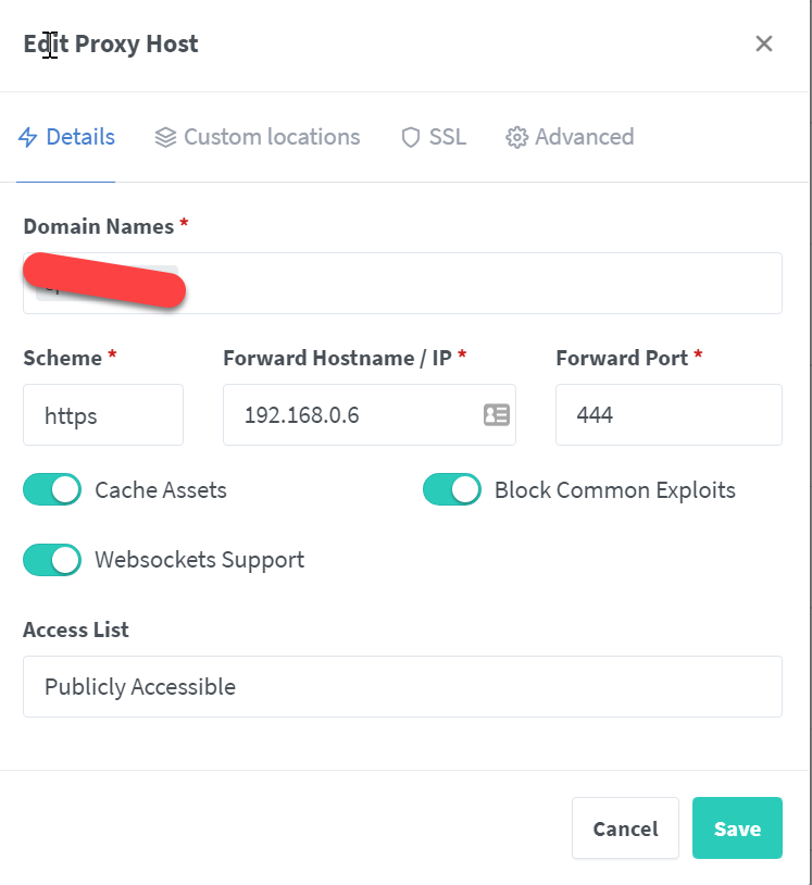

My Nginx Proxy Manager is really simple:
