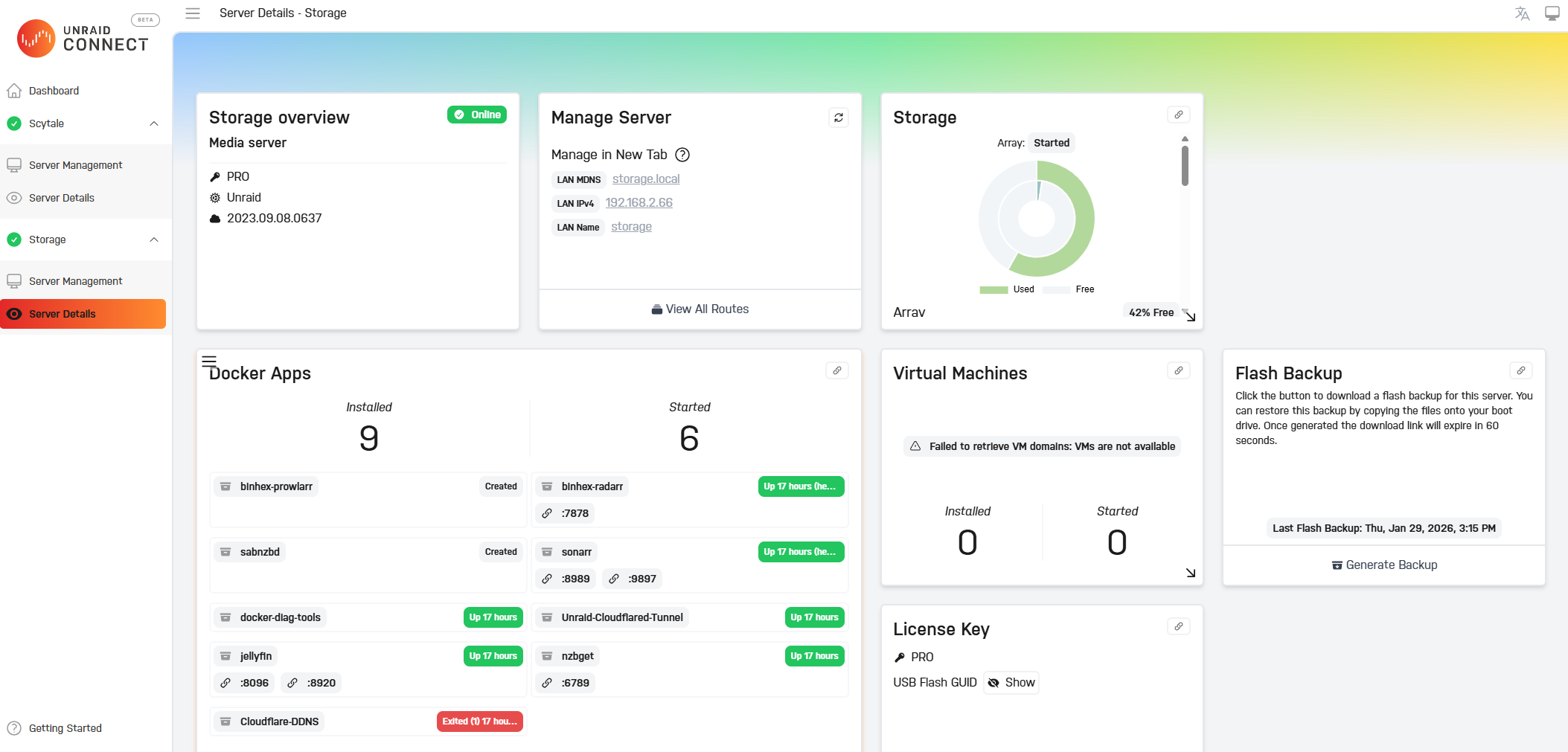

I have Cloudflare-DDNS disabled because I don't need it with the tunnel. Odd that everything about the server is visible but no remote management.
Can't remote connect to a server

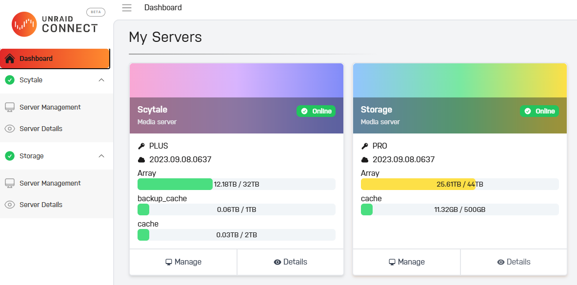

Two servers Both show "Online" Scytale works (can connect to server remotely) Storage doesn't allow remote management and is 200 miles away. I have a cloudflare tunnel and have setup apps (Radarr, Jellyfin, etc.) and CAN connect to them remotely (ie: jellyfin.mydomain.com) I can't find anyway to remotely manage "Storage" server

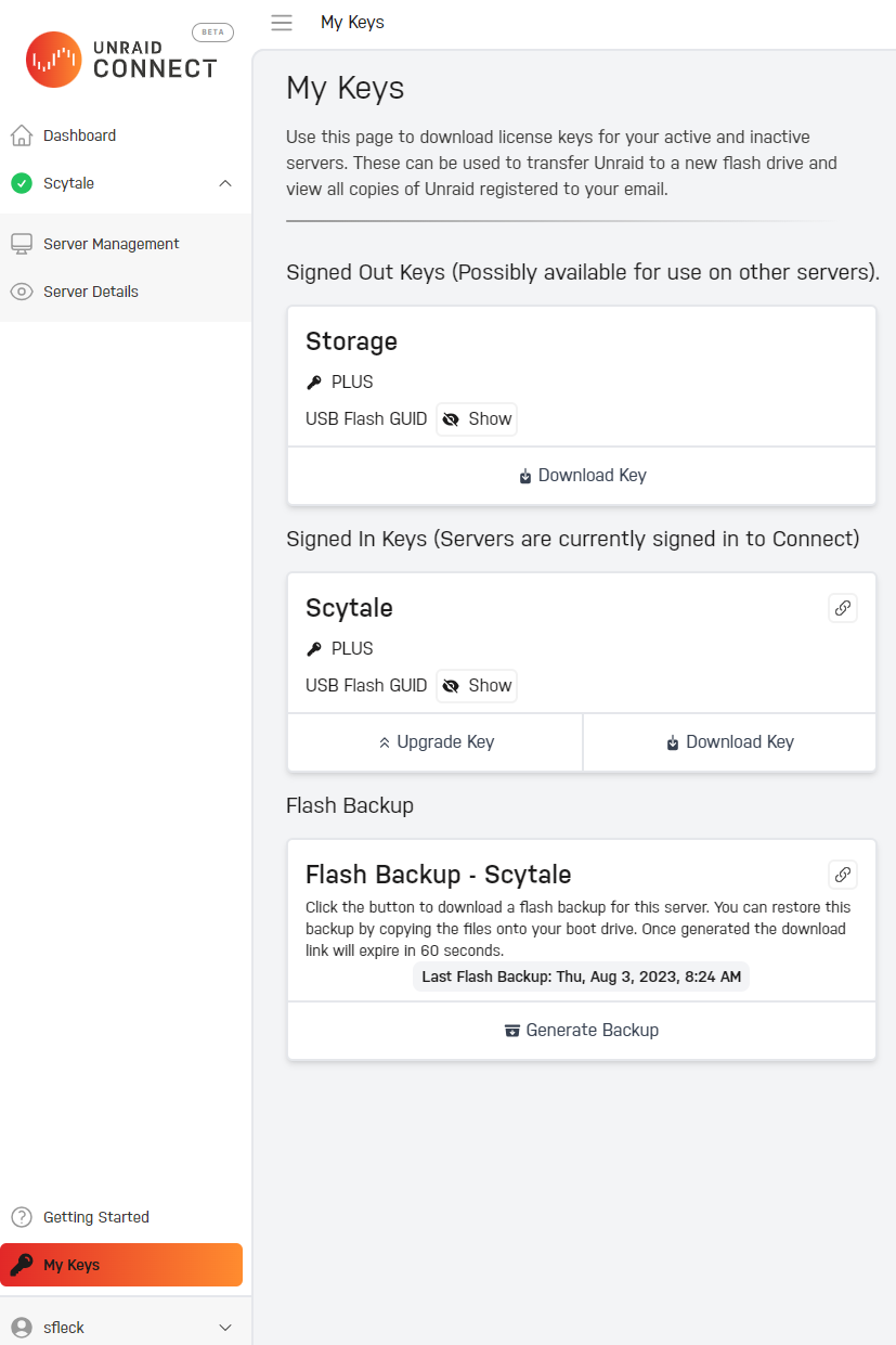

Apparently, if the server goes offline for some period of time (I think I read 5 days) the license gets suspended from the server. In any case, I had to go to the server and login and that enabled the server to reconnect the license to unraid.net All I had to do was login on the local network with the local IP of the server

Recently one of my servers disappeared from my dashboard. I have the following message left in its place: 1 License Key Not Registered With Connect My Keys What's the fix? Do I have to go to the physical site and connect directly or can it be fixed remotely? thanks!

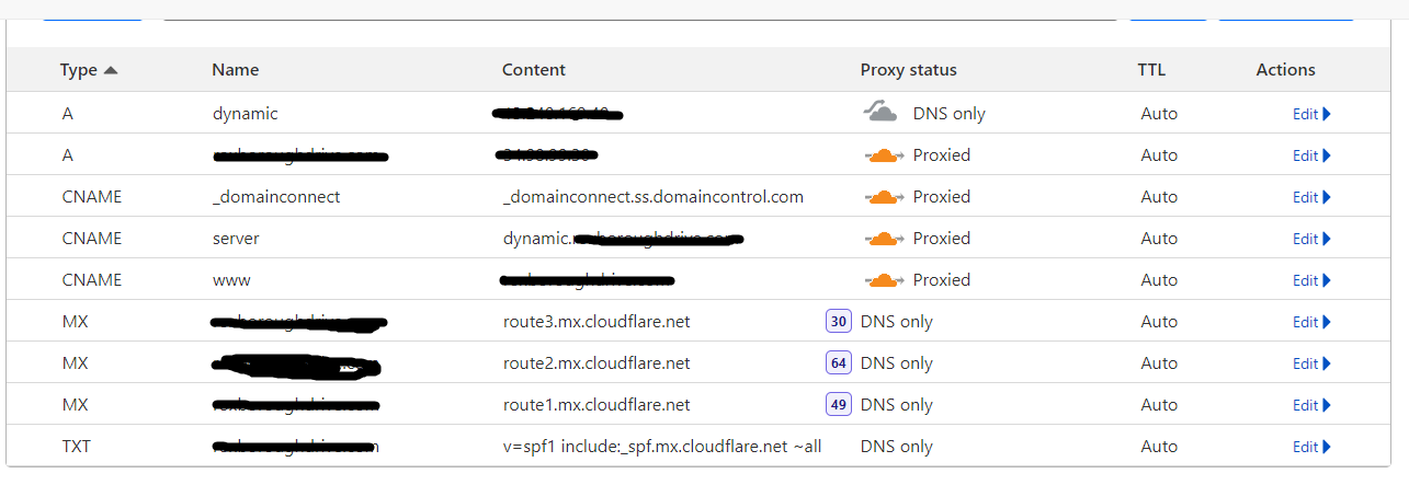

i can ping domainname.com i can ping dynamic.domainname.com i can get an IP for domainname.com and dynamic.domainname.com and ping that too I cannot get to my unraid server interface or any docker interface the key is signed out ... any thoughts on why?

I have a server that is a couple hundred miles away. I can see this in the Dashboard: "Signed Out Keys (Possibly available for use on other servers)." I have a Cloudflare connection and can ping the server domain name and IP address Is there a way I can remotely re-auth the key?- Preclear fails ... new 12tb HDD seems not well
