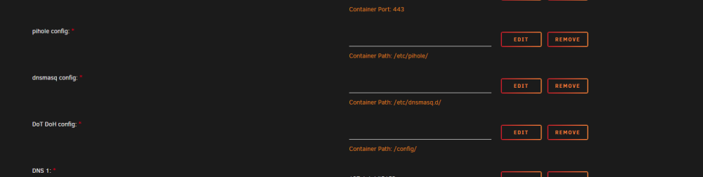

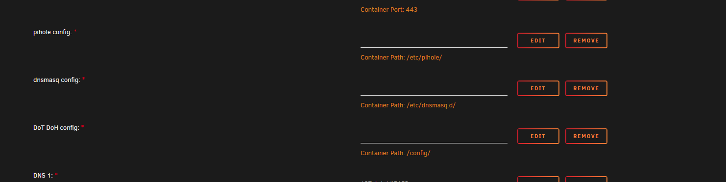

When doing a clean install your template is empty at the following places You need to fill this to be able to create the docker and without these filled there will not be a appdata directory for this docker. I filled this with: /mnt/user/appdata/pihole-dot-doh/pihole/ /mnt/user/appdata/pihole-dot-doh/dnsmasq.d/ /mnt/user/appdata/pihole-dot-doh/config/ (copied from the original outdated testdasi template) Maybe you can fill these in the template with the above? Makes it a little easier to install for the first time . EDIT: Thank you for keeping this docker alive in unraid!

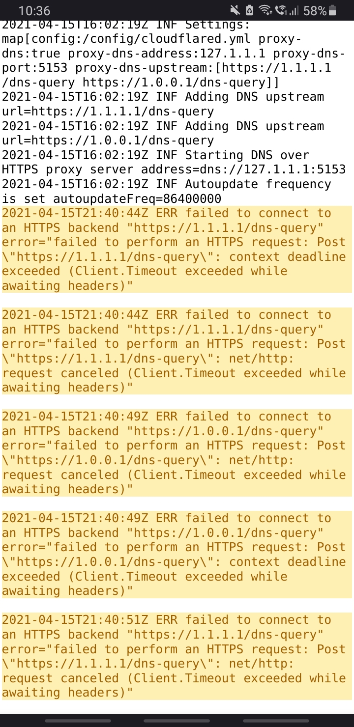

I am now also having the following error shown in the logs(see attachment) also fix common problems says I should connect to 8.8.8.8 or github could be down so seems unraid thinks there is no connection anymore. (nothing is being blocked for unraid)

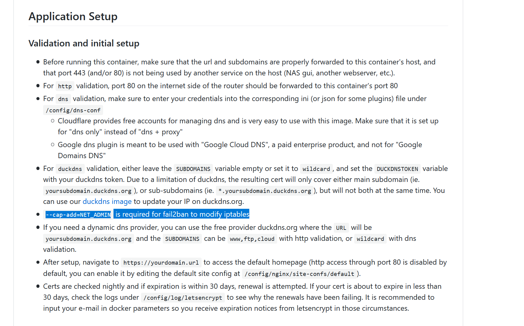

Added --cap-add=NET_ADMIN to extra parameters. Found it somewhere in a forum apparently it should be mentioned somewhere that you need this but could not find it. Can someone link me something that explains what this does exactly? (or tell me ofcourse) want to understand what i just did and why i missed it..
[Support] Linuxserver.io - SWAG - Secure Web Application Gateway (Nginx/PHP/Certbot/Fail2ban)
Hey so I am trying to setup basic auth with fail2ban and the authenticating is working great but fail2ban does not seem to do it's part: 020-05-09 18:31:32,502 fail2ban.filter [388]: INFO [nginx-http-auth] Found 84.241.199.134 - 2020-05-09 18:31:31 2020-05-09 18:31:38,515 fail2ban.filter [388]: INFO [nginx-http-auth] Found 84.241.199.134 - 2020-05-09 18:31:37 2020-05-09 18:31:43,727 fail2ban.filter [388]: INFO [nginx-http-auth] Found 84.241.199.134 - 2020-05-09 18:31:43 2020-05-09 18:31:44,462 fail2ban.actions [388]: NOTICE [nginx-http-auth] Ban 84.241.199.134 2020-05-09 18:31:44,465 fail2ban.utils [388]: #39-Lev. 1501c3a14110 -- exec: iptables -w -N f2b-nginx-http-auth iptables -w -A f2b-nginx-http-auth -j RETURN iptables -w -I INPUT -p tcp -m multiport --dports http,https -j f2b-nginx-http-auth 2020-05-09 18:31:44,466 fail2ban.utils [388]: ERROR 1501c3a14110 -- stderr: "iptables v1.8.3 (legacy): can't initialize iptables table `filter': Permission denied (you must be root)" 2020-05-09 18:31:44,466 fail2ban.utils [388]: ERROR 1501c3a14110 -- stderr: 'Perhaps iptables or your kernel needs to be upgraded.' 2020-05-09 18:31:44,466 fail2ban.utils [388]: ERROR 1501c3a14110 -- stderr: "iptables v1.8.3 (legacy): can't initialize iptables table `filter': Permission denied (you must be root)" 2020-05-09 18:31:44,466 fail2ban.utils [388]: ERROR 1501c3a14110 -- stderr: 'Perhaps iptables or your kernel needs to be upgraded.' 2020-05-09 18:31:44,466 fail2ban.utils [388]: ERROR 1501c3a14110 -- stderr: 'getsockopt failed strangely: Operation not permitted' 2020-05-09 18:31:44,466 fail2ban.utils [388]: ERROR 1501c3a14110 -- returned 1 2020-05-09 18:31:44,467 fail2ban.actions [388]: ERROR Failed to execute ban jail 'nginx-http-auth' action 'iptables-multiport' info 'ActionInfo({'ip': '84.241.199.134', 'family': 'inet4', 'fid': <function Actions.ActionInfo.<lambda> at 0x1501c3ece3a0>, 'raw-ticket': <function Actions.ActionInfo.<lambda> at 0x1501c3ece940>})': Error starting action Jail('nginx-http-auth')/iptables-multiport 2020-05-09 18:31:48,940 fail2ban.filter [388]: INFO [nginx-http-auth] Found 84.241.199.134 - 2020-05-09 18:31:48 2020-05-09 18:31:54,150 fail2ban.filter [388]: INFO [nginx-http-auth] Found 84.241.199.134 - 2020-05-09 18:31:54 2020-05-09 18:31:59,362 fail2ban.filter [388]: INFO [nginx-http-auth] Found 84.241.199.134 - 2020-05-09 18:31:58 2020-05-09 18:31:59,686 fail2ban.actions [388]: NOTICE [nginx-http-auth] 84.241.199.134 already banned 2020-05-09 18:32:05,374 fail2ban.filter [388]: INFO [nginx-http-auth] Found 84.241.199.134 - 2020-05-09 18:32:04 Basically trying from my phone on 4g to get myself banned but i can just keep retrying even though max retry's is at 3 if i try it for the 10th time and enter it correctly i just get in. dont know what the above errors mean tried to google it but did not find anything that helped me..
