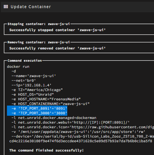

  8. EDIT: I changed the Home Assistant container to run on the same bridge (br0). Apparently when set to host mode it cannot access the br0 containers. Now it connects with websockets.

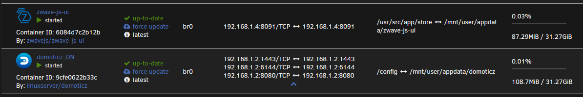

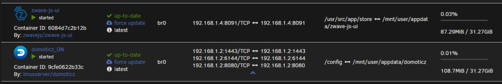

  9. Can I ask then why does the 8091 show mapped in the GUI? Also, why in my other Domoticz container does it show all three that is also on br0? I understand your explanation, but that port is not working to access from other containers. Only when I set the container to bridge mode does the websockets port 3000 become connectable.

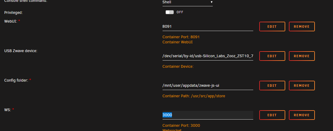

  10. I am trying to setup my new z-wave devices with zwave-js-ui container. That is working, but I am unable to use websockets due to the port not mapping. Below is an example of my Domoticz container, in which I have 3 mapped ports that all are showing. And in the zwave entry, only the 8091 shows. I can get it to map 3000if I change this to bridge mode, but I can't do that as I need this to access the MQTT container that is also on br0. Also when I edit and save the container, you can see the 3000 port is in the docker run command:
