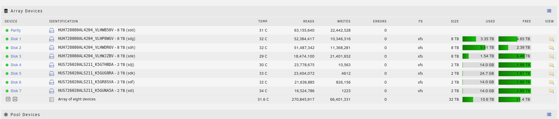

  3. Yup, I know I'll need to rebuild parity. I was just concerned that there were other files there of some importance that I would lose when pulling the drives and rebuilding. If it's just overheard, then that's fine and there should be no issue. Just seems odd that it isn't the same amount of overhead per drive which is why I was concerned.
  4. So I've run Unbalance on four 2TB drives that I want to remove from my array and it's moved all of the visible data on to the desired 8TB drives, however in the summary screen, there is indication that there is 14 - 24GB left on each of my 2TB drives. What is this data? I can't see it (i've also tried ls -a -R -s from the command line which also returns no results). I'm concerned about what will happen if I remove these drives from my array. Is there some necessary data on there or is it safe to remove them?

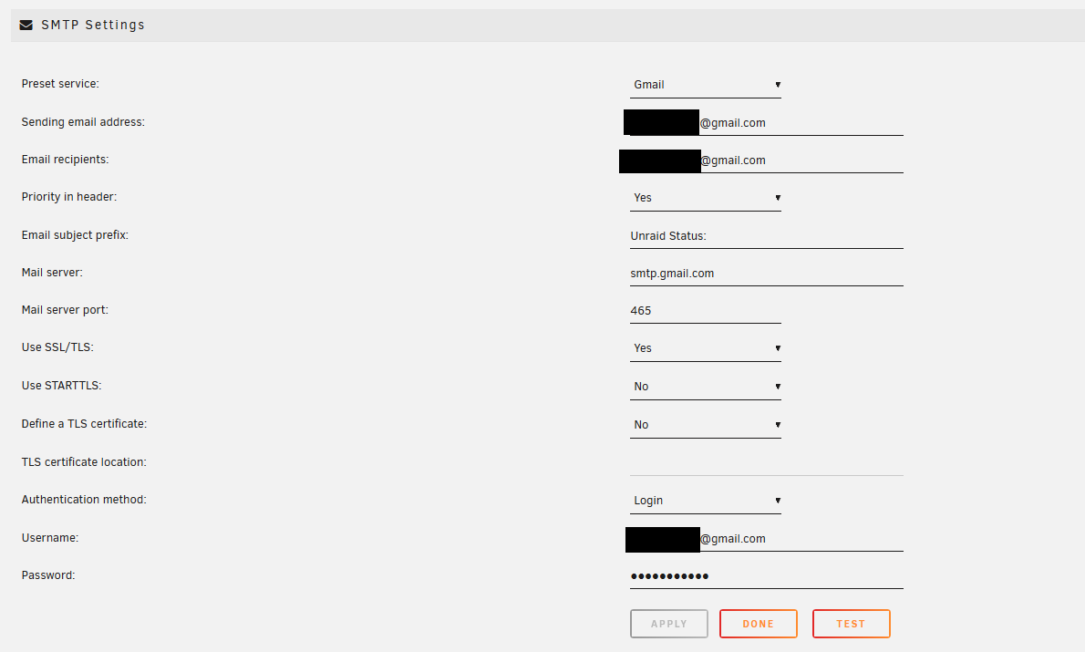

  12. I can confirm that these settings work for me. How do these compare to the settings you're using? Maybe post a screenshot?
