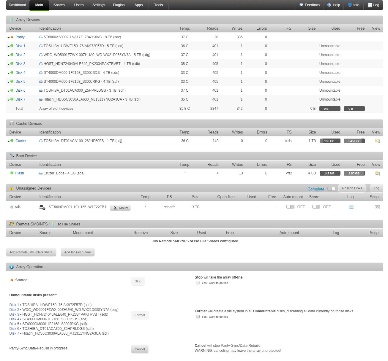

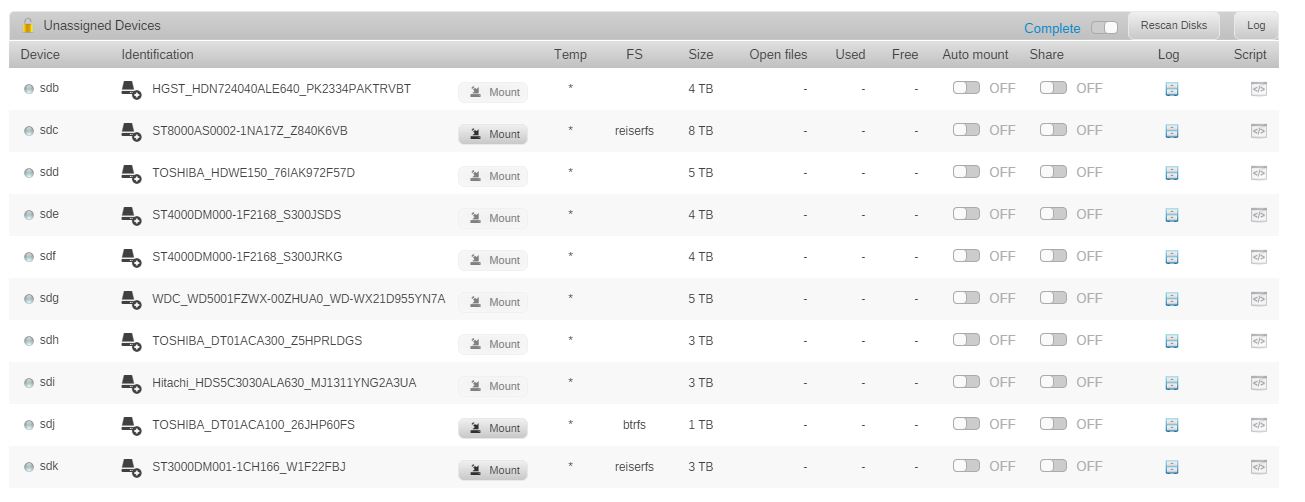

FWIW, I think I know what happened. Because my most critical data is saved on CrashPlan, I decided to just start over. All went well until I tried to add one more drive to the array. This was an RFS drive that I copied over to Disk 1 and then formatted to XFS using UNASSIGNED DEVICES. Unraid DID NOT accept this XFS drive, and said it needed to be reformatted. This is exactly how I lost 28TB of DATA. I used UNASSIGNED DEVICES to format XFS, then I copied data to these drives. UNRAID did not recognize their XFS, and required a FORMAT. I tried overnight to recover XFS before I quit and started over. I am now out of drives, but I am sure this situation is repeatable. 1. Format a drive XFS with UNASSIGNED DEVICES 2. Try to add it to a new array configuration You will not be able to do so without reformatting the drive in the array. Which is totally fine, unless you added data to the drive before trying to add it to the array like I did. I hope this helps someone avoid the loss of data that I just experienced. Attached diagnostics. grimlock-diagnostics-20160918-1519.zip

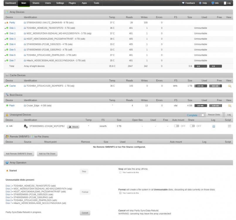

Apologies if this is a double post, but I lost two drives without parity and decided to rebuild with XFS. When I had all my data on XFS drives I tried to start the array and it asked me to reformat my XFS drives (and lose their data)... I said NO, but now each of my drives is unmountable with no XFS or any FS. Is there a way for me to restore XFS and more importantly all of my data? See attached. All of the blank FS disks are XFS disks filled with data.
