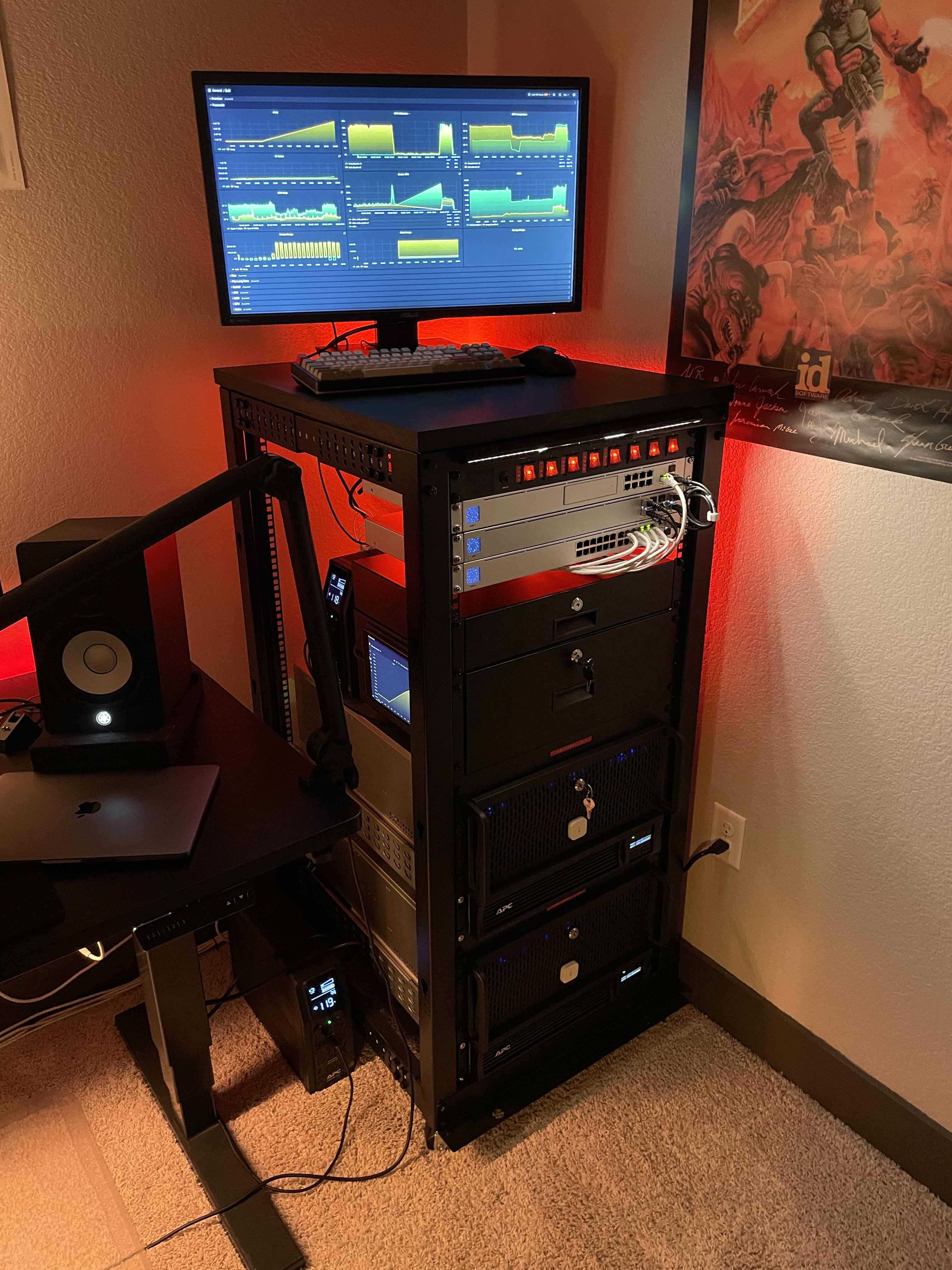

  5. This setup is now in the past for me. It lasted about 2 years before I was out of hard drive slots and needed to horizontally scale. The Antec 1200 case is great, and I am now going to look into selling it. I wonder if I can do that here on the unraid forums! I actually have TWO Antec 1200 cases, one is pictured above and has all of the hotswap bays in it already, the other has the normal faceplates. Anyway, here's what I'm running now in case you're wondering:

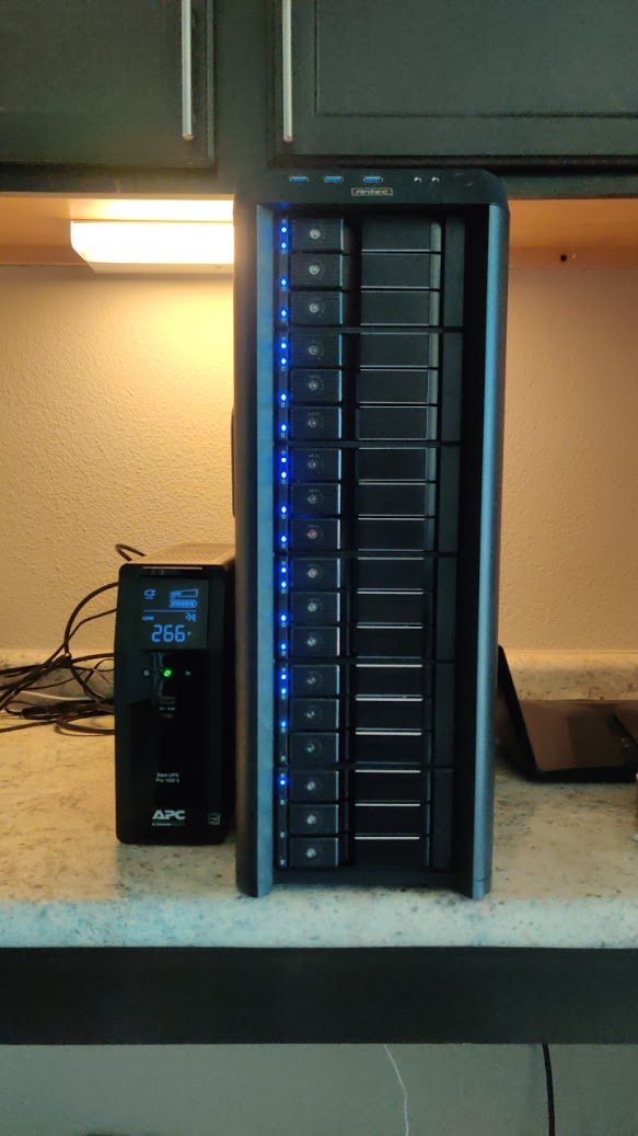

  6. I recently built a new system using a used Antec Twelve Hundred I got on ebay. This case is in near perfect condition and the auction for it went up to around $450. I suspect a fellow unraid user had similar plans with it as I did. I decided to go with 3 x 2 hotswap bays for a total of 18 slots rather than the 4 in 3 or 5 x 3 caddies. Better air flow, but only 18 slots instead of 20. Close enough! The main reason is so I wouldn't have to modify the slots on the inside of the case to accommodate the flat sides of the 5 x 3 caddies. I'm attaching an image. 152TB usable storage now with room to expand. 4 empty slots, 10 x 12tb drives, 4 x 16tb drives (2 are parity).
