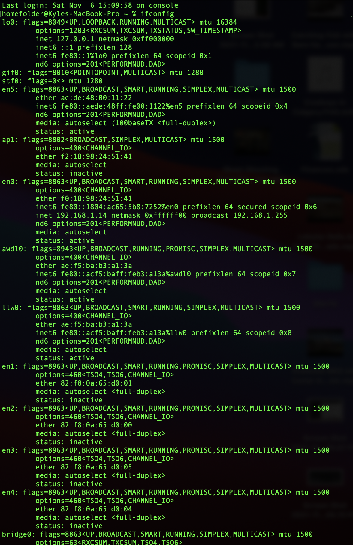

  16. Thank you @binhex for taking the time to help. I attached a screenshot of my ifconfig results as the netmask format doesn't match up, and also the log file. supervisord.log

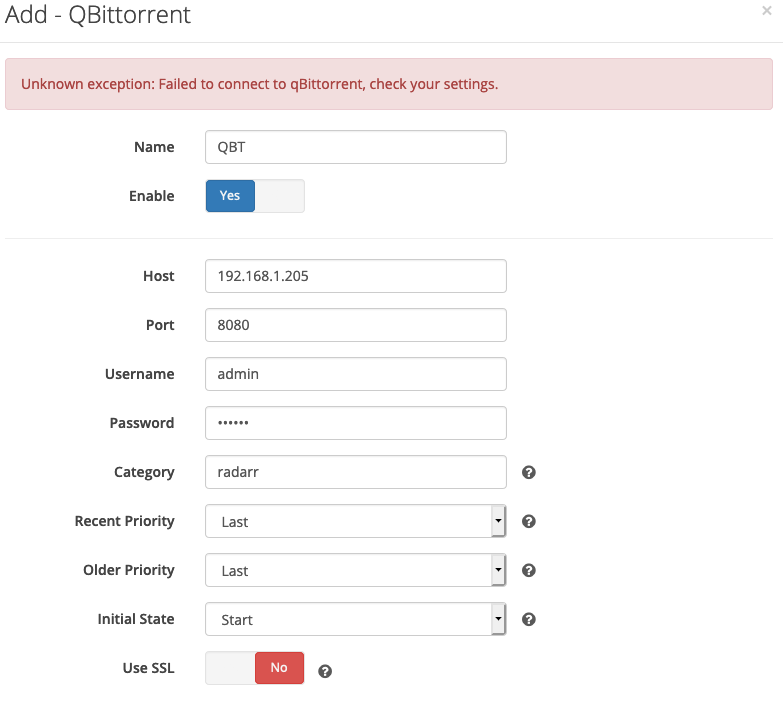

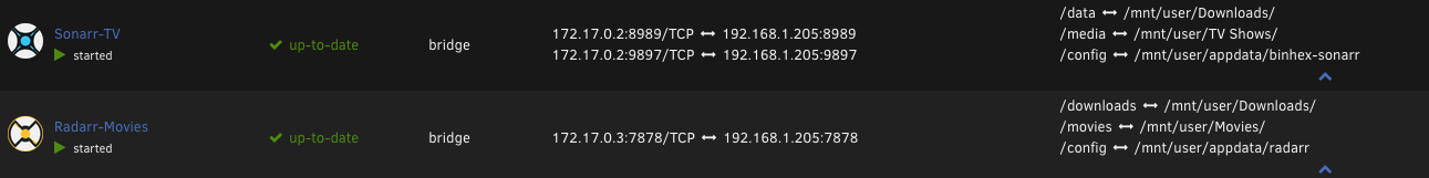

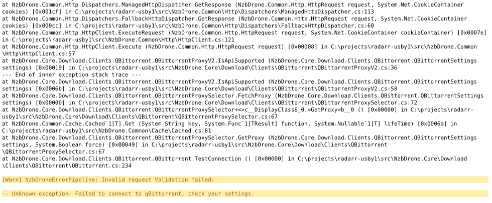

  19. My server is called Tower (maybe that's true for everyone? I'm kind of new to all this), and after playing with this a bit more, putting "Tower" in the Host boxes allowed Sonarr/Radarr to find qBittorrent! I'm not sure why the IP wouldn't work, but regardless this is taken care of. Thank you @binhex for all you do for this community!
  20. @binhex LAN_NETWORK is set to 192.168.1.0/24 in qbittorrentvpn
  21. Hello @binhex and others, I have been successfully using Sonarr+Radarr+Deluge for a while now, but for a variety of reasons I recently tried to switch from Deluge to qBittorrent. I have qBittorrent installed and can access it, download, etc successfully. However when I try to add as a Download Client in Sonarr or Radarr (or presumably Lidarr) I get the error "Unknown exception: Failed to connect to qBittorrent, check your settings." This is no doubt an issue with my configuration of qBittorrent because Deluge worked without issue previously, but I cannot figure this out. Could someone provide guidance? Thank you!
