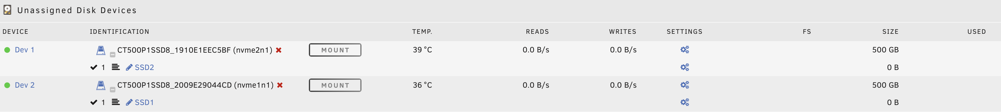

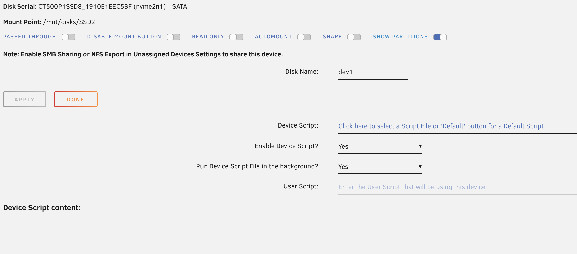

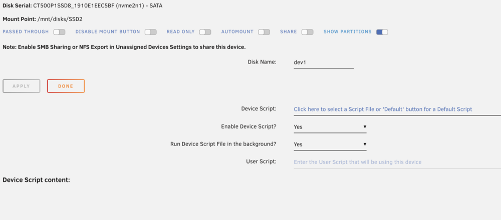

  5. I'm having a spot of bother where I have 2 NVMe SSDs that I don't seem to be able to mount. I've tried deleting partitions, reformatting as various different filesystems etc but for some reason the mount button is always greyed out. Destructive mode is enabled in settings, and I can't see anything relevant that may be affecting this. Am I missing something obvious?

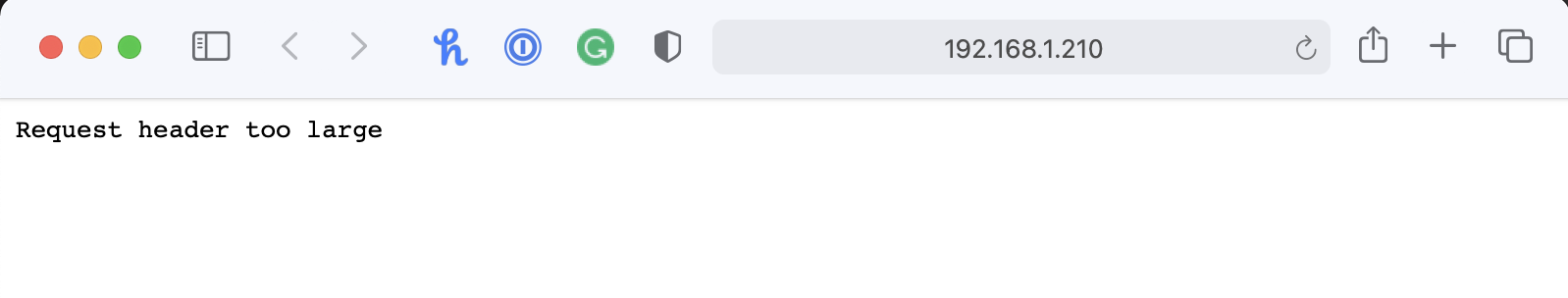

  12. I've tried setting up Authelia following the deep dive video and I'm having an issue. Ive managed to get to the point where the container starts up with no errors in the log, however when I try to open the web UI I get the following in my browser: I'm using File notifications and there is absolutely nothing in the notification.txt file. Any ideas? Thanks.
