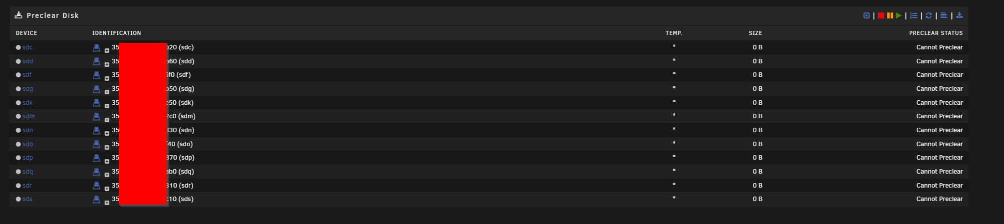

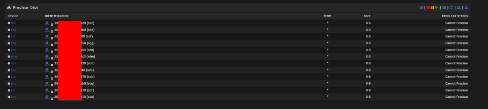

  10. Got 12 used dell enterprise SSD drives from work today, but I am having some problems with the unassigned device plugin. They are not showing up as unassigned devices. They show up in the unassigned preclear-thingie, but they are all marked as "cannot preclear". I see them in the filesystem under /dev/dsXXX. I even get smart data off them by using smartctl. Anyone know how come the preclear and mounting is not working? I am running version 6.11.5 of unraid. Diagnostics attached. unraid02-diagnostics-20230228-2311.zip
