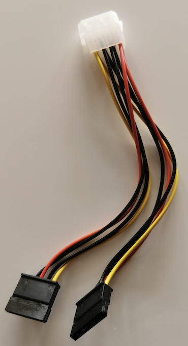

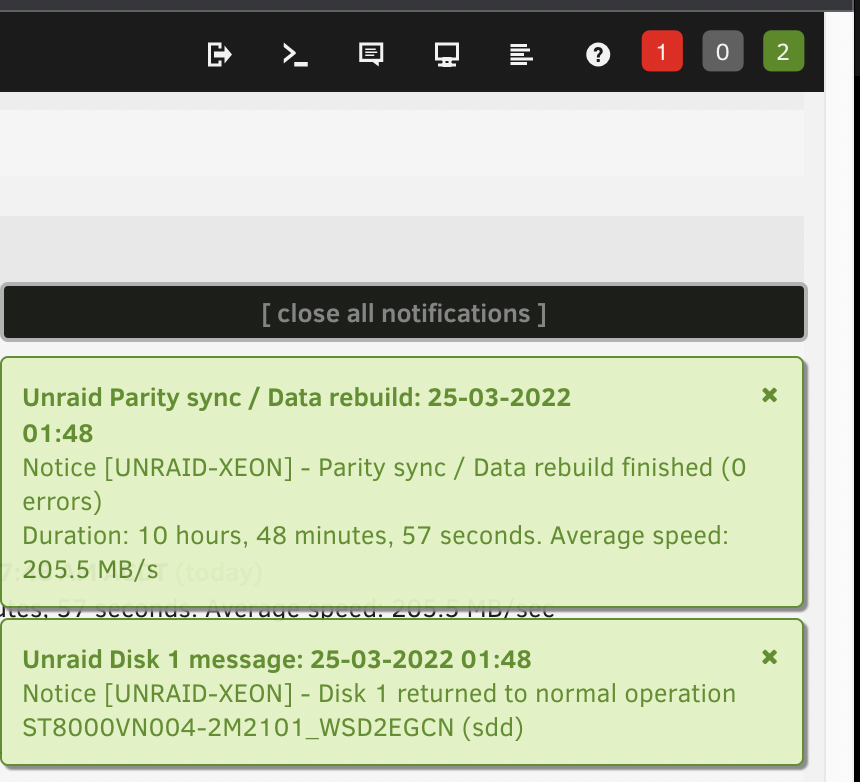

I think I finnally found the culprit. The I/O errors actually came from, I believe, the insufficient sata power. I used a molex-to-2x-15-pin-sata cable to power the silverstone 5HDD hot-swag cage due to the clerance problem. And I never ran into problems untill I populated all 5 HDD into a single cage (I have two of the cages). I found a simular issue, which prompted me to try power the cage with two dedicated sata cable straigh from the PSU. THE end result is that the disk 1 was pre-clear at double of data rate at 200+MB/s instead of 90MB/s . The rebuild process was done in 10 hrs with average 202MB/s. I wish the system log could be more precise about the I/O error (" hard resetting link") , or the drive itself should have reported under-power issue. I hope this will be helpful for someelse.

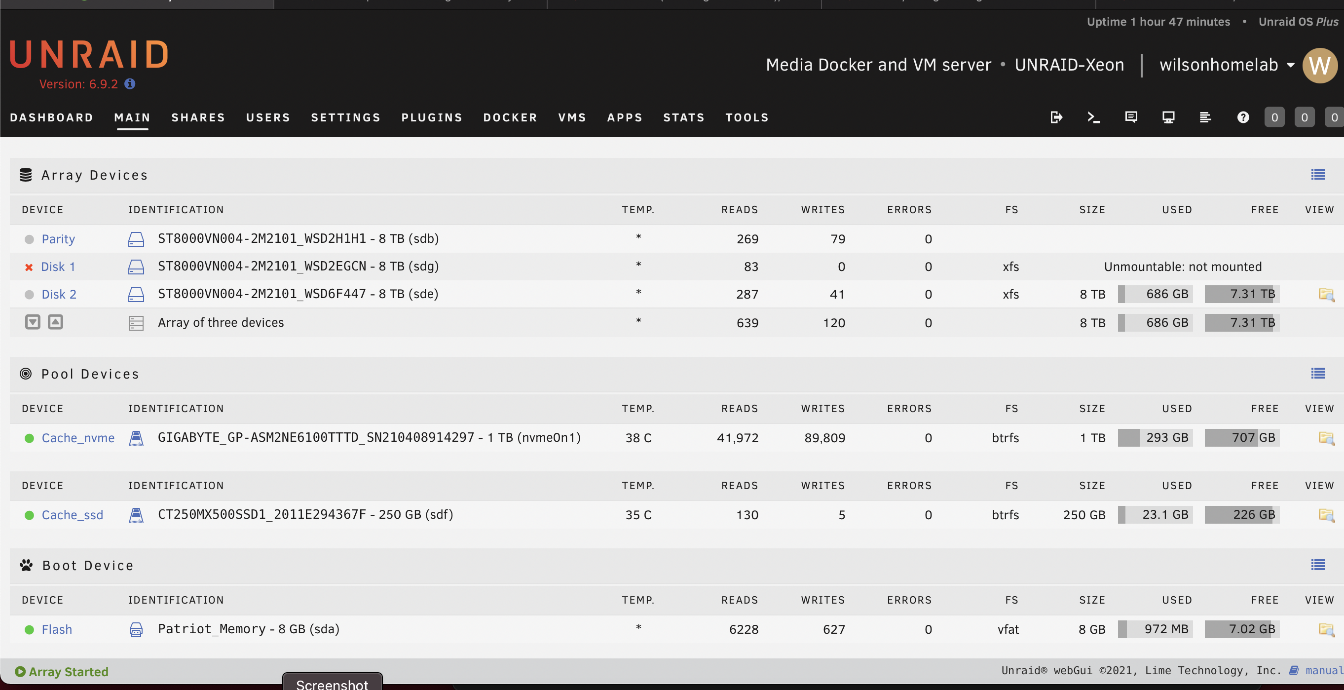

I went ahead with the -L option. Now I can see the disk 1 content!😀 If I understand correctly, will the parity start rebuilding the physical disk 1 once I restart the array with disk 1 plugged in? I also want to make sure whether this issue is an indication of a failing drive. May I perform a pre-clear of disk 1 first to see if it can withstand the heavy read / write process? If it is good, I put it back to the array for rebuild. root@UNRAID-Xeon:~# xfs_repair /dev/md1 -L Phase 1 - find and verify superblock... - reporting progress in intervals of 15 minutes Phase 2 - using internal log - zero log... ALERT: The filesystem has valuable metadata changes in a log which is being destroyed because the -L option was used. - 04:55:12: zeroing log - 119233 of 119233 blocks done - scan filesystem freespace and inode maps... - 04:55:13: scanning filesystem freespace - 32 of 32 allocation groups done - found root inode chunk Phase 3 - for each AG... - scan and clear agi unlinked lists... - 04:55:13: scanning agi unlinked lists - 32 of 32 allocation groups done - process known inodes and perform inode discovery... - agno = 0 - agno = 15 - agno = 30 - agno = 16 - agno = 17 - agno = 1 - agno = 31 - agno = 18 - agno = 2 - agno = 19 - agno = 20 - agno = 21 - agno = 22 - agno = 3 - agno = 23 - agno = 24 - agno = 25 - agno = 26 - agno = 27 - agno = 28 - agno = 4 - agno = 5 - agno = 29 - agno = 6 - agno = 7 - agno = 8 - agno = 9 - agno = 10 - agno = 11 - agno = 12 - agno = 13 - agno = 14 - 04:55:24: process known inodes and inode discovery - 148992 of 148992 inodes done - process newly discovered inodes... - 04:55:24: process newly discovered inodes - 32 of 32 allocation groups done Phase 4 - check for duplicate blocks... - setting up duplicate extent list... - 04:55:24: setting up duplicate extent list - 32 of 32 allocation groups done - check for inodes claiming duplicate blocks... - agno = 0 - agno = 3 - agno = 2 - agno = 7 - agno = 9 - agno = 11 - agno = 12 - agno = 21 - agno = 22 - agno = 23 - agno = 13 - agno = 28 - agno = 5 - agno = 1 - agno = 8 - agno = 19 - agno = 17 - agno = 6 - agno = 18 - agno = 20 - agno = 4 - agno = 15 - agno = 24 - agno = 25 - agno = 26 - agno = 10 - agno = 27 - agno = 16 - agno = 29 - agno = 30 - agno = 14 - agno = 31 - 04:55:24: check for inodes claiming duplicate blocks - 148992 of 148992 inodes done Phase 5 - rebuild AG headers and trees... - 04:55:25: rebuild AG headers and trees - 32 of 32 allocation groups done - reset superblock... Phase 6 - check inode connectivity... - resetting contents of realtime bitmap and summary inodes - traversing filesystem ... - traversal finished ... - moving disconnected inodes to lost+found ... Phase 7 - verify and correct link counts... - 04:55:31: verify and correct link counts - 32 of 32 allocation groups done Maximum metadata LSN (6:909635) is ahead of log (1:2). Format log to cycle 9. done

I click the "CHECK" button under "disk1 setting", and nothing happen. So I typed the command as follow root@UNRAID-Xeon:~# xfs_repair /dev/md1 Phase 1 - find and verify superblock... - reporting progress in intervals of 15 minutes Phase 2 - using internal log - zero log... ERROR: The filesystem has valuable metadata changes in a log which needs to be replayed. Mount the filesystem to replay the log, and unmount it before re-running xfs_repair. If you are unable to mount the filesystem, then use the -L option to destroy the log and attempt a repair. Note that destroying the log may cause corruption -- please attempt a mount of the filesystem before doing this. Could you please explain what the "ERROR" session ? Thanks

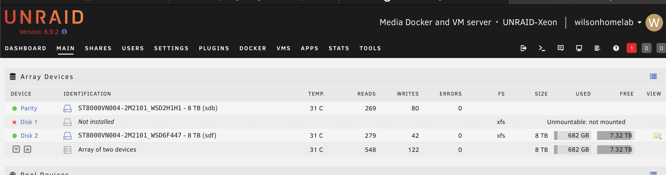

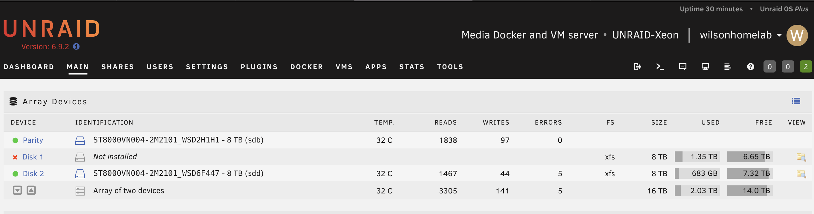

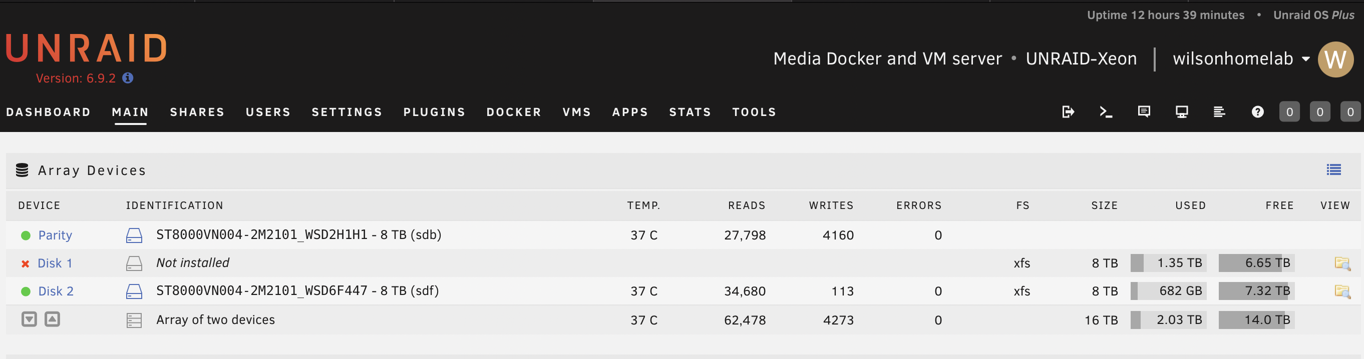

I removed the disk 1, and restarted Unraid. As I expected, the parity drive doesn't emulate the missing drive. Please help! My priority will be recovering the missing data from parity. I hope it will be still possible. Then test the problem drive as it is still under warranty.

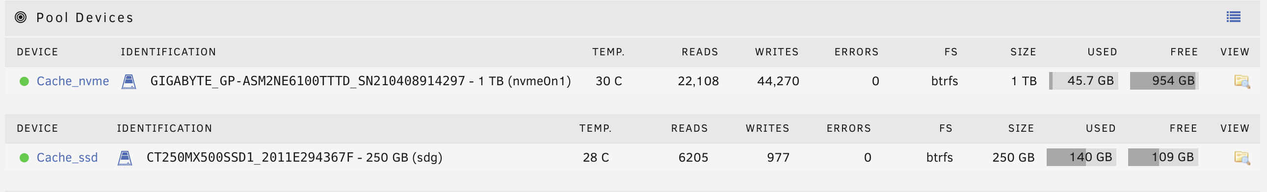

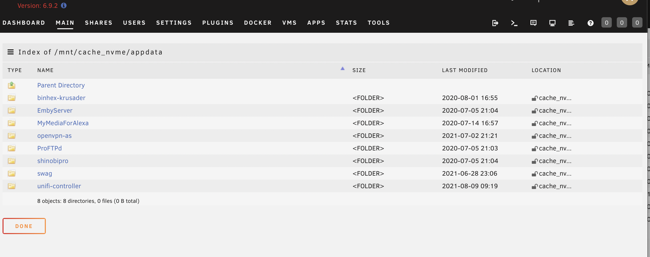

Thank everyone. I stop all dockers and vms, then rsync those folders to the nvme cache. It seems to work. When I rename the appdata folder to "appdata_" in the cache_ssd, for the sake of keeping a backup, a new share "appdata_" appears. Sent from my VOG-L29 using Tapatalk

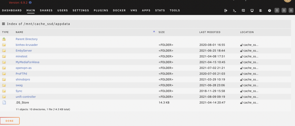

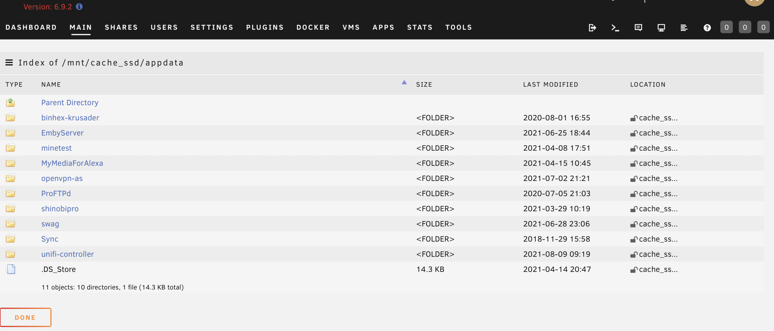

I tried to set appdata, domains, system "yes" of "use cache pool", then invoked mover, but nothing happened. Files are not moved and still sitting in both cache pool. Please help Can I manually move files between cache pools? Sent from my VOG-L29 using Tapatalk

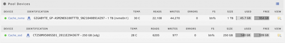

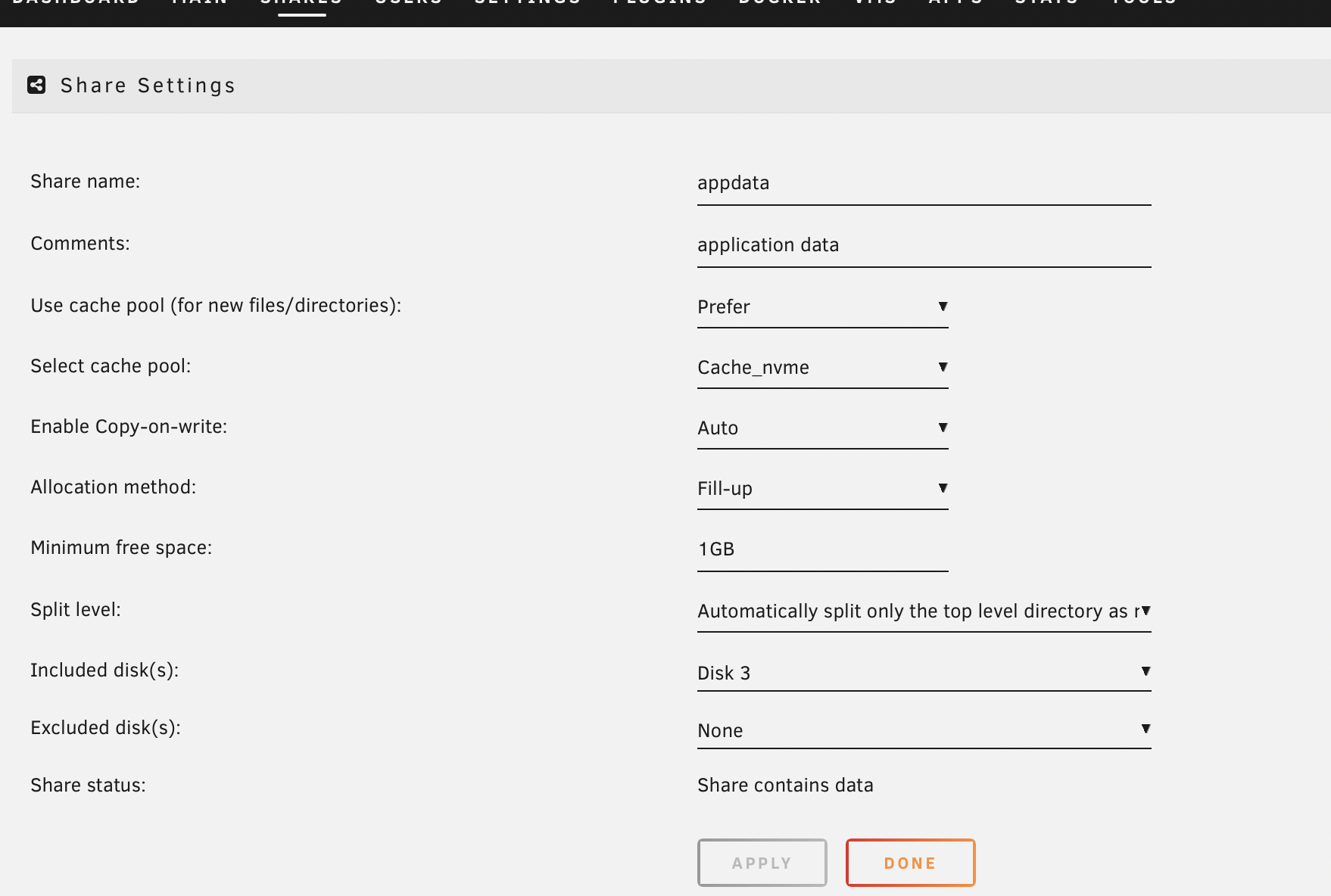

I recently purchase a 1TB NVME drive for cache in Unraid (6.9.2) along with an existing 250GB SATA SSD cache drive. I setup two cache drives. like this My plan is that Cache_nvme is reserved for appdata, system, domains shares, while Cache_ssd is for cacheing SMB copy via 10 GBE (then mover will move data off Cache_ssd later to array). I setup appdata share as this. Somehow mover moved most of appdata to Cache_nvme. Now I've got two (almost) duplicate appdata share in both cache drives. I can't remember how this happen. I think I need to use "Yes" option to let mover move appdata back to array first, then change to "prefer" -> invoke mover to move it again to cache (in this case, new cache_nvme). I am pretty sure that I didn't do this step, but now I have duplicate appdata in both cache drives. (I did invoke mover a few times to shift other shares) So my questions How do I consolidate appdata share to cache_nvme only? Can I manually delete appdata share in cache_ssd? (command line or Krusader) If I write data to "appdata" share, will it update to both cache drives? Thanks
