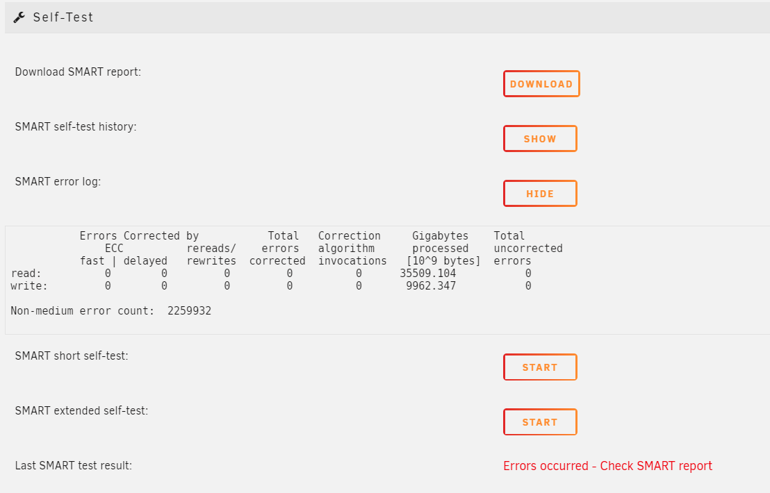

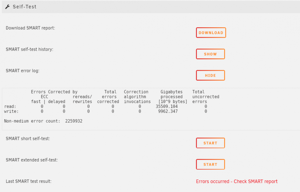

disk 2 unraid-ryzen-smart-20210823-1956.zip disk 1 unraid-ryzen-smart-20210823-1954.zip diagnostic unraid-ryzen-diagnostics-20210823-1812.zip I don't have enough knowledge for the SMART report. but this section caught my attention. In disk 1 report, it says I did click the "SMART extended self-test" before. Is the SAS drive performing an extended self-test? The spin-down is enable. Looks like the self-test may be interrupted when spin-down. It makes me quite worried. So it is a false alert! So, am I safe to go ahead for parity drive upgrade?

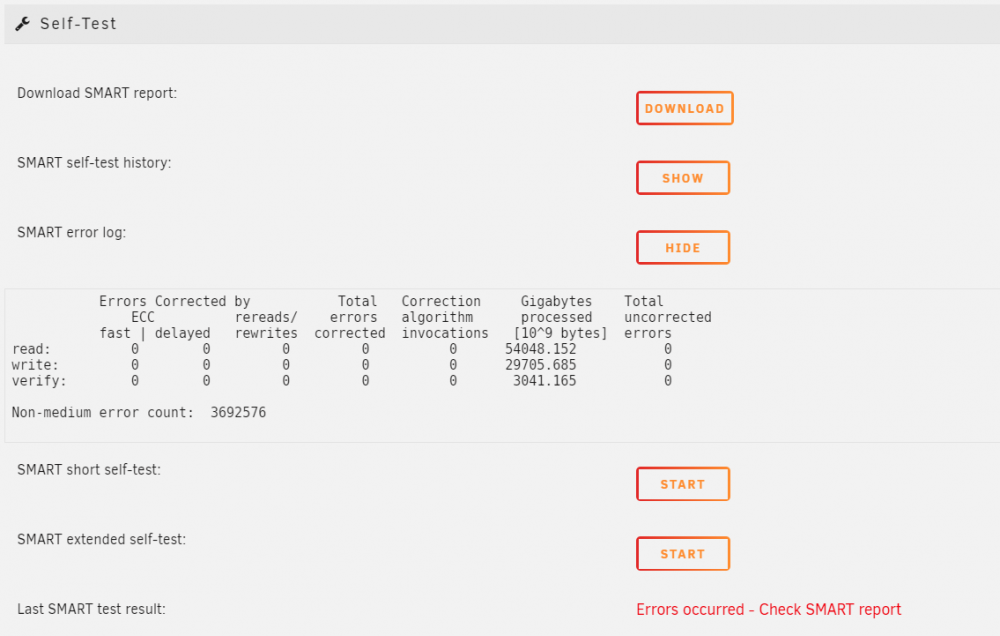

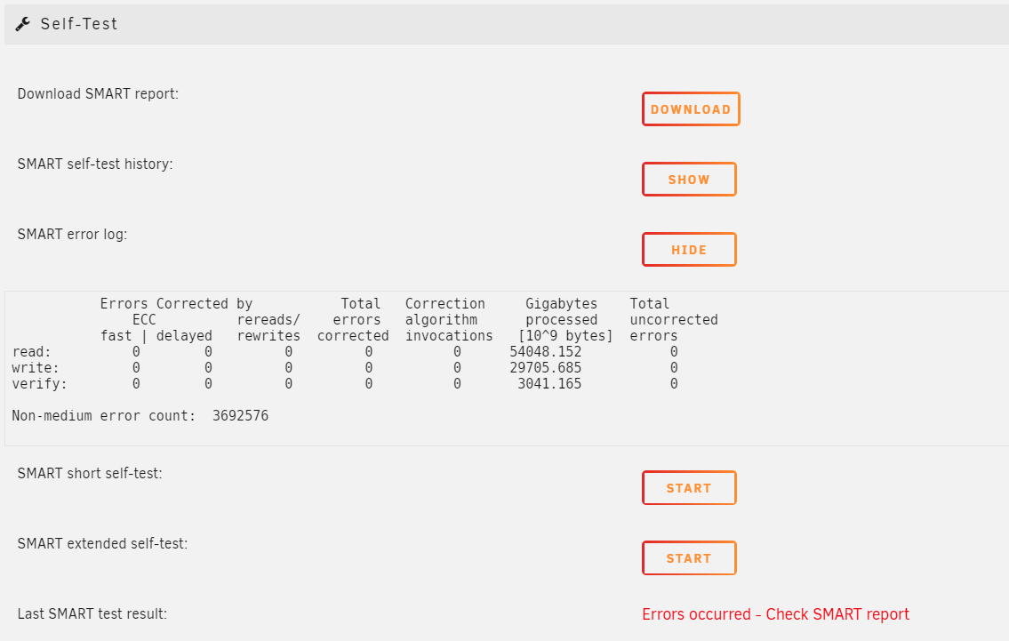

So the rebuild of disk2 finished. Next, I will upgrade the 4TB parity to 8TB drive. Before I move on, will I need to make sure that the disk2 is rebuilt properly? please advise Both disk 1 and disk 2 still have SMART errors. disk 1 disk 2

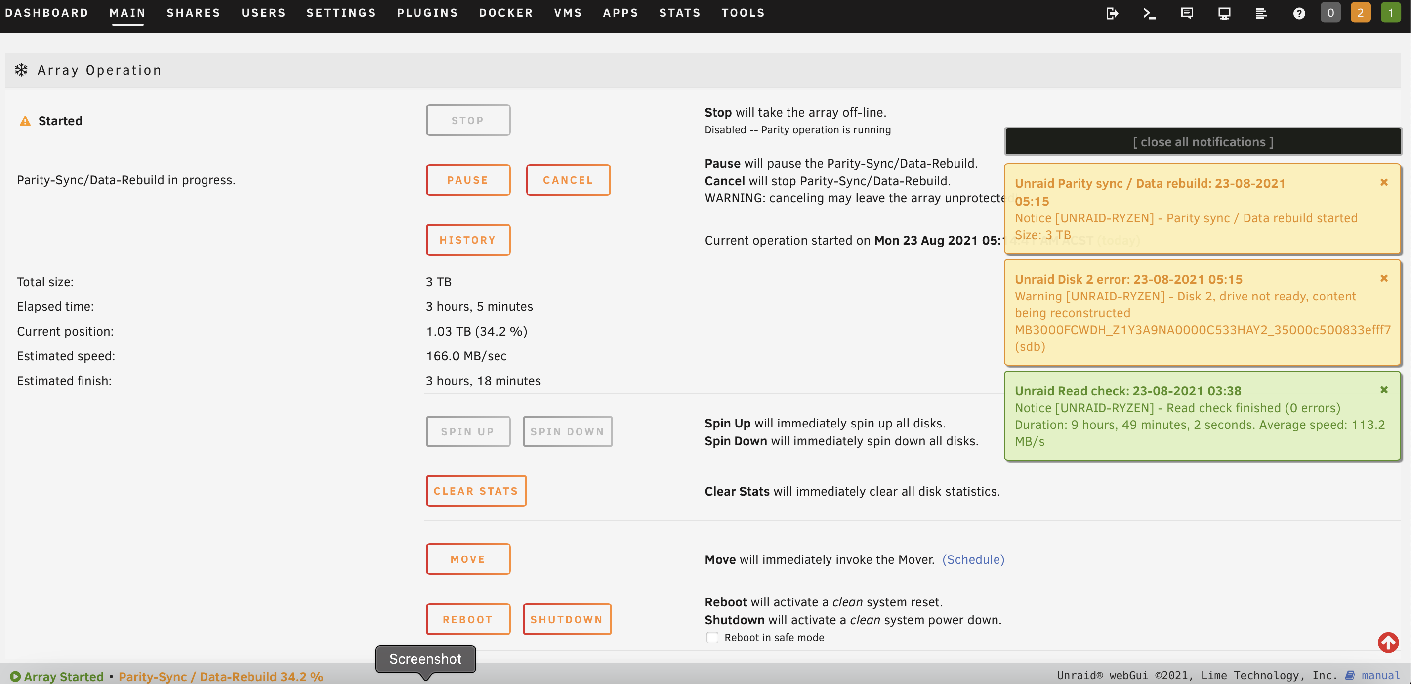

I am currently rebuilding disk2. I am quite happy with 166MB/s speed. About 3hr left. Will report back the result.

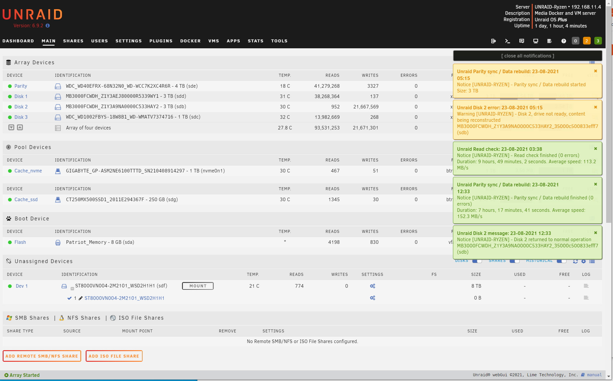

Thanks JorgeB. I swap the disk 2 to the old "reliable" cable and running a parity check at the moment. I am just wonder if the "new" cable is the culprit, would the disk rebuild I performed over this cable be ok ? There is no error reported after the rebuild.
