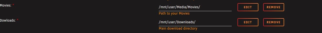

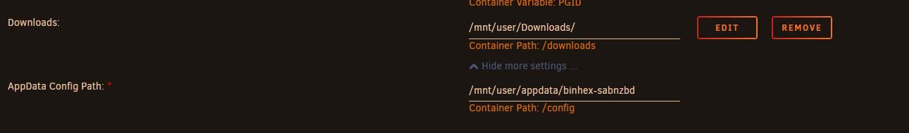

  7. They are both pointed to /mnt/user/Downloads/

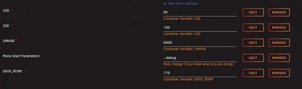

  8. ich777/radarr Unraid - Recently started running into an issue with Radarr not being able to import movies, stating permissions denied to /Media folder for import. I've tried applying Chmod 777 to this folder with no luck
  9. Having an issue when trying to connect custom script to trigger on import. Getting this message: ApplicationName='/tools/Radar_completion.sh', CommandLine='', CurrentDirectory='', Native error= Access denied I tried CHOWN on the folder permissions to 'nobody' but still the same issue. Are there specific credentials radarr is authenticating?
