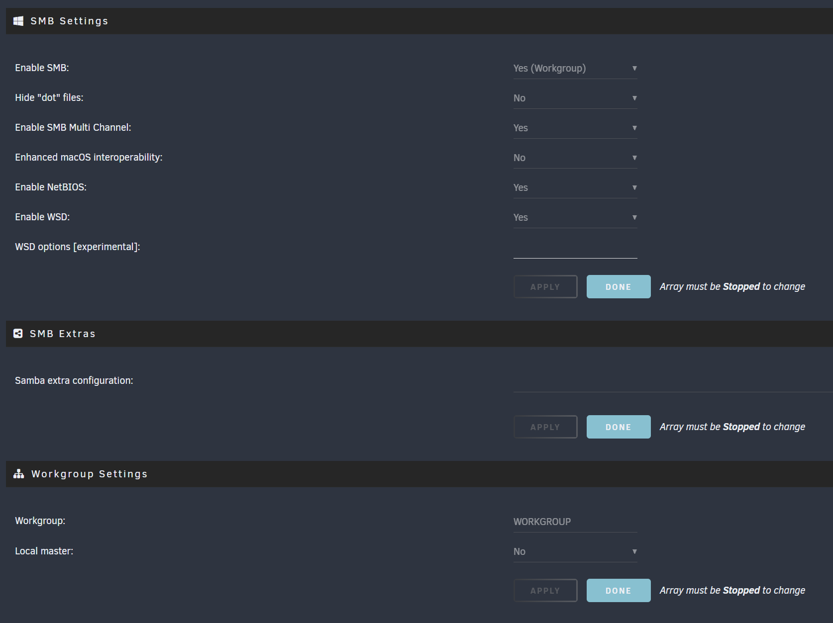

  15. Hi all, suddenly, since a few weeks, I can't use the UNRAID GUI user/share functionality with my network shares anymore for SMB. All my shares bring up an error, both on Windows 11 and Ubuntu 22.04 clients. At first, I thought an UNRAID upgrade might have disabled the older SMB versions potentially used by Windows but then I realized my Ubuntu machine was equally unable to connect to the shares. Things I've done: rebooted the machine rebuilt parity on my hard drives trailed the syslog and nothing comes up deleted credentials from Windows Credential Manager and rebooted Worth noticing, when I try to access the NAS through the domain name (super-nas.local), I don't even get to see the folder tree, it immediately prompts for user/pwd (and brings up the first screenshot thereafter) Attached my diags, appreciate your time to try and assist! Example error message on Windows 11 client: super-nas.local-diagnostics-20231022-1121.zip
