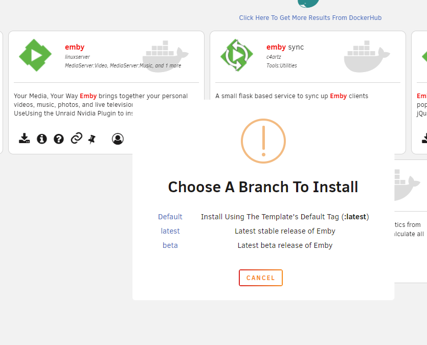

Having an issue that I noticed after last update. If an installer gives me a popup window for which branch to install none of the branches work. I can click any of the branches, but nothing at all will happen, the popup even stays open. Steps I did when issue appeared - Installed overseerr - linuxserver docker - Removed overseerr - linuxserver docker - Updated CA to last version (2021.08.08) as per CA's request - Tried installing overseerr - linuxserver docker but my above issue started appearing Any that don't give this popup work completely normal and instantly bring me to the template. It doesn't matter if it's one I've had/have installed before or if it's a completely new one. Restarting UNRAID did not solve the issue. As an example I put a picture of emby - linuxserver (one of the ones I've tried) to show what popup I mean.
Ended up resorting to removing the docker.img and creating a new one and reinstalling all the dockers. This solved the issue for me. Looked to me like there was a rogue network that didn't even show up with "docker network ls".
