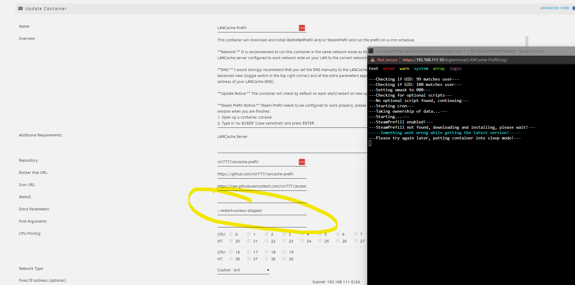

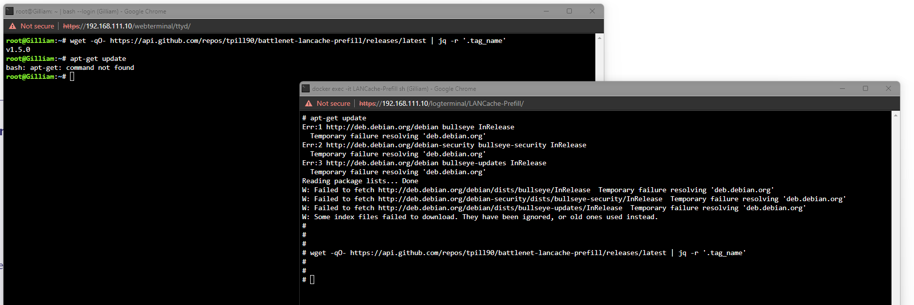

  2. So, I'm not super great navigating Github. Where would I got if I was looking for the version.php file for lscr.io/linuxserver/nextcloud:24.0.6-ls204 ? Also what commands did you use to set the correct permissions? Thank you in advance!

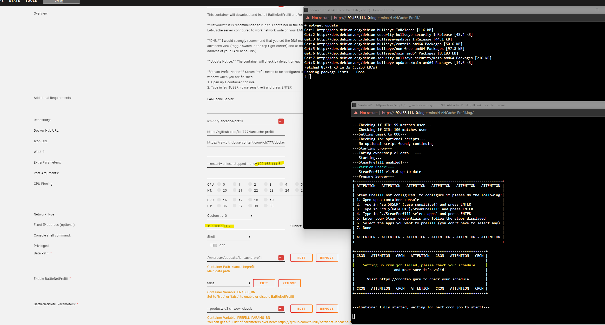

  3. So it looks like my problem was that I didn't assign a local IP to the container. I skipped over it because Spaceinvader skipped it in the video and it was listed as (optional) in the config. I was able to get a result from apt-get update using both dns=1.1.1.1 AND dns=192.168.111.6 (Lancache-dns) I think I should be able to continue from this point. Thank you so much for all the help! I hope this helps someone else out as well.
  4. I assume you meant to run those commands under the containers terminal, but I ran them under the base unraid terminal too and came up with these results.

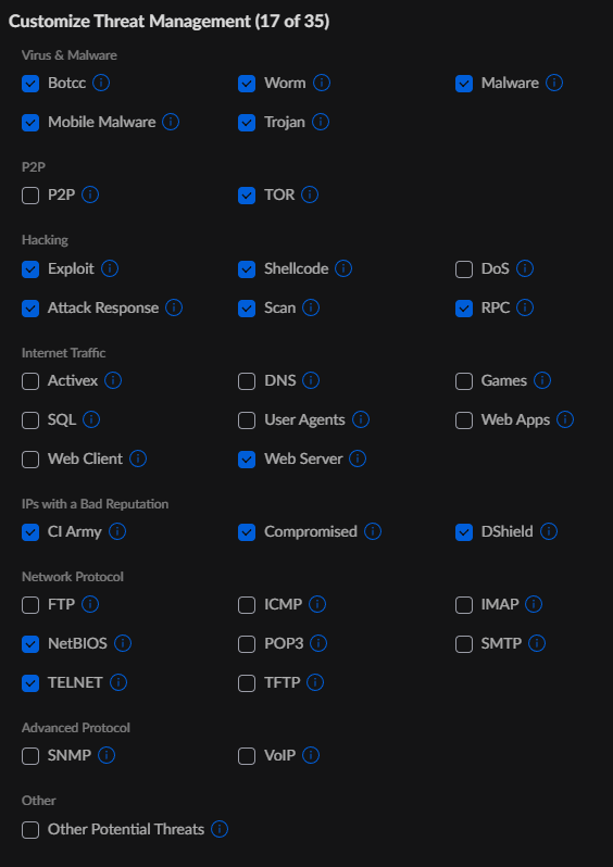

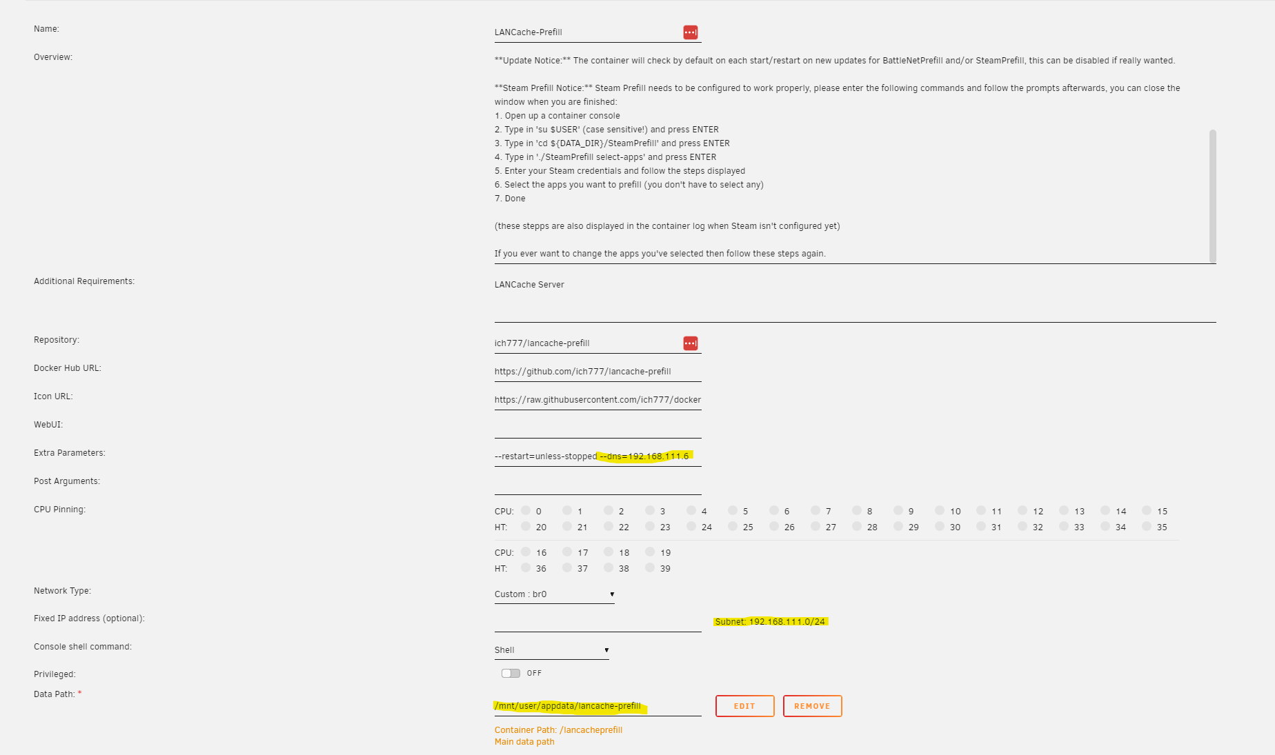

  5. Thank you for getting back to me so quickly. I've gone ahead and removed the --dns portion of the config and still no luck. I even uninstalled, removed image and reinstalled once more without making any changes to the default config and still no dice. The only thing I can think of is if there's some sort of filtering on my network going on. I'm using a Unifi Dream Machine Pro for my router/firewall and I use Cloudflares Malware DNS filter 1.1.1.2 and 1.0.0.2 as default DNS for my network. However I've never had any issues like this using any other Unraid Container/Application. IPS/IDS Filter settings in my UDMP Firewall

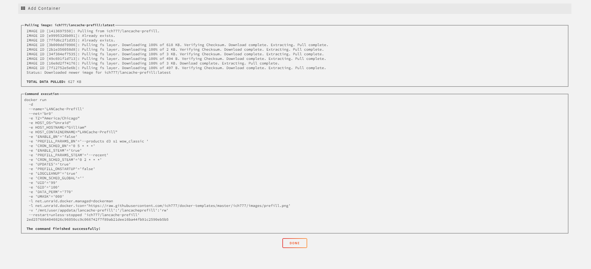

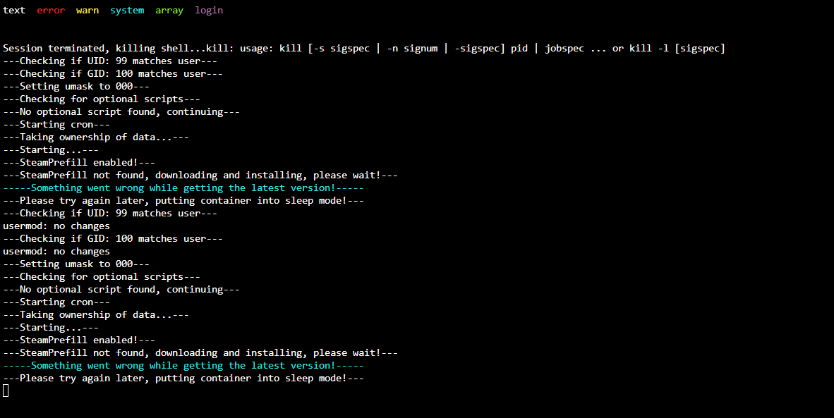

  6. Hello, I seem to be having an odd issue with Lancache Prefill not fully installing for some reason. I followed Spaceinvader One's video guide on setting up Lancache, Lancache DNS and Lancache Prefill. Lancache itself seems to be working fine as is, but when I try to configure Lancache Prefill I first ran into errors when trying to CD to add in my Steam Credentials. Lancache is at 192.168.111.5 Lancache DNS 192.168.111.6 Lancache Prefill is pointing to 192.168.111.6 in extra parameters. When I enter cd ${DATA_DIR}/SteamPrefill I get this directory not found error. I checked the logs for the container itself and I see this I've tried restarting the container, reinstalling, no dice. Even checked the directory itself and I'm not seeing anything. Like I said Lancache itself seems to be working fine, but obviously the lancache prefill will be a great convenience. Any help would be greatly appreciated, thank you!

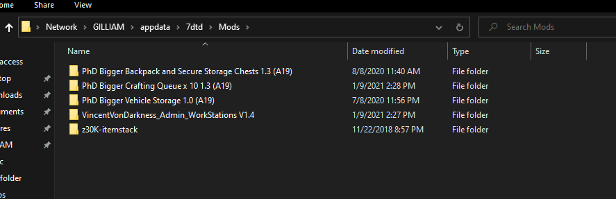

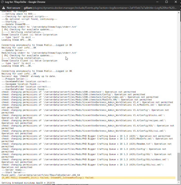

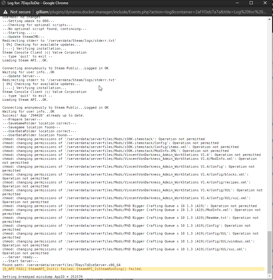

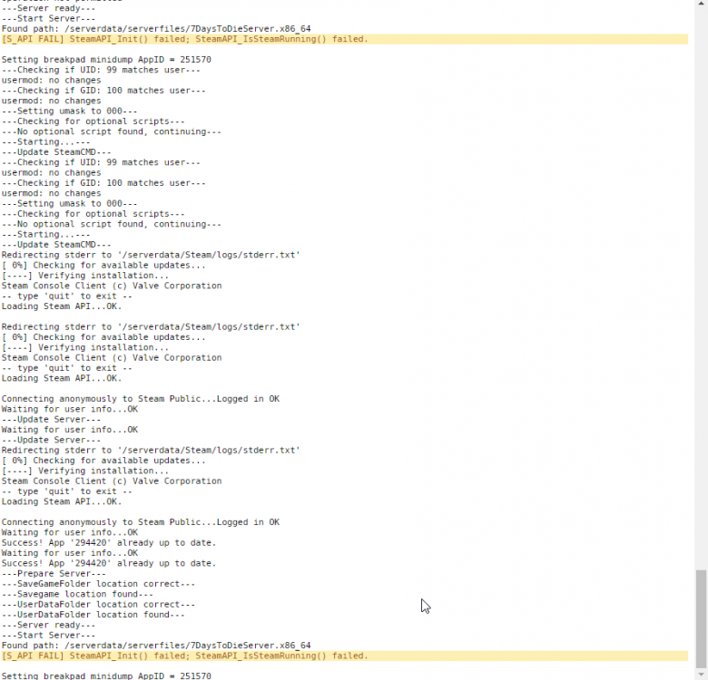

  11. Coooool okay so that got rid of the writing issue however, the mod is still not working. Will try removing all mods and replacing.
  12. Hello, I have an odd issue with my 7 Days To Die server. For some reason some mods are getting a permissions error when trying to apply. So end results is I have some mods that work, but others that do not. These are the mods I've added. The ones that aren't working are the Crafting Queue, 30K Item Stack and vehicle storage is questionable. Here is my container log. Seeing the permissions errors in there, I tried doing a chmod 777 -R /mnt/user/appdata/7dtd/ and a chmod 777 -R /mnt/user/appdata/7dtd/Mods to no result. Any suggestions?
