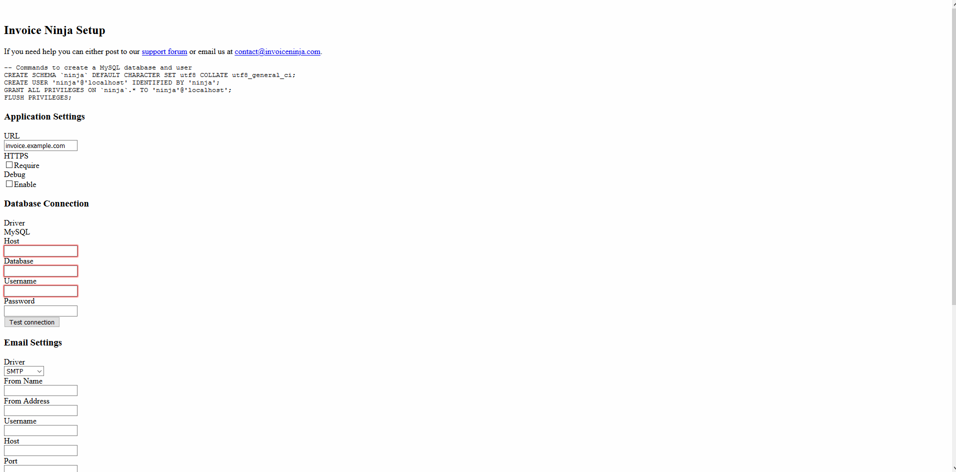

  6. How did you guys managed to make it work? I followed Z3RO's instructions. This is what the page looks like: Any idea?
