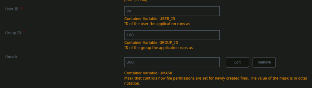

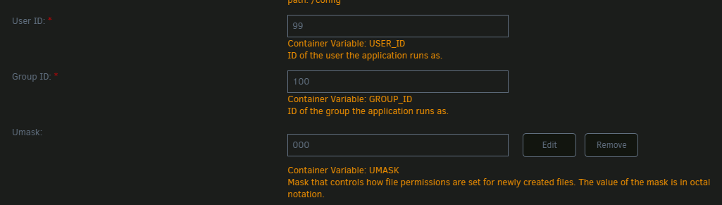

  9. It is under storage and I have set the permissions to the nobody user group. This should be correct, right?
