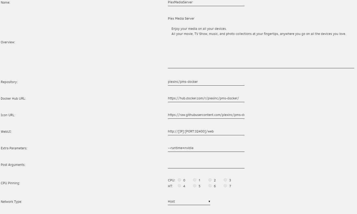

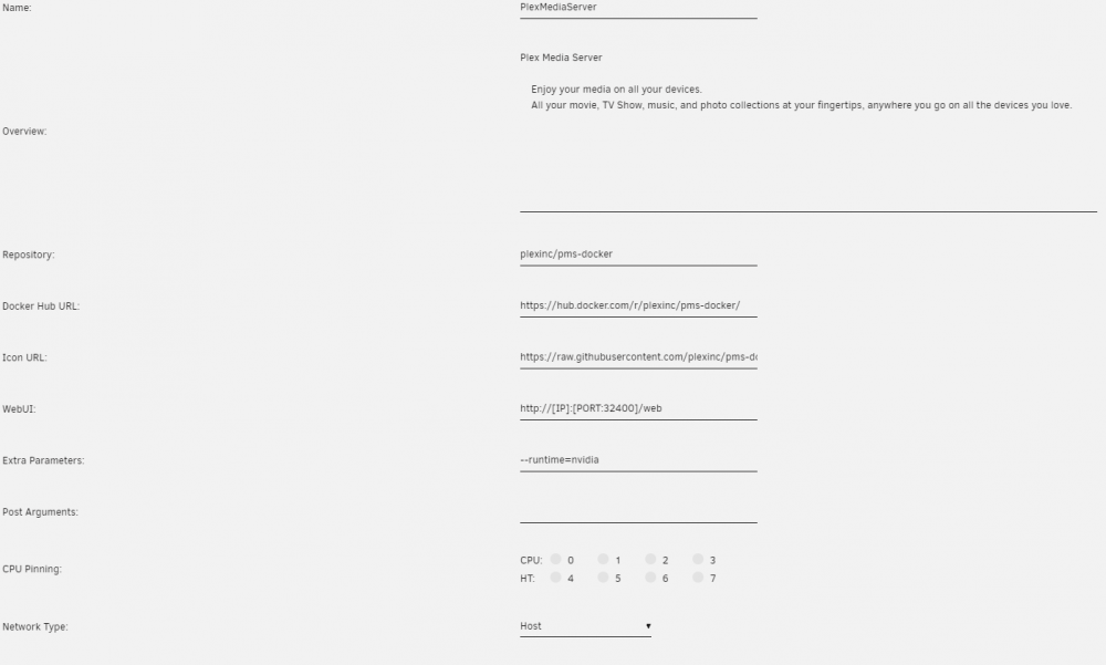

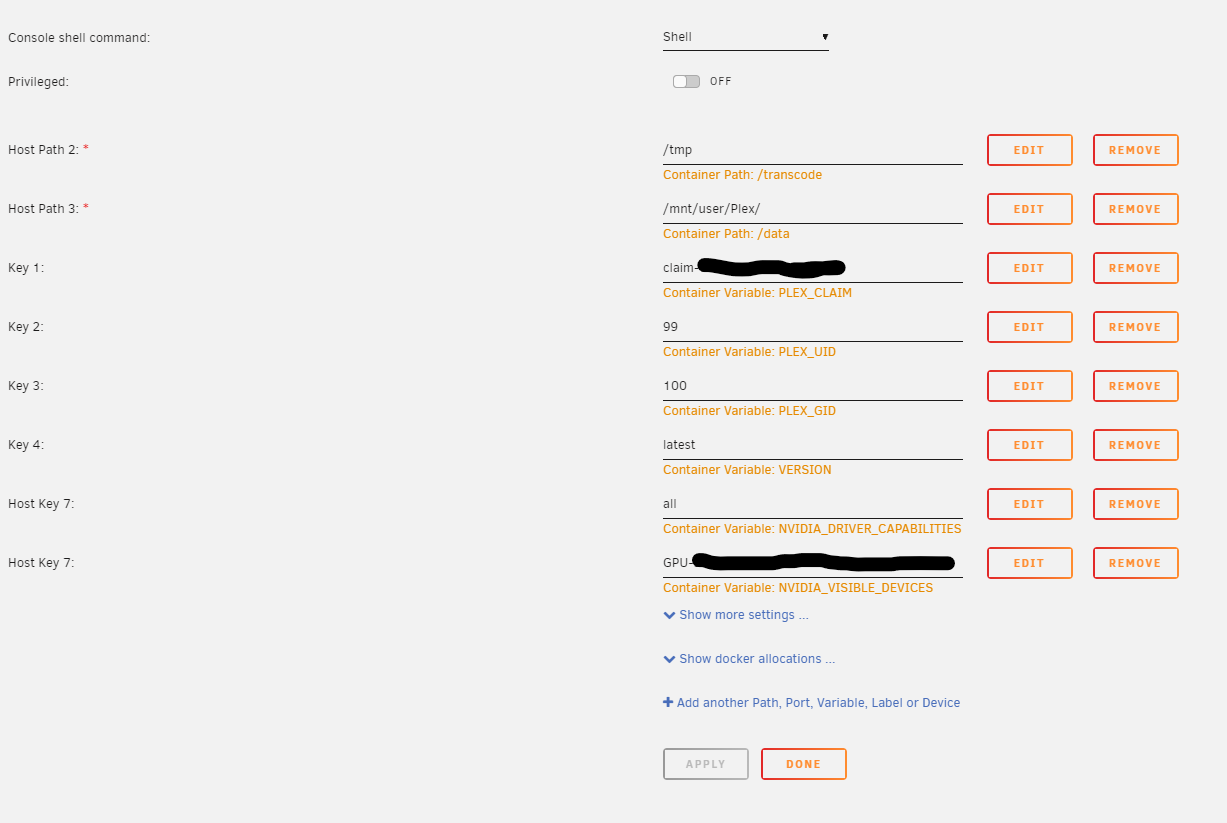

  3. I am also having the same issue. I just updated to 6.12.1. My cache drive has plenty of room. I can't create new docker containers. The Error I receive when installing the docker. docker: Error response from daemon: failed to start shim: symlink /var/lib/docker/containerd/daemon/io.containerd.runtime.v2.task/moby/188f4efc137e795b0291fc2f1f613e04f0bcb7de1933f3da68f6bf8840c45c63 /var/run/docker/containerd/daemon/io.containerd.runtime.v2.task/moby/188f4efc137e795b0291fc2f1f613e04f0bcb7de1933f3da68f6bf8840c45c63/work: no space left on device: unknown. In the unRaid logs it looks like the docker network is blocking a port for some reason. Jun 23 10:41:57 unRaid-Plex kernel: docker0: port 6(veth9051fe0) entered blocking state Jun 23 10:41:57 unRaid-Plex kernel: docker0: port 6(veth9051fe0) entered disabled state Jun 23 10:41:57 unRaid-Plex kernel: device veth9051fe0 entered promiscuous mode Jun 23 10:41:57 unRaid-Plex kernel: docker0: port 6(veth9051fe0) entered disabled state Jun 23 10:41:57 unRaid-Plex kernel: device veth9051fe0 left promiscuous mode Jun 23 10:41:57 unRaid-Plex kernel: docker0: port 6(veth9051fe0) entered disabled state
  4. I have no Plex plugins installed. I've also verified /tmp
