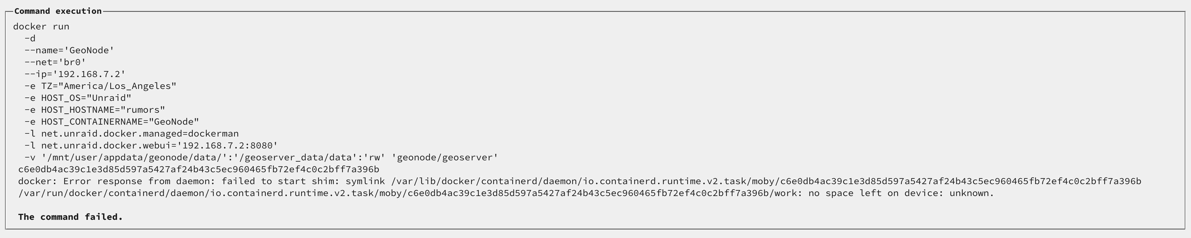

I'm getting the same thing since upgrading to 6.12.1
Upgraded to 6.12.1 and I have the same issue as others here.
docker run
  -d
  --name='freshrss'
  --net='bridge'
  -e TZ="America/Los_Angeles"
  -e HOST_OS="Unraid"
  -e HOST_HOSTNAME="Tower"
  -e HOST_CONTAINERNAME="freshrss"
  -e 'PUID'='99'
  -e 'PGID'='100'
  -e 'UMASK'='022'
  -l net.unraid.docker.webui='http://[IP]:[PORT:80]'
  -l net.unraid.docker.icon='https://raw.githubusercontent.com/linuxserver/docker-templates/master/linuxserver.io/img/freshrss-logo.png'
  -p '8096:80/tcp'
  -v '/mnt/user/appdata/freshrss':'/config':'rw' 'lscr.io/linuxserver/freshrss'
e1f1a6b17997a665637d3ea6732f5792b650383329722f5fd5881c1cb492f2c3
docker: Error response from daemon: failed to start shim: symlink /var/lib/docker/containerd/daemon/io.containerd.runtime.v2.task/moby/e1f1a6b17997a665637d3ea6732f5792b650383329722f5fd5881c1cb492f2c3 /var/run/docker/containerd/daemon/io.containerd.runtime.v2.task/moby/e1f1a6b17997a665637d3ea6732f5792b650383329722f5fd5881c1cb492f2c3/work: no space left on device: unknown.
The command failed.

This sounds like it's the same problem as below - using the Nvidia runtime ends up filling the /run directory. There's a few solutions in that post - I've added '--no-healthcheck' as an extra parameter to the container using the Nvidia runtime and haven't had the issue show up again.
You can check if the mount is full by running: "df -h". If it is full, you can check the problem container with "du /run". The section at the end of the path (after "moby/") is the container id, to find the name of the container run "docker ps -a --no-trunc | grep <CONTAINER ID>".
Hope this helps!
Edited by FestiveKyle
Implemented Option 1 from the thread Kyle linked above. I was able to start my docker containers after running it manually without any need to disable and renable the Docker service. At least there is a temporary workaround now.

Sorry to bring back this old thread, but just wanted to leave my experience here and how I solved it in case others have this problem in the future and find this thread.
My experience was very similar to Vilaran where none of my dockers use Nvidia runtime and the /run folder itself was not showing up as using an excessive amount of storage space. A reboot would also solve the problem for me but after about a week of running the problem returned.
The solution for me ended up being an extremely simple one, but one that didn't give me any direct error or warning in Unraid itself and I only happened to spot it because I checked the system log and saw that my server was constantly printing "shfs: share cache full" to the log.
The problem for me was that the available storage space left on my server was lower than all my shares, and specifically the appdata share used by the Docker containers, "minimum free space" limit. This had been set to a seemingly arbitrary but quite high number, 554.334GB (which is actually really extreme since my ZFS pool is only 4TB large). Once I went through and changed this setting down to 50GB (which might still be a really high number), everything started working again.
I was actually really surprised that this does not cause any kind of notification to appear in the Unraid UI since presumably this could potentially cause a lot of problems if left unremedied?

I didnt put two and two together when i got the "your server has less than 10% left" notification. Your exactly right! This has been such a pain, NO dockers would work nor reinstall
for everyone else: go into the shares Tab, then click on the appdata share, then change this setting. Also this really isnt an issue for most unless you have large drives like myself (24tb drives). 10% of 24tb is really still a ton of space left. This default setting should seriously be reconsidered or at least GIVE US A NOTIFICATION!!!
