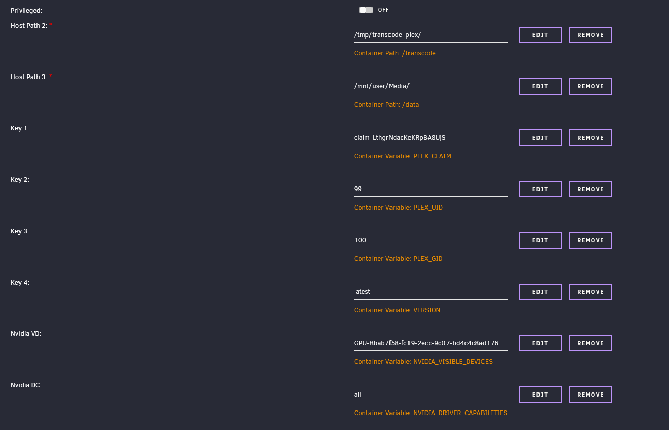

  8. Hi, In the last two weeks, Plex has stopped working for some files. I think its a transcoding issue. I get these errors: [Req#5e2b/Transcode/r7pw9nhy59asswlpgjm37s5q] IsFileWritable: failed to create file '"/transcode/c3a08e2f-6ae3-43cd-ad23-a246f5f31505"' I have attached my settings. I wonder if this is to do with the Host Path 2 I have set up. I thought this was to make it use ram to transcode but perhaps I have done something wrong here. The extra parameters I have are: --runtime=nvidia --no-healthcheck I did get an issue with the nvidia driver when I updated to lasted Unraid OS but this seems to be resolved. Any help would be greatly appreciated!

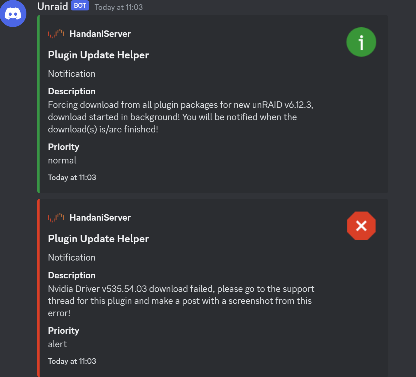

  10. I dont have any adblocking, full access to internet (I think) and nothing blocking Github (I think). At least I have not set those up. First command returns: 6.1.38 Second returns: nvidia-535.54.03-6.1.38-Unraid-1.txz I appreciate all your help, thank you. I need to step out for a few hours so may be slow to reply with next update.
  11. Oh no, I just got notified it failed again.
  12. Thank you! It says finished but nothing has popped up in notifications to say the same. Do you think its safe to reboot? Is there a way I can check whether it completed successfully?
  13. Sorry, I misunderstood! Unraid is v6.11.5. Unraid is now prompting me to reboot to finish the update but the notifications above are saying don't do it because of plugin download error.
  14. Sorry, that would have been helpful, wouldnt it! Current version is 535.54.03. The plugin screen doesn't actually show a newer version. Perhaps I have got confused and there isn't one to upgrade to!
