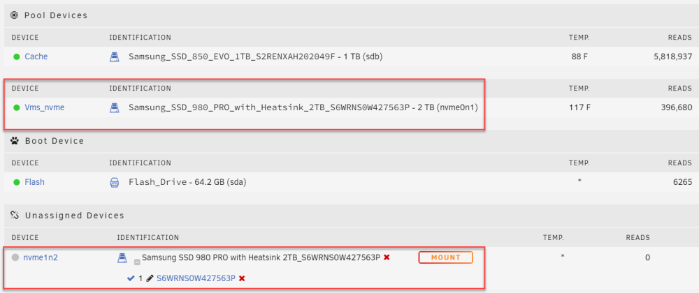

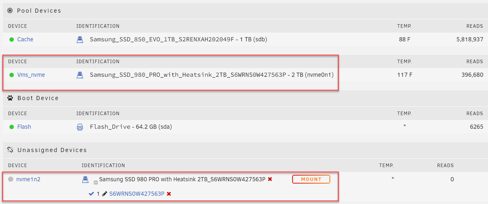

  6. Every once in a while one of my cache drives (in a pool by itself) also shows as an unassigned device. When this happens, nothing on the cache drive is accessible. A reboot fixes it, but any idea what could cause this?
