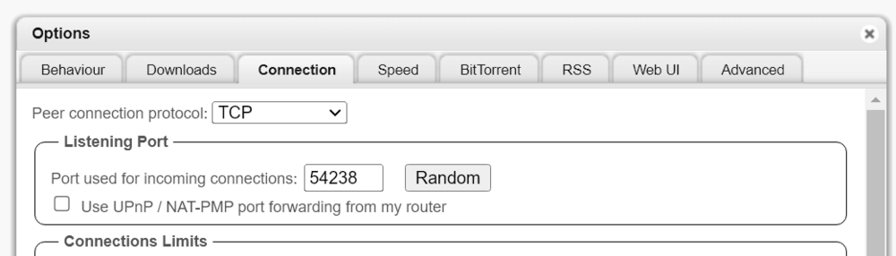

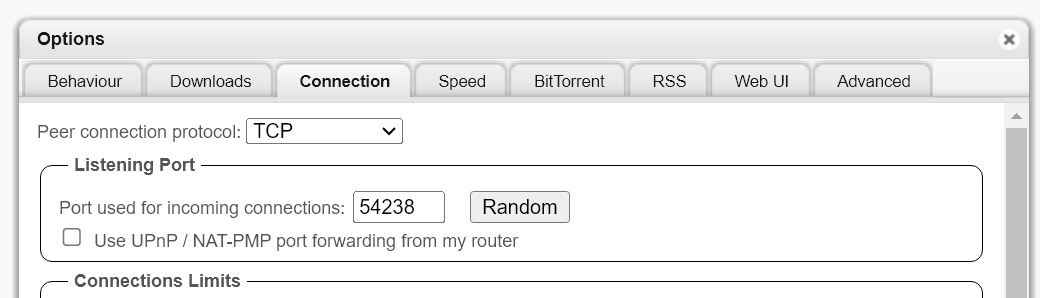

  6. OK that makes sense to me, so for obvious reasons I have to permit outgoing and incoming traffic to the VPN endpoint in order to establish the VPN tunnel in the first place, and thus iptables permit this. qBittorrent is a very chatty Bittorrent client and it will communicate on all adapters by default, including the LAN adapter, and as the VPN endpoints have to be open qBittorrent may (not always) attempt to connect to the VPN endpoint over the LAN, obviously it would fail as the VPN endpoint is not a Bittorrent client. But i hear you cry, can't you simply tie qBittorrent down to use just the tunnel adapter?, well yes you can and i do exactly this by editing the configuration file before qBittorrent starts, but it appears qBittorrent does not always (looks to be random) pick this setting up straight away, leading to this approx. 1 second delay before switching to talk only on the tunnel adapter (as defined in the config file), so i can only assume this is a bug in qBittorrent - it should be reading the configuration and binding to the adapter BEFORE attempting any communication. In any case, this in my opinion is NOT an IP leak, your VPN provider already knows your ISP assigned IP address by this point and obviously a lot more besides, you are not talking to another Bittorrent client so there has been no peer to peer communication taking place and thus the risk is extremely low (in my opinion it's zero).
