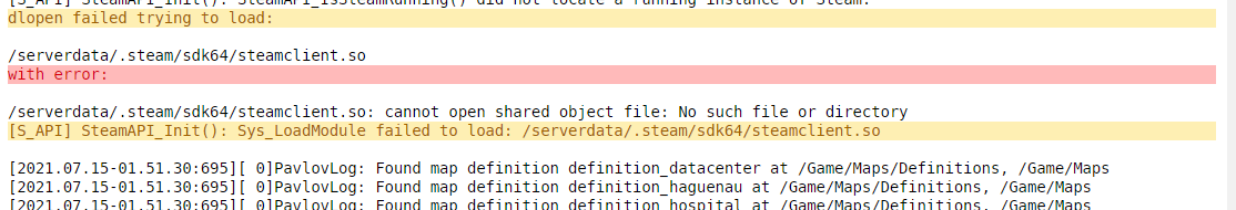

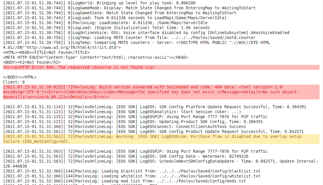

  6. Any chance I can get a hand in setting up a Pavlov VR server? I thought I had it all set up correctly but apparently not. I can see my server in the server list within the game but it has a 999 ping and times out when I try to join. I am not familiar with SteamCMD, nor would I consider myself advanced in linux.\ I attached 2 snaps of my logs. Maybe they would shed some light on the issue. Not sure myself.
