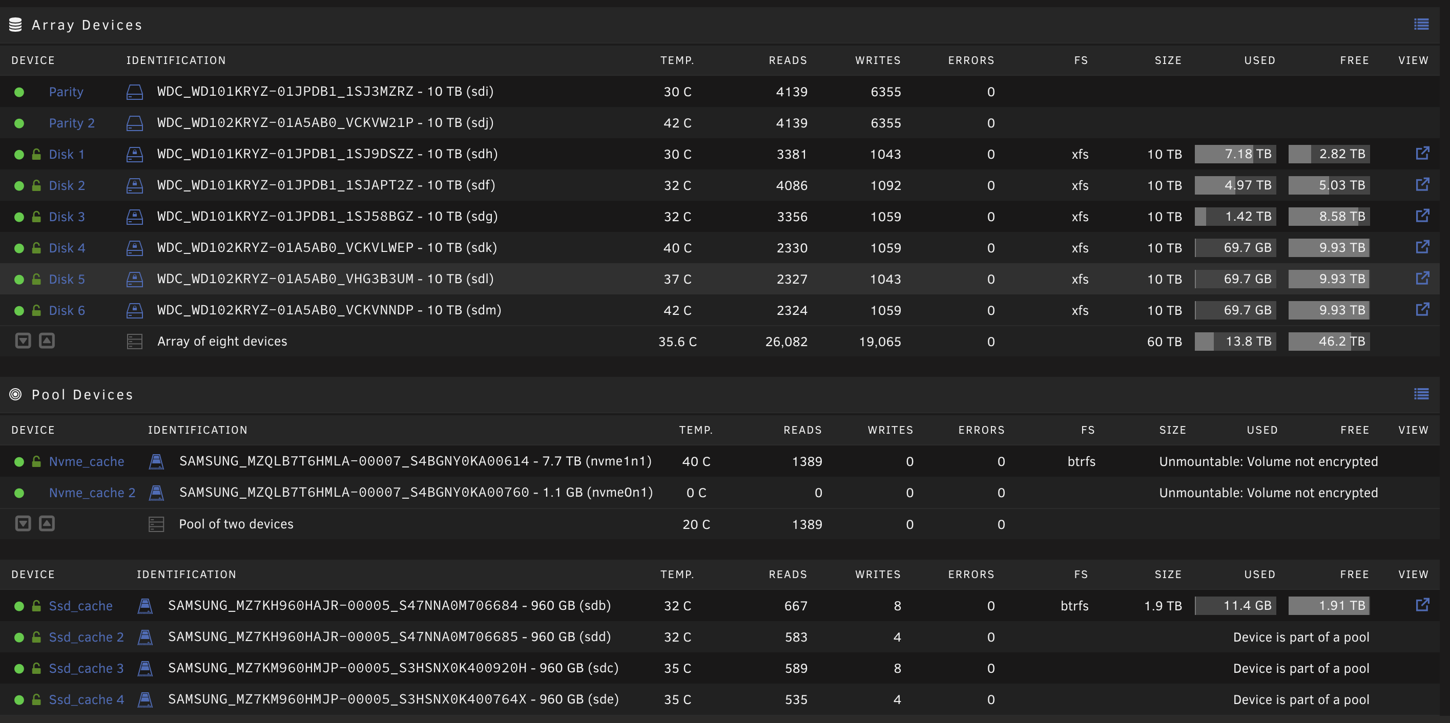

  8. Thanks for the quick response. Just to confirm the next steps, I should just physically replace the dead NVME drive with a new one. Assign that new one to the slot of the dead one and start the array back up. BTRFS will then repair the raid 1 and the cache should be good to go?
  9. One of the drives in my cache pool suddenly died, thankful it was a raid 1 and I was able to recover the data to a folder on my array following these instructions. Now that I have the data on the array in a temp folder how can I get the cache recovered or get the data into the right spots in the array? Should I just be copying the data to the array backed shared location for each area? Such as /cache/sharefolder/files -> /array/temp/files -> /array/sharefolder/files? or once I replace the broken drive should I just take the files from the temp directory and put them back on the cache. leaf-diagnostics-20221103-1905.zip
