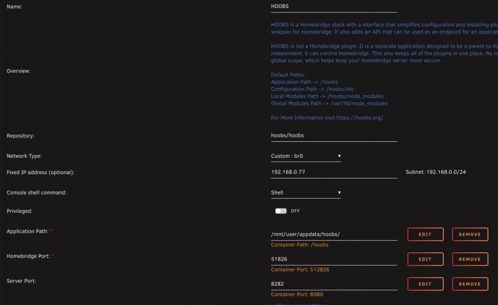

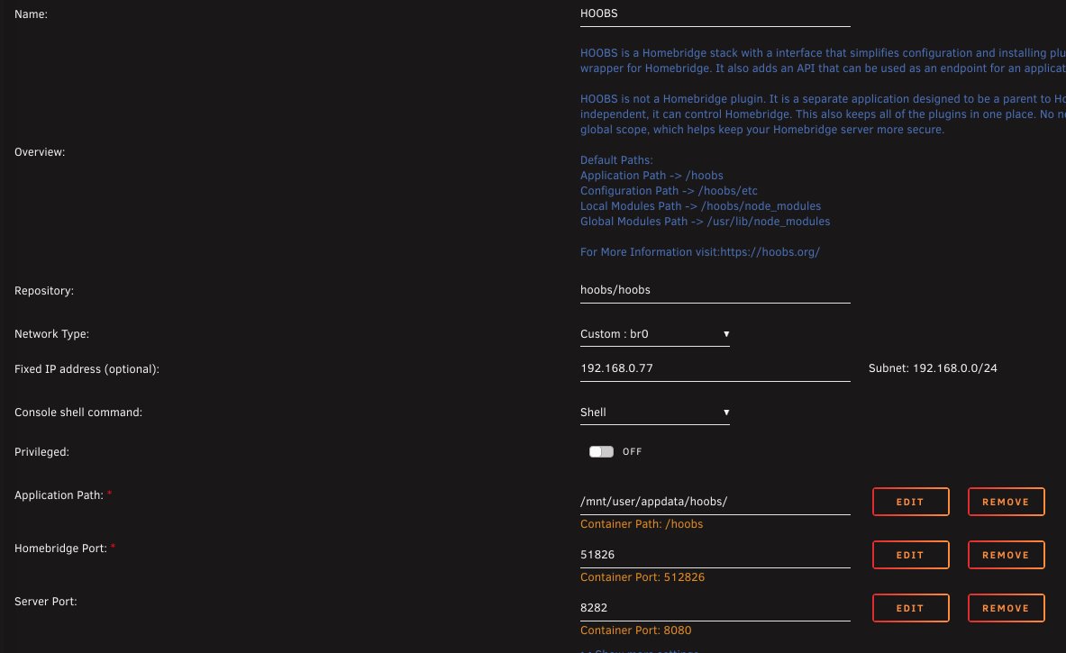

Ran Hoobs for ages on a raspberry pi and wanting to set up the Hoobs docker.
Install goes fine and the docker is running according to the log and using the default homebridge and server ports in the config 51826 and 8282 but I cannot access the webui. I noticed that the container ports shown in the config are the standard homebridge ports. I've tried to change the ports to these container ports to no avail.
Am I doing something wrong?

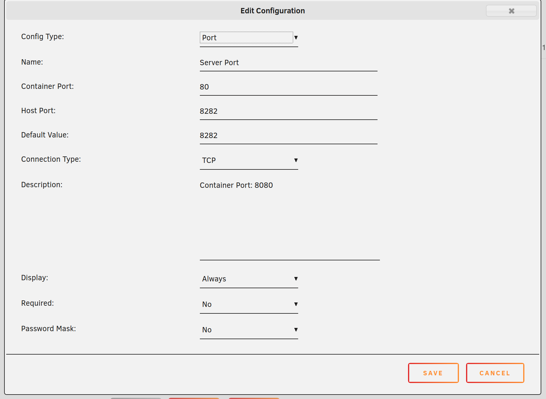

you cant get to the web interface because the default web port for the container is pointed at 8282 but the webserver is running on port 80.  Edit the server port setting to look like mine below. Thats how I fixed mine, seems to be a misconfiguration in the unraid docker template
It wont let me change the container port like you were able to do.  Is there some advanced edit mode I need to be in?
