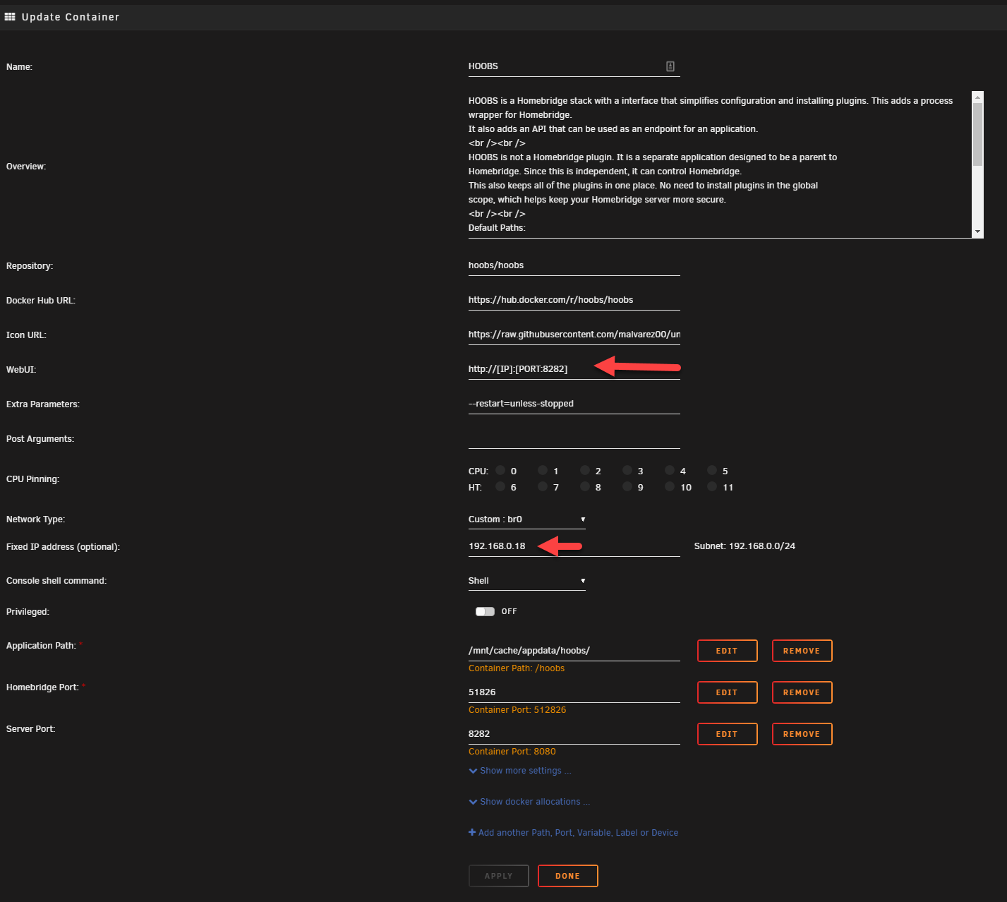

I can see the new fixed IP for the docker on my router UDM
But I can not access the docker UI? (I set the port to 8282)
I dont know if its the docker(Hoobs or its my Unraid setup with Br0?

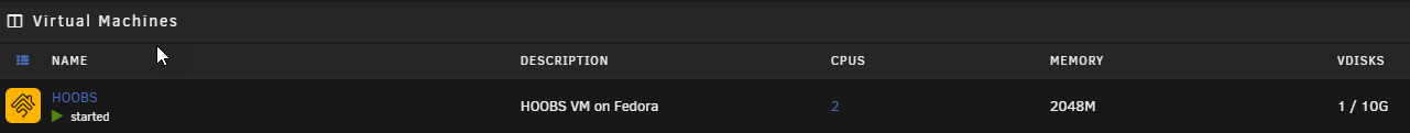

Wow this is really fast and better scaling than the Docker (More Icons on the web UI) and fixed IP is easy since it now has a MAC and I can just do a DHCP reservation for this (I spend all night trying to get the docker working) and it took 10 min to create the VM

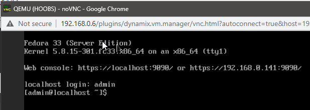

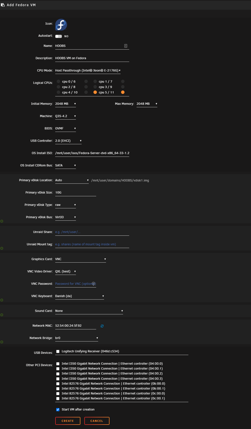

For anyone else who wants to try this in a VM instead of Docker on Unraid:
Download Fedora ISO:
Fedora-Server-dvd-x86_64-33-1.2.iso
Install Fedora on Unraid as VM: (I need to update the icon for HOOBS 🙂 )
Click create and go to your VNC

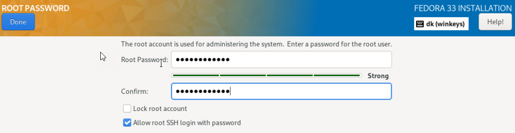

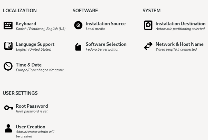

Fill out everything ("X" SSH)
Install and wait
Instruction after this is Copy paste from here LINK

On 6/11/2020 at 9:12 PM, Bondfire said:
It wont let me change the container port like you were able to do.  Is there some advanced edit mode I need to be in?
I couldn't too. So I created another one, and deleted the current one.
And there is another typo with the description of the home bridge port "51826 >> 512826" but it's not blocking.
Plus the one with the WebGUI that someone talked about. It makes me think the author couldn't care less about the community.

@casperse Hello, yes you need an IP in the same network than your devices.
It is usually "easy" to setup (have to choose "Custom: Br0" and define an ip), but I couldn't make it work with this image. So I dropped it and I installed the official docker image hoobs/hoobs. I could add the bridge to my House app of Apple !
