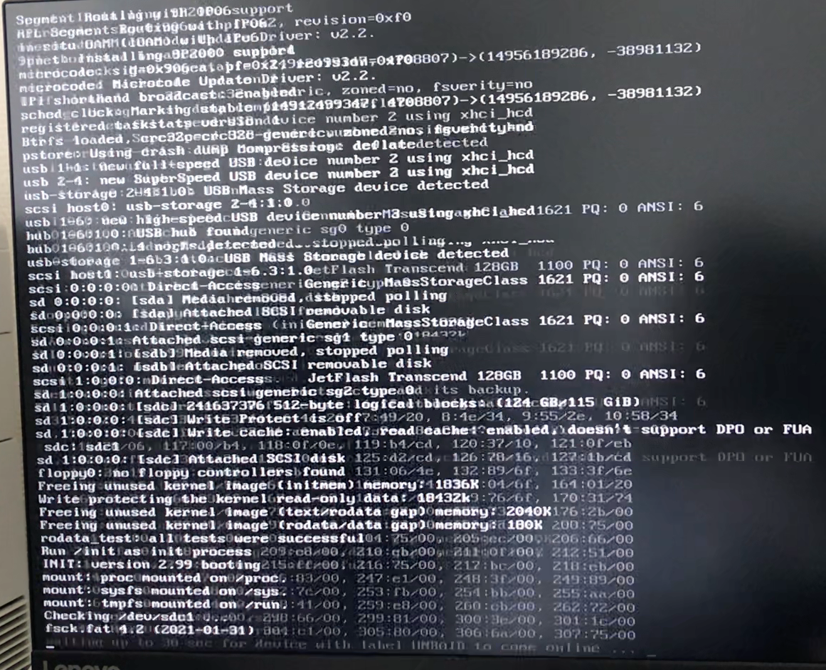

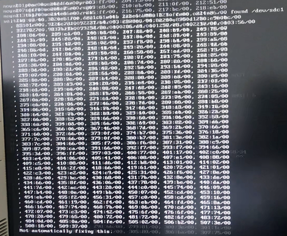

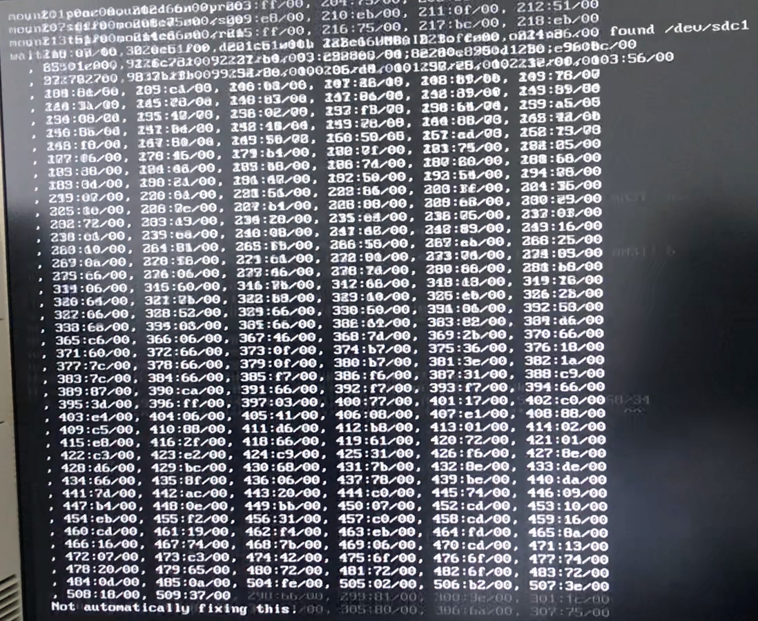

  4. I have checked the syslog (was already recording it) and there's nothing out of the ordinary there. The messages I see in the display with the pictures posted earlier do not appear in the syslog which means syslog is not started at that point yet. As of today things have taken a turn for the worse. Now it randomly reboots, one of the drives got disabled and marked for errors (it is currently being emulated). Taking the machine offline is not much of an option right now. Running check/fix is impossible as it just reboots the system. Running SMART short tests all drives appear to be fine (extended SMART cannot run as it reboots before they are finished). Currently waiting for the easter days to pass so I can get a new PSU delivered to test it out. If things continue down that path I am considering installing truenas on the same hardware (just different drives) out of curiosity to verify if it is hardware or software related. In the meantime, any ideas are welcome. fingers crossed

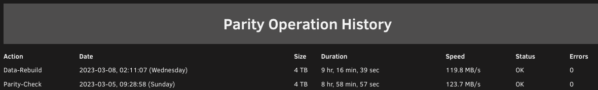

  5. I video recorded the display, booting on normal mode and safe mode, I get the following. Sorry for the poor quality but it's moving really fast, it's the best the camera could capture. It has been running parity checks and even a rebuild recently with the exact same configuration for ever a year. Here are the two last ones, not long ago. Any clues?

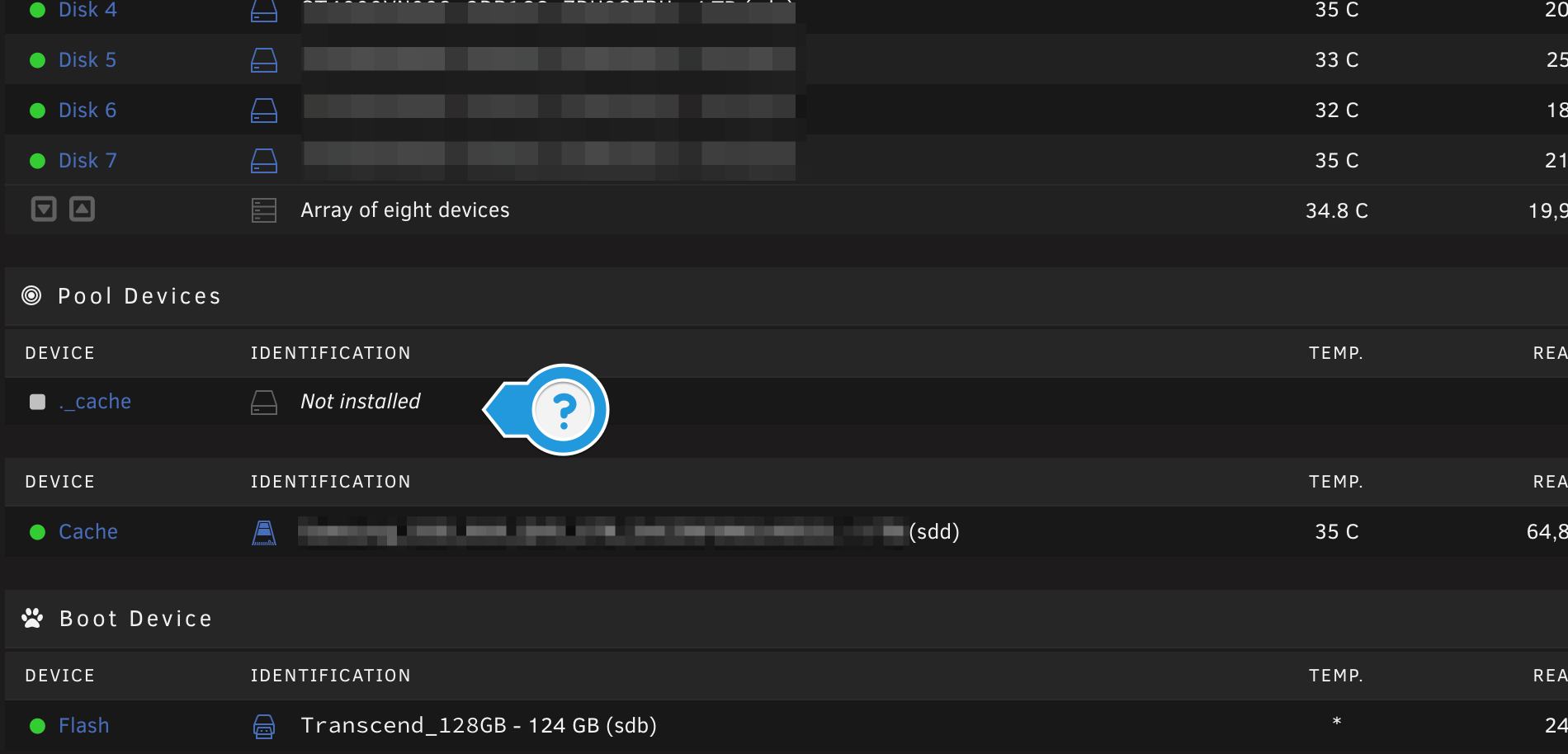

  10. Short story On the server there are currently 2 USB devices attached. The Unraid stick and an SD-CARD reader with a card inside. Upgrade succeeded but device was no longer bootable. Upgrading with ONLY the usb stick present it worked fine. Artifacts After the upgrade I now have the following device listed and no way of removing it. My cache drive appears to be all in order and properly listed. Is this something I should worry about? How can I remove it? The Odyssey New upgrade out. Checking the change log, I read about fixes with regard to data corruption so must have upgrade ASAP. But first things first... fresh Flash Backup... (seriously, NEVER ever skip that step. IMO it should be part of the upgrade process - please guys seriously consider adding it in the upgrade work flow). I click upgrade... downloads upgrade, installs it and asks to reboot. Flawless... ok, reboot. 10 minutes later... unraid nowhere to be seen in the network... searching for that bloody HDMI or DP cable (how I miss having a KVM)... after a looong search, I found one I could use. Latest messages on the terminal, boot device failed trying again click a button to reboot... Ok, let's recover using the back-up (never ever ever upgrade without a backup). Downloading the creator (mac)..., plugging in the Unraid stick... no USB stick listed. I click refresh, nothing. I must be doing something wrong... onward to the wiki. In the documentation it says USB stick size MAX 32GB (NOT TRUE). Really? I've been using the 128GB stick for years now... damn, might have something changed and it's now an issue? Taking out another stick 32GB max size, formatting FAT32, loading the creator, refresh... nothing. No stick listed... OK, so USB creator broken on mac... onward to Win10... all steps repeated... NO STICK LISTED (you can only get away with such things because most users are experienced, but seriously, even the open source apps copy-files-and-make-stick-bootable can always find the usb stick). Ok, so creator is broken (btw, was also broken years ago when I first purchased the unraid license). I'm thinking, it's UEFI, just copy the bloody files over and run the make_bootable_mac should do it. So I copy the files, open terminal, run the make_bootable_mac... will not run, unknown developer and the such... oook, preferences, allow... again... another binary that it tries to run same issue... same process, again... and another binary, same issue same process... DONE! All messages look ok except for that cannot get current directory (multiple times). ❯ ./make_bootable_mac INFO: make_bootable_mac v1.3 INFO: The following drive appears to be the unRAID USB Flash drive: /dev/disk2 123.7GB Permit UEFI boot mode [Y/N]: Y To continue please enter your admin Password: Sorry, try again. Password: INFO: Unmounting /dev/disk2 Forced unmount of all volumes on disk2 was successful INFO: Writing MBR on /dev/disk2 0+1 records in 0+1 records out 447 bytes transferred in 0.004785 secs (93417 bytes/sec) INFO: Mounting /dev/disk2 Volume(s) mounted successfully syslinux for Mac OS X; created by Geza Kovacs for UNetbootin unetbootin.sf.net shell-init: error retrieving current directory: getcwd: cannot access parent directories: No such file or directory "/dev/disk2s1" unmounted successfully. shell-init: error retrieving current directory: getcwd: cannot access parent directories: No such file or directory /dev/disk2s1 DOS_FAT_32 /Volumes/UNRAID shell-init: error retrieving current directory: getcwd: cannot access parent directories: No such file or directory mountpoint is '/Volumes/UNRAID' checkpoint1 checkpoint2 checkpoint3 Processing: /Volumes/UNRAID/ldlinux.sys checkpoint4 checkpoint5 checkpoint6 checkpoint7 Processing: /Volumes/UNRAID/ldlinux.c32 checkpoint8 checkpoint9 checkpoint10 shell-init: error retrieving current directory: getcwd: cannot access parent directories: No such file or directory "/dev/disk2s1" unmounted successfully. checkpoint11 checkpoint12 checkpoint13 checkpoint14 checkpoint15 shell-init: error retrieving current directory: getcwd: cannot access parent directories: No such file or directory /dev/disk2s1 DOS_FAT_32 /Volumes/UNRAID syslinux installed successfully! INFO: the Unraid OS USB Flash drive is now bootable and may be ejected. Stick back to the NAS, booting... no luck, same errors 😰 Last try, stick to a windows machine, run the make_bootable.bat.... just a single line saying it's done. Stick back to the NAS, booting... YAY. But I REALLY want the upgrade... there are only 2 USB devices on the machine. Let's remove the SD-CARD reader... maybe something got it confused? 🤔 Upgrade... reboot... success! YAY! btw, It feels embarrassing that windows make_bootable worked when the mac one was failing.
