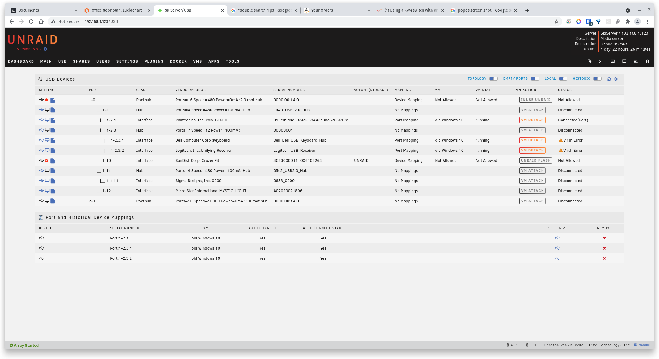

  9. Still seeing a few messages in the logs. I also ran into some issues this morning that seemed to be associated with the built-in hub of a dell keyboard. USB manager really did not like the hub, especially if I plugged the mouse into it. When I connected the mouse directly to the KVM switch, USB Manager was much happier. Here's the latest log with a few errors in it -- not sure if these are anything to be concerned about: Jan 5 11:39:37 SkiServer kernel: usb 1-2: USB disconnect, device number 103 Jan 5 11:39:37 SkiServer kernel: usb 1-2.1: USB disconnect, device number 104 Jan 5 11:39:37 SkiServer acpid: input device has been disconnected, fd 9 Jan 5 11:39:37 SkiServer kernel: usb 1-2.2: USB disconnect, device number 105 Jan 5 11:39:37 SkiServer kernel: usb 1-2.2.2: USB disconnect, device number 107 Jan 5 11:39:37 SkiServer kernel: usb 1-2.2.4: USB disconnect, device number 109 Jan 5 11:39:37 SkiServer kernel: usb 1-2.3: USB disconnect, device number 106 Jan 5 11:39:37 SkiServer kernel: usb 1-2.3.1: USB disconnect, device number 108 Jan 5 11:39:37 SkiServer usb_manager: Info: rc.usb_manager usb_remove /dev/bus/usb/001/109 001 109 Jan 5 11:39:37 SkiServer usb_manager: Info: rc.usb_manager Device Match 046d_HD_Pro_Webcam_C920_F1F9C06F vm: Mark Windows 10 001 109 Jan 5 11:39:37 SkiServer usb_manager: Info: rc.usb_manager usb_remove /dev/bus/usb/001/108 001 108 Jan 5 11:39:37 SkiServer usb_manager: Info: rc.usb_manager Device Match Logitech_USB_Receiver vm: Mark Windows 10 001 108 Jan 5 11:39:37 SkiServer usb_manager: Info: rc.usb_manager usb_remove /dev/bus/usb/001/104 001 104 Jan 5 11:39:37 SkiServer usb_manager: Info: rc.usb_manager usb_remove /dev/bus/usb/001/107 001 107 Jan 5 11:39:37 SkiServer usb_manager: Info: rc.usb_manager Device Match C-Media_Electronics_Inc._USB_Audio_Device vm: Mark Windows 10 001 107 Jan 5 11:39:37 SkiServer usb_manager: usb_manager virsh called Mark Windows 10 1 109 Device detached successfully Jan 5 11:39:37 SkiServer usb_manager: Info: rc.usb_manager Disconnect 046d_HD_Pro_Webcam_C920_F1F9C06F vm: Mark Windows 10 running 001 109 Jan 5 11:39:37 SkiServer usb_manager: Info: rc.usb_manager Removed 046d_HD_Pro_Webcam_C920_F1F9C06F vm: Mark Windows 10 running 001 109 Jan 5 11:39:37 SkiServer usb_manager: usb_manager virsh called Mark Windows 10 1 108 Device detached successfully Jan 5 11:39:37 SkiServer usb_manager: Info: rc.usb_manager Disconnect Logitech_USB_Receiver vm: Mark Windows 10 running 001 108 Jan 5 11:39:37 SkiServer usb_manager: Info: rc.usb_manager Removed Logitech_USB_Receiver vm: Mark Windows 10 running 001 108 Jan 5 11:39:37 SkiServer usb_manager: usb_manager virsh called Mark Windows 10 1 107 error: Failed to open file '/tmp/libvirthotplugusbbybusMark Windows 10.xml': No such file or directory Jan 5 11:39:37 SkiServer usb_manager: Info: rc.usb_manager Disconnect C-Media_Electronics_Inc._USB_Audio_Device vm: Mark Windows 10 running 001 107 Jan 5 11:39:37 SkiServer usb_manager: Info: rc.usb_manager Removed C-Media_Electronics_Inc._USB_Audio_Device vm: Mark Windows 10 running 001 107 Jan 5 11:39:37 SkiServer usb_manager: Info: rc.usb_manager usb_remove /dev/bus/usb/001/106 001 106 Jan 5 11:39:37 SkiServer usb_manager: Info: rc.usb_manager Device Match ASIX_Electronics_AX68004_00000001 vm: 001 106 Jan 5 11:39:37 SkiServer usb_manager: Info: rc.usb_manager usb_remove /dev/bus/usb/001/105 001 105 Jan 5 11:39:37 SkiServer usb_manager: usb_manager virsh called 1 106 error: Failed to get option 'domain': Option argument is empty Jan 5 11:39:37 SkiServer usb_manager: Info: rc.usb_manager Disconnect ASIX_Electronics_AX68004_00000001 vm: nostate 001 106 Jan 5 11:39:37 SkiServer usb_manager: Info: rc.usb_manager Removed ASIX_Electronics_AX68004_00000001 vm: nostate 001 106 Jan 5 11:39:37 SkiServer usb_manager: Info: rc.usb_manager usb_remove /dev/bus/usb/001/103 001 103 Jan 5 11:39:37 SkiServer usb_manager: Info: rc.usb_manager Device Match 1a40_USB_2.0_Hub vm: 001 103 Jan 5 11:39:37 SkiServer usb_manager: usb_manager virsh called 1 103 error: Failed to get option 'domain': Option argument is empty Jan 5 11:39:37 SkiServer usb_manager: Info: rc.usb_manager Disconnect 1a40_USB_2.0_Hub vm: nostate 001 103 Jan 5 11:39:37 SkiServer usb_manager: Info: rc.usb_manager Removed 1a40_USB_2.0_Hub vm: nostate 001 103
  10. Seems to be working now, Simon -- thanks. I had to manually go into the VM xml interface to clean out all the residue of USB mappings. Once I configured USB Manager, i had to restart the VM. After doing that, for the first time I successfully switched from the VM to the laptop and back again with no hangs. Mark

  14. Alas, using the USBIP plugin does not immediately solve the problem. But does seem to give a hint what the problem is. See the attached screen shot. Note the error reported for both the keyboard and mouse. Who might I report this to??
