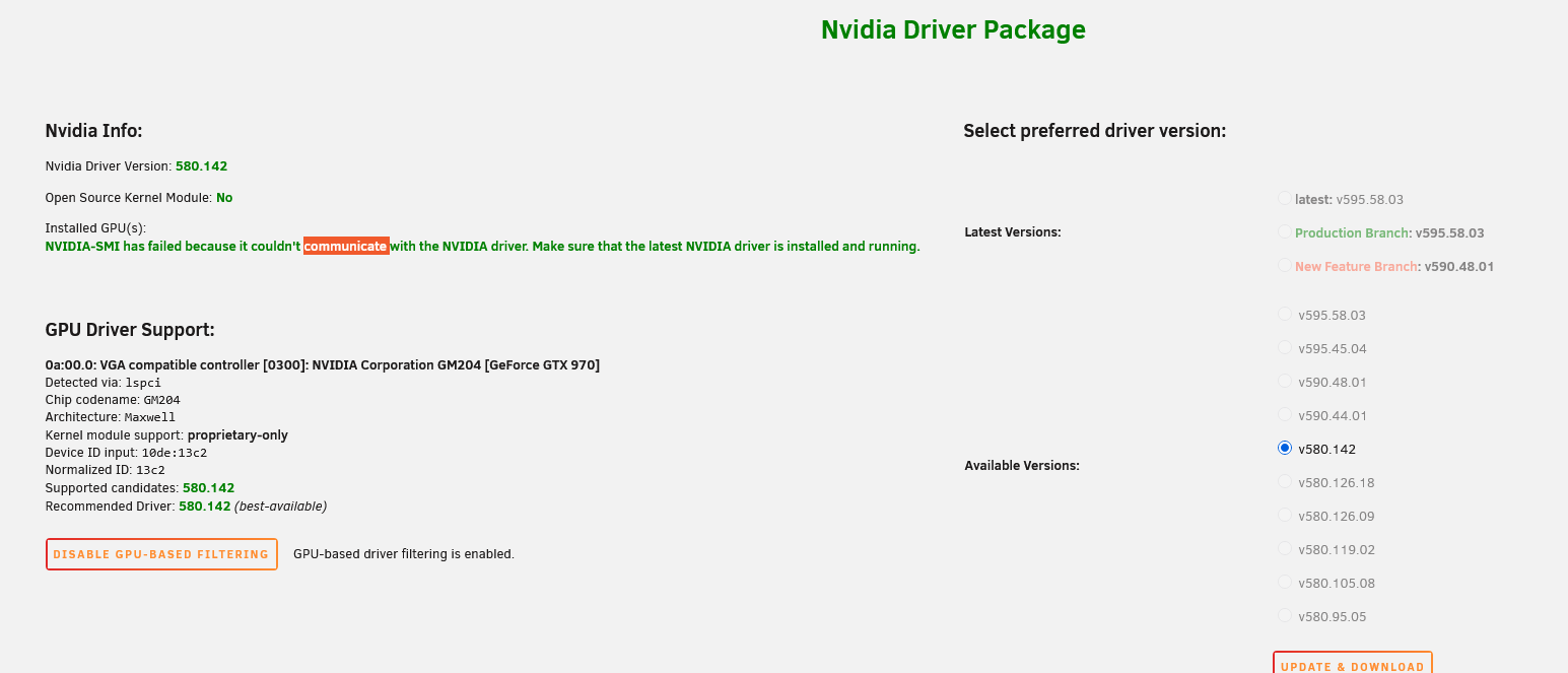

  3. I have started a second Unraid server and installed a Nvidia GTX 970 in it. I am getting an error nvidia-smi not able to communicate. I have tried several of the troubleshooting ideas that are listed in this topic. Anybody have any ideas. I have tried moving the driver versions, uninstalled and reinstalled the plugin. This is in a Dell T320. I also have a Dell 720 with a GTX 1080. In the Dell 720 the plugin does not recognize the integrated video card but in the T320 it does.

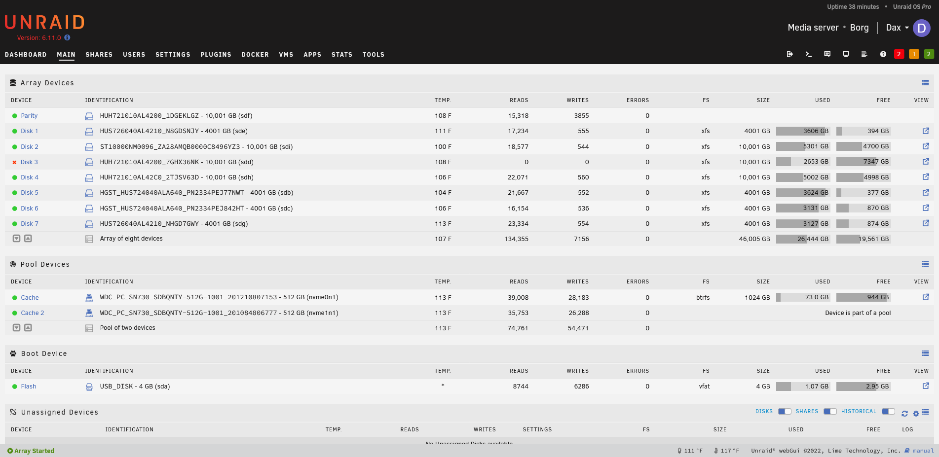

  5. I thought I would try adding it back in but it failed like last time and has paused at 98.8 percent. Here is the current diags. borg-diagnostics-20221005-1832.zip
  6. Yea I meant enable. Here is the diag zip file. borg-diagnostics-20221005-0152.zip

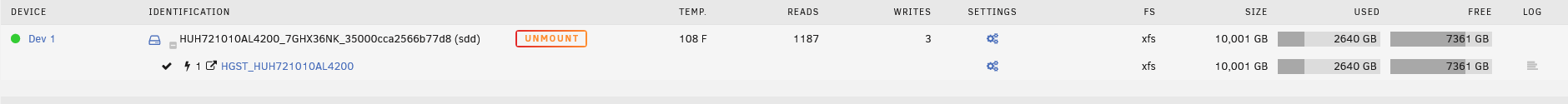

  7. I apologize maybe I should have said enabled since the red x said disabled and that the contents have been emulated. I am replacing a old drive with this one. I would like to eventually add a second parity drive. The diagnostic zip is big what files from it would be helpful. The one that sticks out to me is the smart folder and the syslog. The disk I replaced said Disk Dsbl. 35000cca2566b77d8-20221004-1431 disk3 (sdd) - DISK_DSBL.txt syslog.txt
  8. I unmounted the drive and added it in as an unassigned drive. It spins up.
  9. I have added an extra 10TB drive to my system. Unraid recognized it and show it but will not allow it to spin up. Has anybody had this issue. The system did run through the data rebuild. I have attached a few logs. If a different log is needed just let me know. smart errors.txt sys log.txt 35000cca2566b77d8-20221004-1431 disk3 (sdd) - DISK_DSBL.txt
