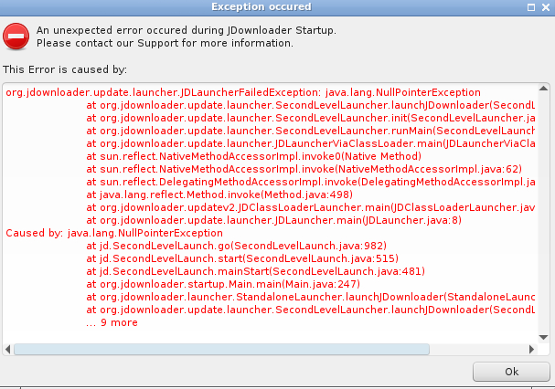

  1. "It's working again, I didn't do anything, just below the error, a message appeared to search for updates, and then it started working again."
  2. I have the same mistake as dollorianes. My Unraid Version is 6.11.5
