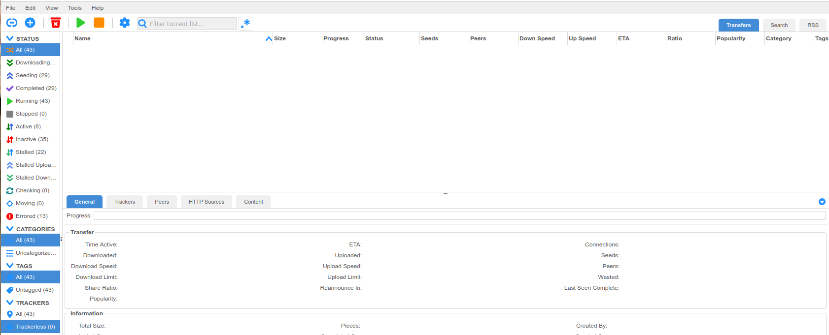

  2. Looks like the latest update broke something. None of my torrents are showing in the webUI. The torrents are there when I add them, they download, but they aren't in the main pain. The left hand pane shows the correct numbers.
  3. that fixed it. Much appreciated.
